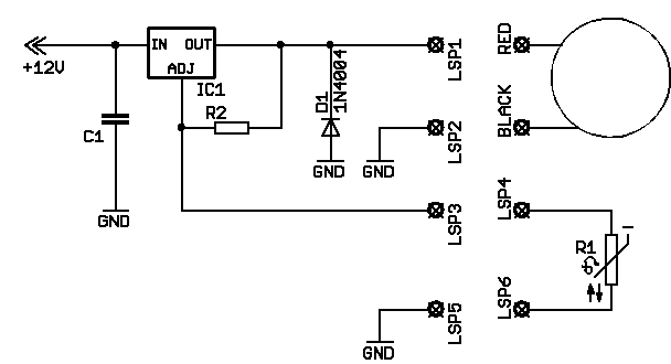

It is very easy to make a thermostatic fan controller, that varies fan speed with temperature. You need a LM317 regulator and 4 passive components, a resistor, a NTC thermistor, a diode and a cap. I'll post the layout later if anyone is interested.

After being reminded gently, here's the simple circuit you need.
C1 should be about 0.1uF, value not really critical, D1 should be 1n4001.
To calculate R2, just measure the resistance of your thermistor at room temperature, and R2 should be around half that.
With the thermistor in that position, it needs to be a positive TC, not the NTC shown, or the fan will slow down as the thermistor warms up. And suitable PTC thermistors seem hard to find.
Using an NTC but swapping it over to R2 position, the 317 doesn't seem a good chip for the job - the L200 regulator with its higher multiplier in the output voltage formula
Vo = 2.77(1 + R/Rth)
gives a better response.
