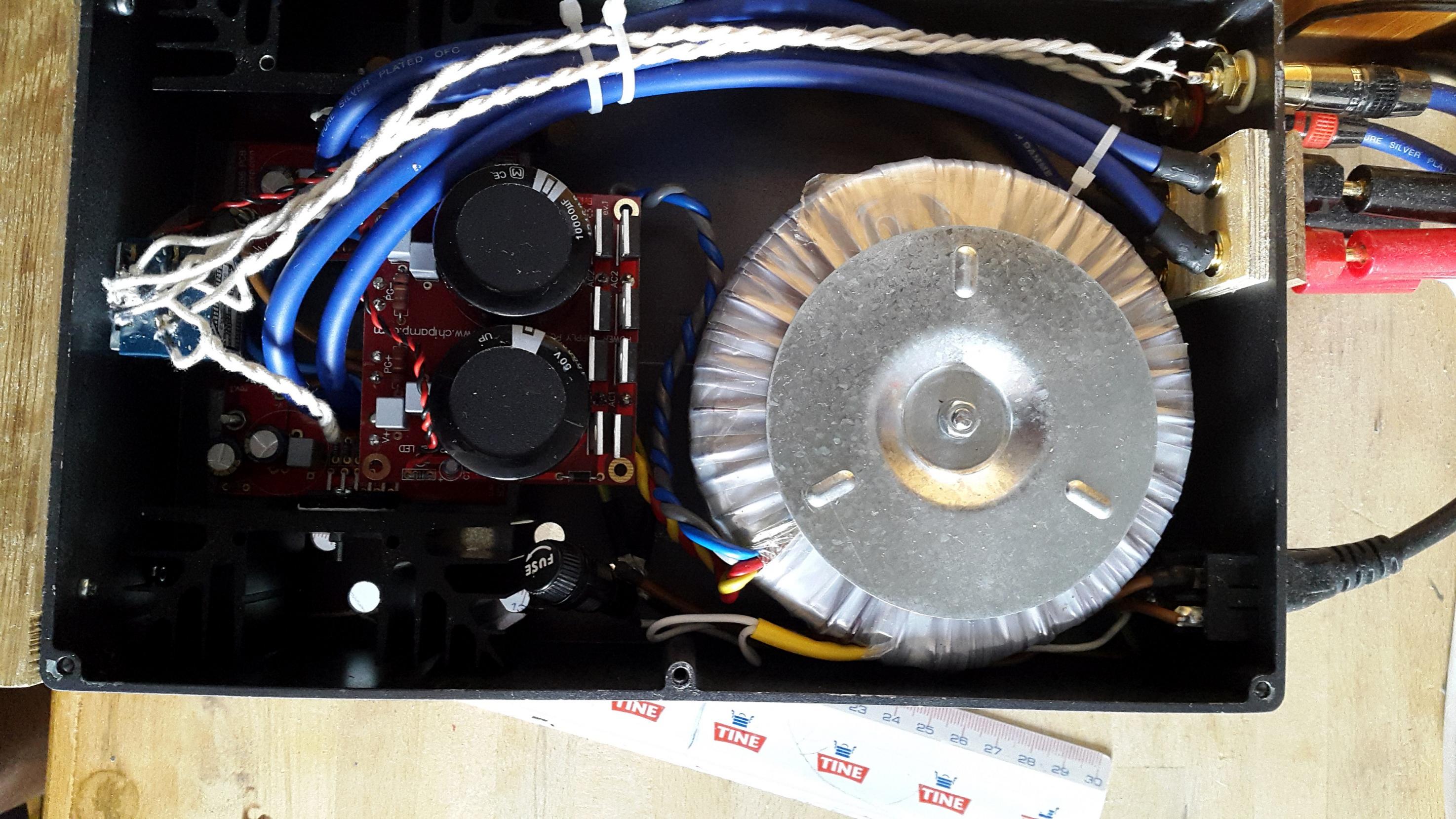

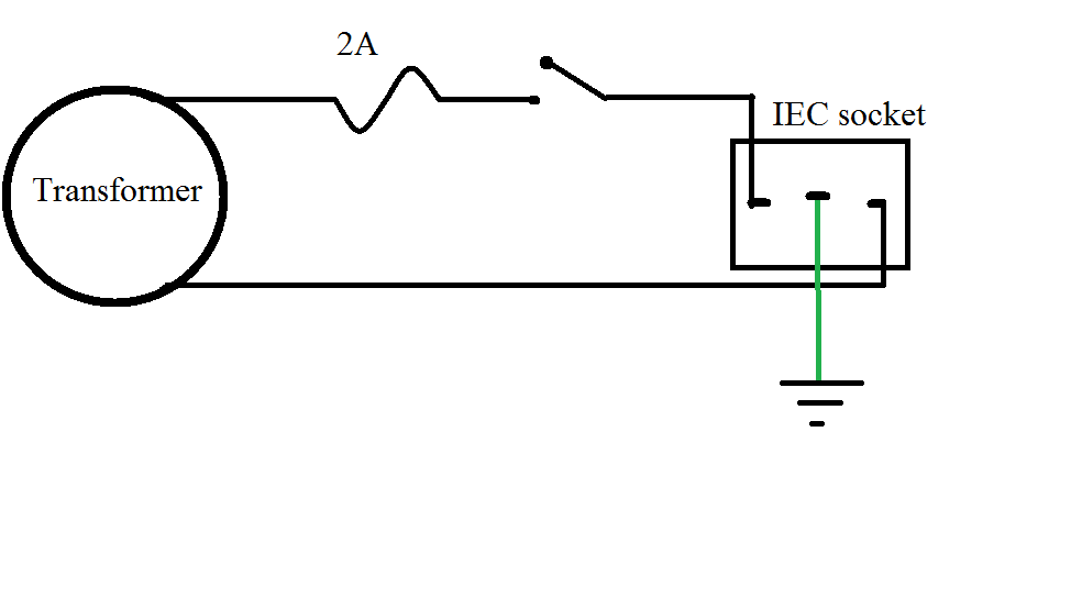

Hello! Have had a problem with my lm3886 chip amp since I built it. The problem is just that the fuse (2A) blows instantly when turning on the amp. But this just happens like every 15 times I use it. Thats why it is so weird. And the fuse for the amplifier is not the only one that blows. My house's fuse box also blows for the floor where the amp is placed. Adding a drawing of the the circuit before the transformer, and a picture of the amplifier for you to see.

Perhaps there are two different problems going on...
With a 2 Amp fuse, you shouldn't blow the house fuse, unless the circuit is so loaded to near the limit that the starting surge for the amp puts the house fuse over the limit. Of course, there might be something even worse going on, which is a little scary, so please be careful.
As to the 2 Amp-fuse itself blowing every 15 times...What timing is the fuse?
A fast blow fuse will typically have the problem you cite...the issue is charging the capacitors, and the phase of the AC line when you turn on the power.
Medium or Slow blow fuses are probably more appropriate for this fuse position.

A 500VA transformer fed from 220Vac needs a T6A fuse if you start it directly on line.
If you use a soft start you can use a T2A fuse. The soft start will need a resistance of aprox 50r and that will need to be bypassed after about 100ms to 300ms

A 5-6 A slow-blow fuse may solve the problem with the fuse within the amp blowing, but it will do nothing to address the house fuse blowing.
It's rather surprising that the house fuse blows, actually. Usually they can withstand 100 % overload for over an hour. If the circuit is already heavily loaded, the inrush of the transformer may be enough to push it over the edge.
I suggest measuring the amount of current drawn by the transformer when the amp is running. When the amp is idle, there should hardly be any current draw. A few mA plus the magnetizing current of the transformer. If you see more than that, there's something wrong.
If nothing is wrong with the transformer or the rest of the circuit, a soft-start may be the way to go. Those are not trivial to design. The components need to be able to survive start-up, the soft-start needs to get out of the way once it's done its job, and it needs to re-engage if the power glitches.
I'd be surprised if you need a soft start circuit, though. I used to have two 500 VA transformers turn on in my power amp without a soft start. Even on 230 V, I never popped a fuse.

Hi again, i luckily figured out the problem. After a simple check the amp fuse actually doesn't blow, I only thought it did. But the house fuse blows, and this is because it is only rated 10A. With some computers and other stuff connected it's not that strange it blows some times
Yeah, but it's a 10 A, extremely slow blow fuse. You're either running right at 10 A on that circuit and the amp happens to pop the fuse or something is wrong in the amp. Many European countries now use 16 A fuses. You may want to talk to an electrician to see if you can upgrade the circuit to 16 A.
