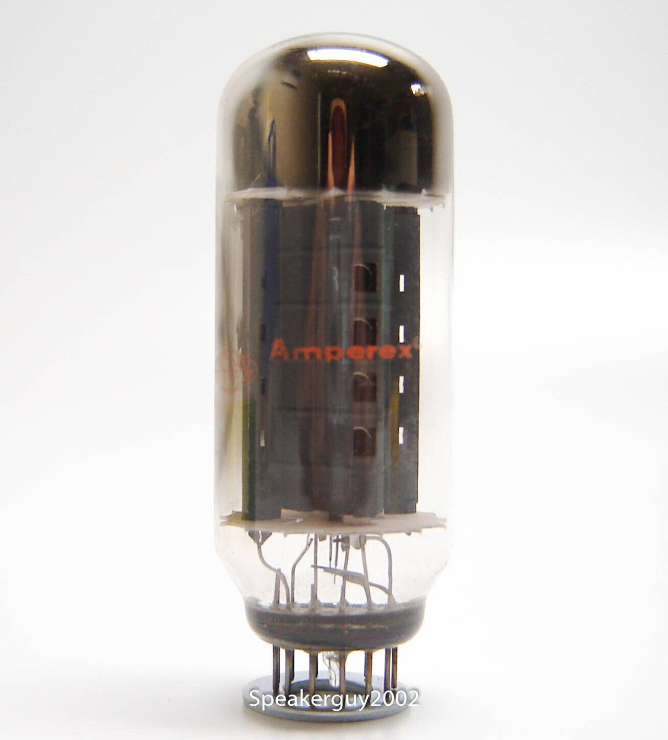

There are just a few videos in existence showing an individual assembling the particular elements within the envelope. We see people using very small spot-welders being used, fabricating tiny metal structures...nowhere do we see a so-called "exploded diagram"...are these tiny structures a true industry secret?
Let's see if we can find diagrams of these structures...& try to improve performances by analysis & optimization.
