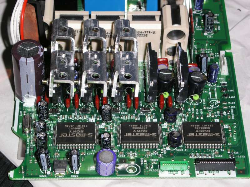

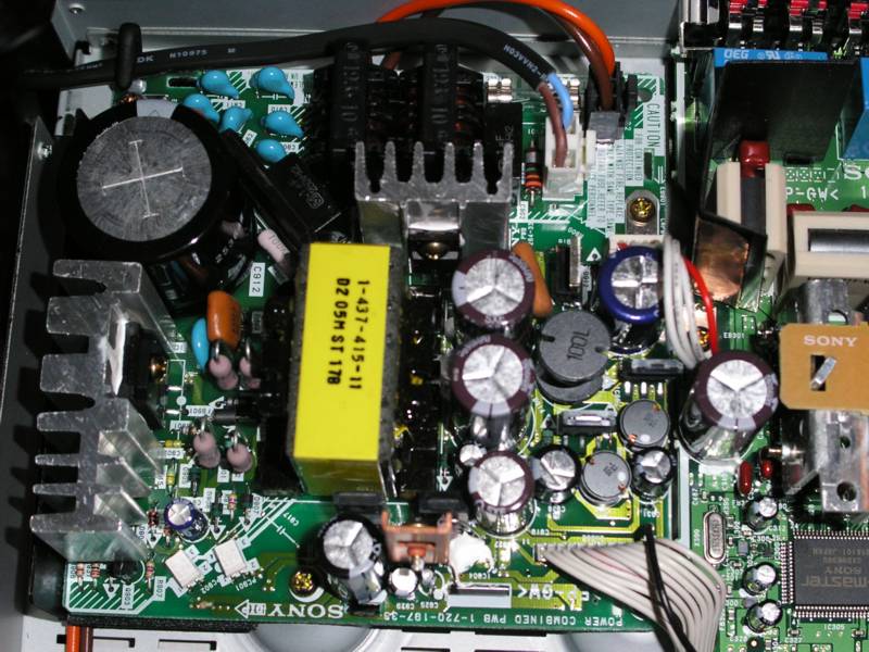

Hi ChuckT,
I wouldn’t change the caps in the PSU unless you know what your doing – SMPS require Low ESR caps, and changing types / values could upset the Feedback loop.
However the caps on the Amplifier board could benefit from improvement.
1. Increase C313 (main HBridge supply) leave the existing cap on the PCB, but add an external larger part (can be fitted across the connecter CN300
2. Fit OSCON’s in positions, C312, C301, C326, C336, C350, C388, C392, C325, C320, C329
There’s a guy selling bags of OSCON caps on a stand in Sham Shui Po (electronics market) for HK$1 each!
Buy the 470uF 6V3 and fit in the above position (where the voltage rating will allow).
The PCB is very poorly design (very poor ground plane & terrible HF decoupling), but the above modifications will improve the audio quality.
The S-master modulator can achieve a dynamic range of just shy of –120dB; it’s not a bad design.

Wow, that was a quick reply. And from HK too.
Thanks, I know it is not wise to mod a SMPS. I normally just replace the last cap in the output.
Do you have a schematics?
Yes, I am alway happy to meet a local fellow moder.
PM me and we'll discuss.
I have a lot of Oscon in my box, so really I can start immediately.
What values do you recommend to replay the 100uf/10V.

Ops, read too fast.
I don't have 470uf/6.3v. The max I have is 150uf/16v.
There are various values, I am not sure using such a high cap value is a good idea.
Hi ChuckT,
No problem to fit as large (Oscon) cap as you can, although there physcial size will be the limiting factor. The LV regulators are very noisy (on the Clock and digital supplies around the modulators), the larger caps well help reduce this.
The output devices are "badged" Sankan devices, and the modulators are Fab. by Renisis (Ex Mitsubishi).
I'm sorry I don't have the circuit diagram, I bought a unit to Eval. the modulator (Sony DAV-S400, which appears to be very similar apart from the Video IO / Audio IO / Tuner Bd).

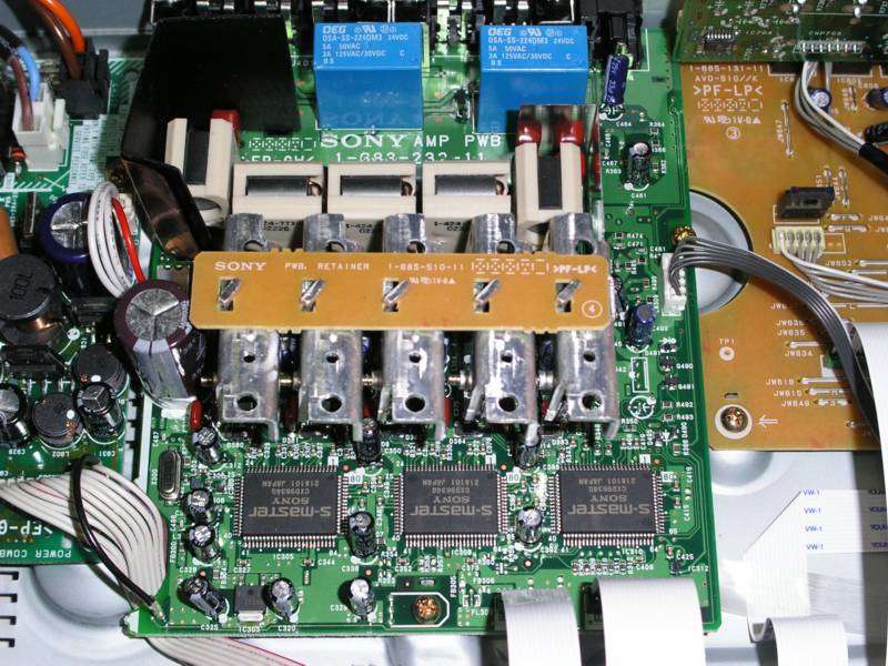

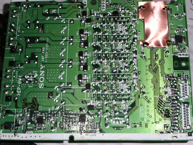

Hi John,
What's with all the shielding.
There are 2 copper shield under the amp board and shields around the 8 coils.
The small shield under the amp board cover the crystal the 2 s-master chips. The large one covers half the underside (not shown in pic).

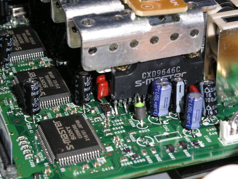

Hi ChuckT,
I would leave the small Red / Brown caps around the Output stage – these are the HF!!! Decoupling caps – they should have used better quality (from a HF standpoint) SMD ceramics. But you could try changing the Larger Red / Brown ones next to the output inductors (OPS LPF).
The shielding is to prevent switching noise pick-up into the Clock circuit, and reduce capacitive coupling of the OPS signals into the chassis, my unit has add-on “RF clamp beads” for the speaker cables included, in what appears to be an after thought – there’s no way this unit can pass the CE EMC test - with speakers leads connected and these beads not fitted!!
You should also add large value OSCON's around the Clock circuit and around the other modulator IC’s, to reduce induced noise on the common PSU lines.

I see, no wonder the shield under the clock is soldered at the four corner to the ground pin of the caps. It will be a pain to replace those caps.
If ceramic is better then those red caps in that application, I can easily add some smd ceramic bypass under those red caps. Maybe 4.7nf NPO and a 0.1uf
Do you know if I can find datasheet for the cxd9646?

Hi ChuckT,
The OPS CXD9646 is a Sankan device - however, I could not find data on it, from Sony or Sankan.
The Heatsinks on my unit run very hot - even when the units not playing music - suggesting large cross conduction / slow output stage.
I like the way Sony "stacked" the OPS inductors, in an attempt to cancel their magnetic fields,

Hi Chuck,
The Gain control is performed in the digital domain in the CXD9634Q, theres no method to improve upon this - unless you use a variable PSU
I would not remove the relay - it prevents large DC offsets while the OPS powers up.
John
