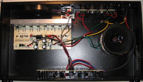

I just received a cheap (90€) "PA" amp that is supposed to have "480 Watt max achievement at 4 ohms (2 x 160 Watt at 8ohm)" I bought it for 15€ because it was broken, just to see what's inside.
This is what I found:
- A lightweight 2 units 19" rackmount enclosure.
- 2*26V torroidal transformer, weight between 1.2kg and 1.5kg. So I estimate it at no more than 120VA.
- 4000µF of power supply capacitors 😱
- Very loud fan that is always on full speed.
- a tiny heatsink.

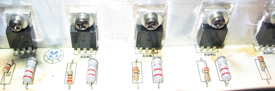

- 8 blown mosfet's and 2 burnt resistors. Mosfet's read A940 on them, but I can't find any mosfet that matches this part number.
- A rare level of build quality.
As you can see, a "real" performer. 😀

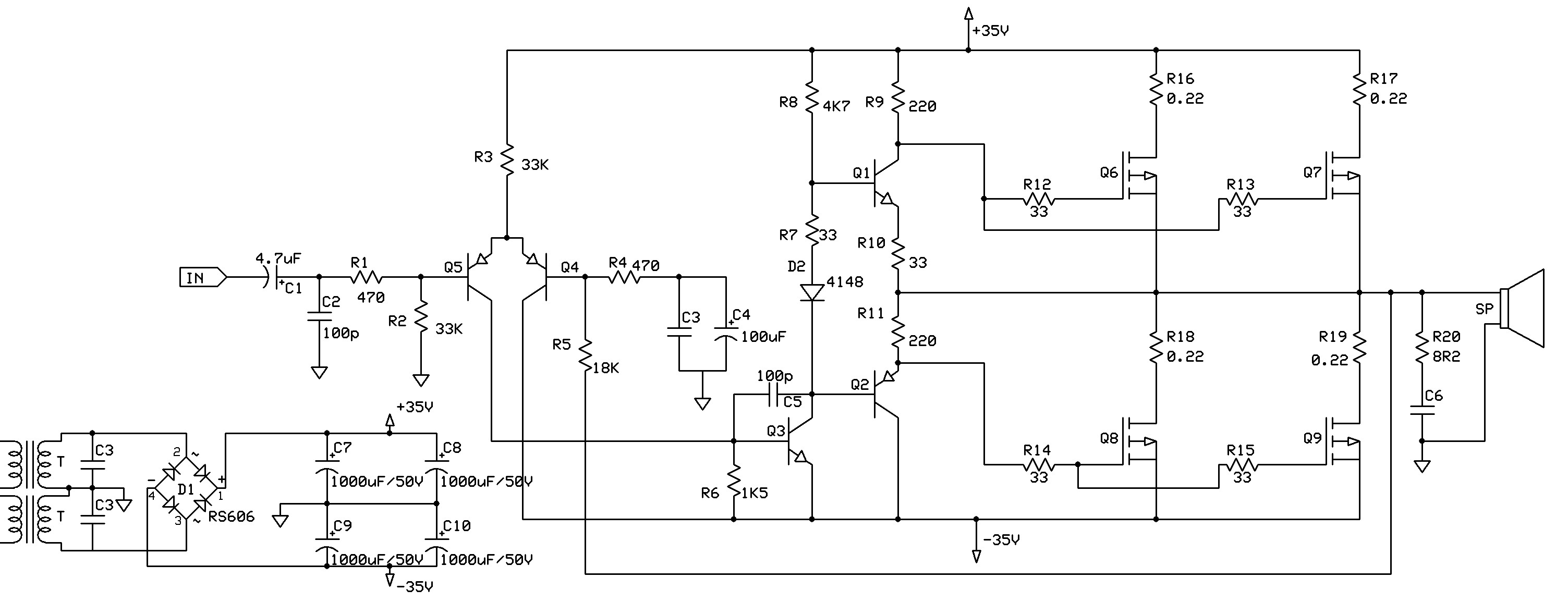

I traced the schematic just to check if this amplifier self-destructs by design. Anyone has some thoughts on the performance of this circuit?
edit: non mosfet transistors are 2SC1815 (npn) and 2SA1015 (pnp)

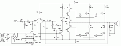

Edit: I think this would be the proper circuit?

Pretty rubbish circuit with resistive load for VAS. I think you may have the 0.22 ohm resistors the wrong way round - they should be in the sources. Maybe this is what caused failure.

If it is on 35V rails then peak power is 35^2 / 8 = 153W, so RMS power is 76.5W, allowing for loss in the resistors and mosfets you'd probably get 70wpc from it.
Of course my maths is a bit rusty - correct me if I'm wrong!

I checked and double checked the circuits around Q1, Q6 and Q7. They are as indicated on my schematic. All 0.22 resistors are on pin 3 of each "mosfet".

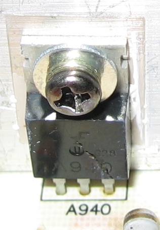

All 8 "mosfets" have the same markings: A940. I'm confused as marketing blurb said "modern MOSFET technology". As some other members mentioned, I can only find the PNP transistor with this name. All 8 are broken, so it's impossible to say if they measure as a fet, pnp or npn.
I found some people with the same broken amplifier and they also report that all "mosfets" have the same A940 marking.
Well, if my eyes are still good, there is a Fairchild logo on those transistors. Fairchild doesn't manufacture 2SA940 but they do under a different name, KSA940 which is again BJT PNP. Maybe they are fakes from China, dunno. 😕

It looks very much like the inside of cheap amp I bought off ebay.
I was shocked at the minmal heatsink and transformer for the wattage specified for the amp.
The amp worked but definitely did not give the wattage advertised.

Well, the "mosfets" look exactly like the KSA940, a PNP transistor. I wonder why they would use an all PNP output stage. Looks like a design from the late 1950's. Also there is no temperature compensation at all, so it is possible that these amps self-destruct by thermal runaway.

I can't imagine how a mosfet amp without manual bias adjustment should work in any reasonable way. VGS is usually all over the map. Matching is too expensive for cheap amps, anyway. VBE of bipolars is perfect in comparison.

Hmm - where does the bases/gates (most left pin) of the lower and the upper outputs go exactly? ( you have drawn them differently in your schematics so it is hard to gues) Double check that so that we can conclude what type it is.
Hereafter 2 options:
1) Replace all outputs with cheap new ones, and add a proper bias circuit.
2) Replace the PCB with DXamp or Symasym, and mount a decent heatsink.
I'll probably scrap the Amp PCB. It's no good at all.
Hm, that D2, 1N4148 should be mounted or at least touching the heatsink to ensure some thermal tracking. Anyways, like you said, that piece of junk isn't worth repairing. Replace it with some reliable design. 🙂

I just noticed the value of R7 - 33ohms - this is a pure class B design!
