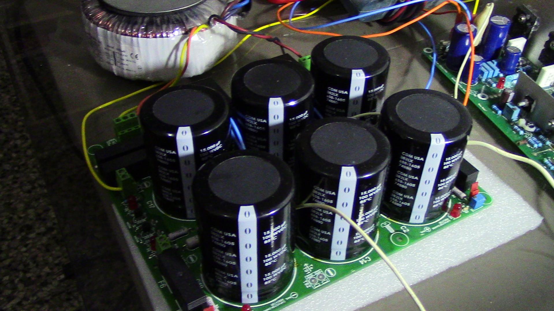

thank you AndrewT, on the scenario I have this new "prototype" unregulated power supply that I design with Mr. ST, it has 6 x 15000uF 100V caps I have plans to use only for 8Ω no 4Ω load, so 12Ω will be just right ? I just want the inrush current to be slow down efficiently and keeping the fuse on a save range (prolonging the life of it) and of course I'm gonna used a relay circuit to bypass the 3 resistor combination that in parallel will give me about 12Ω

I have proposed this hypothesis in the past.I'm gonna used a relay circuit to bypass the 3 resistor combination that in parallel will give me about 12Ω
A higher value resistor will use a a longer length of thinner wire, than a lower value resistor.
Let's use your 12r as our example.
Three 36r power resistors will use a very thin wire compared to three 4r power resistors.
It is my belief (no evidence - just intuition) that the thick wire 4r0 will survive abuse due to over current much better than the thin wire 36r
At start up the three resistors pass 10Apk and will dissipate an instantaneous peak power of 1200W, or 400W (instantaneous) per resistor for a 5W resistor.
I use many 5W power resistors wired in series to achieve the required added resistance, because I think they will be more reliable.

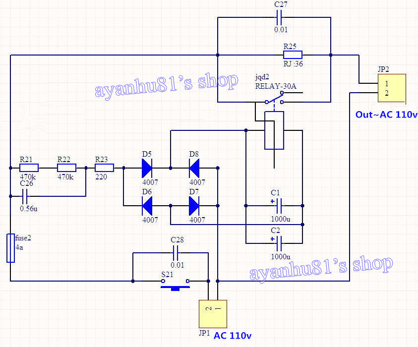

Other reply than what Andtrew T gave me? I will take out R25 (36 ohm 10W) and replace it with 3 NTC ( 10 ohm 16 A).

That's a circuit fed direct from the mains. We are not supposed to discuss that here.
With this argument, the whole Power Supply branch in this forum should be eliminated, shouldn't it?
