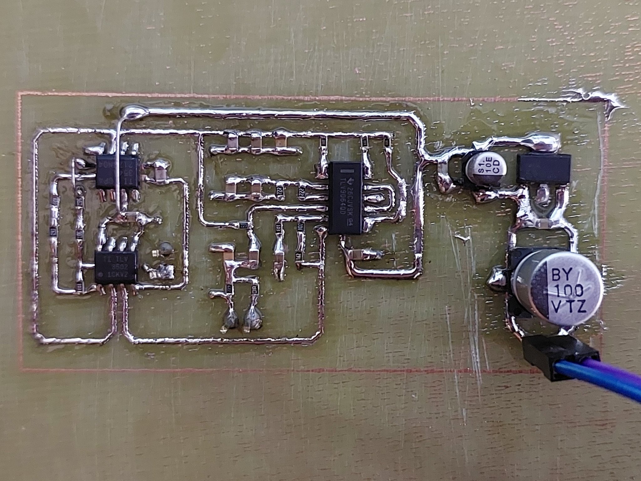

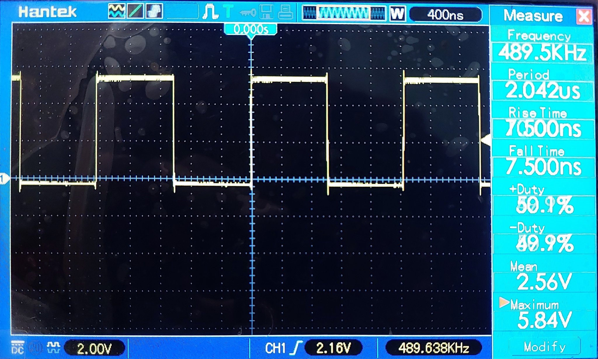

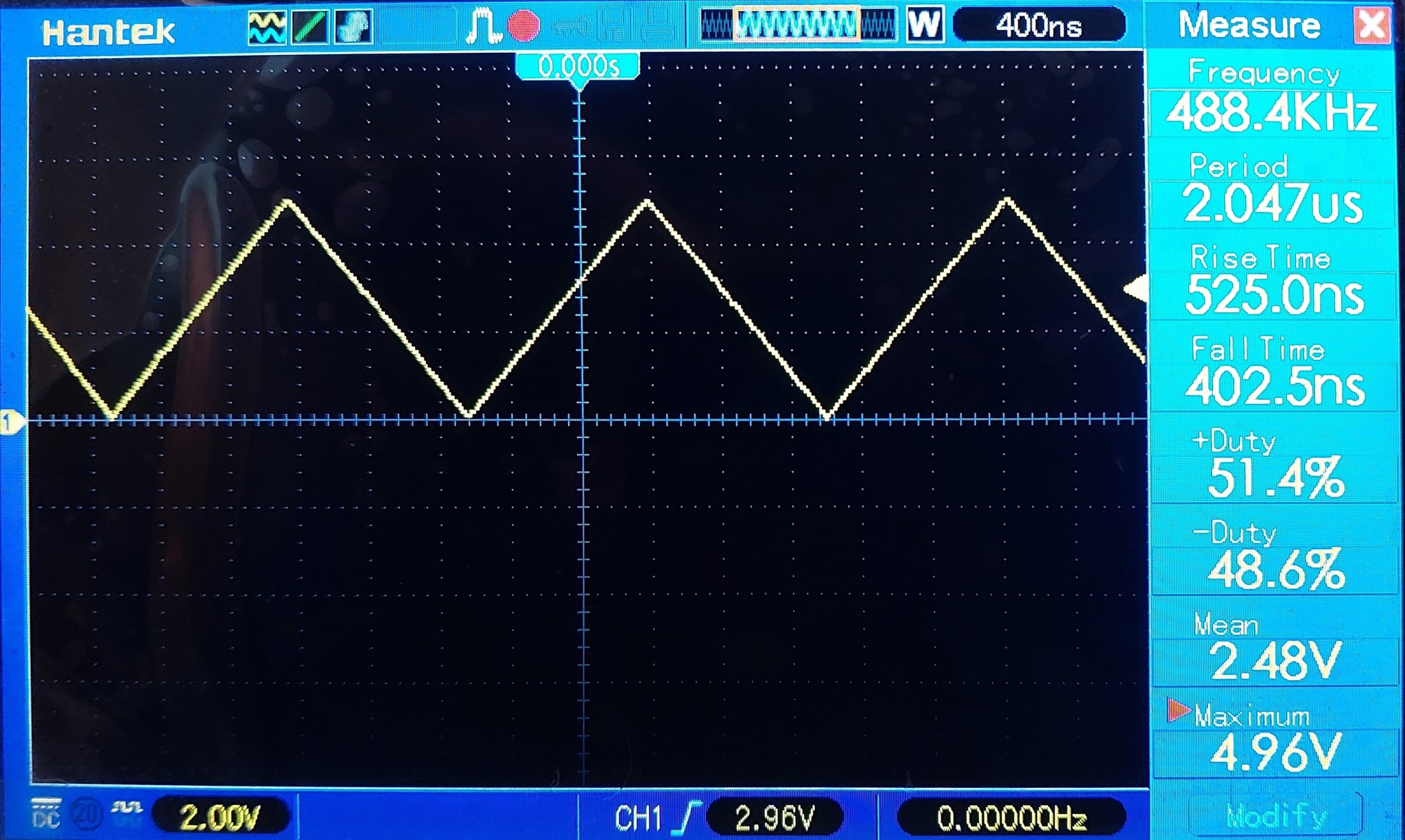

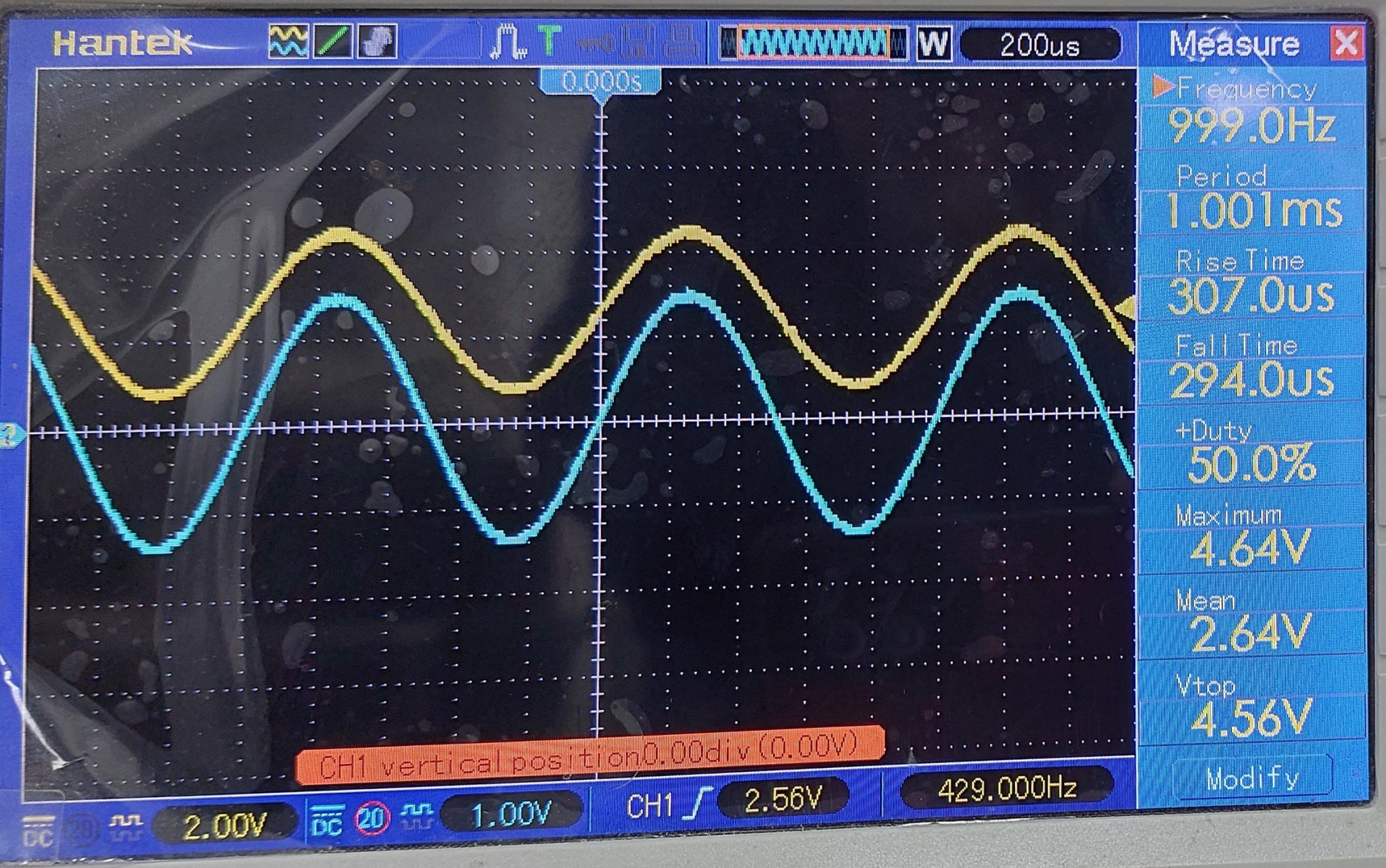

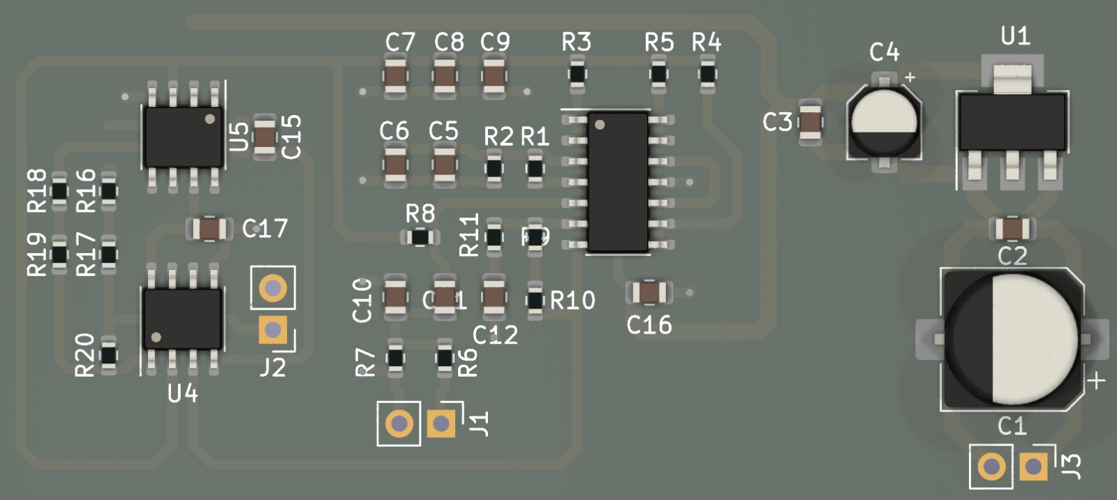

I am an undergraduate engineering student working on the design of a GaN-based class D amp as a graduation project, currently in the component testing and implementation stage. Topologically, the circuit design uses a clocked PWM at a switching frequency of 500 kHz. The 8 ohm loudspeaker will be differentially driven using a full bridge configuration with +100 Vdc supply voltage.
For the switching devices I am using LMG3422R030 GaN transistors capable of operating at a switching frequency of over 2 MHz (copy of the datasheet attached below). As part of the circuit design requirements for the given transistor, the PGND is functionally isolated from the AGND. Therefore, if we want to implement a feedback control system, the system itself would have to be isolated as it crosses from the PGND at the output back to the AGND at the input. For isolation, we are using ISO7731 digital isolators (copy of the datasheet attached below).
- To what extent does an omission of a feedback system have on the output signal in terms of THD and sound quality? Is it worth it?
- What methods are there to implement an isolated feedback control system, given that we have a single 5 V supply rail for the input stage
