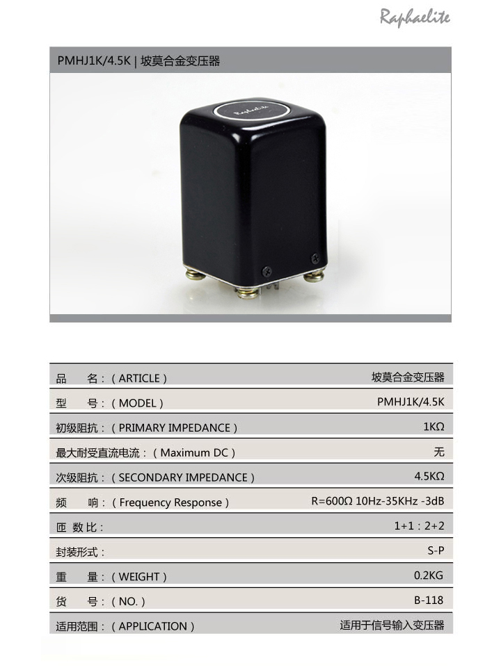

Hello!
I have a Raphaelite amorphous input transformer on hand, and see attached data for details.
Is this transformer adequate for the Amity or Lundahl LL1676 is a must??

It appears perfectly fine. Won't be much surprised if it sounds better than the Lundahl.

The primary impedance is rated = 1k Ohms.
The frequency response is rated when driven from a 600 Ohm source.
Do you have a preamp that can drive 1k Ohms?
And is the preamp output impedance 600 Ohms or less?
If not, then you will not get the same performance as the specification sheet.

A hybrid line stage with a big honking MOSFET voltage follower driving the downstream load easily gets the O/P impedance under 100 ohms. Scan the archives for my 6SN7 based setup. Obviously, other designs are feasible.

There is absolutely no need for such a preamp. Low output impedance is sufficient.

I have mu stage linestage that has 5687 loaded with MOSFET called Marsh sound design P2000t and it should have an output impedance less than 500ohm
I want to try this interstage but it is not able to wired in 1+1:1+1
