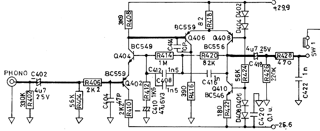

I also saw this connection, called the rush cascode. I think there's one in a naim preamp or phono amp

>How come others can use no-R between 2 emitors?
>Wouldn't this making very huge gain?
It's used in the Nad preamp
The gm is the same as a parallel differential without resistors in the emitters.
