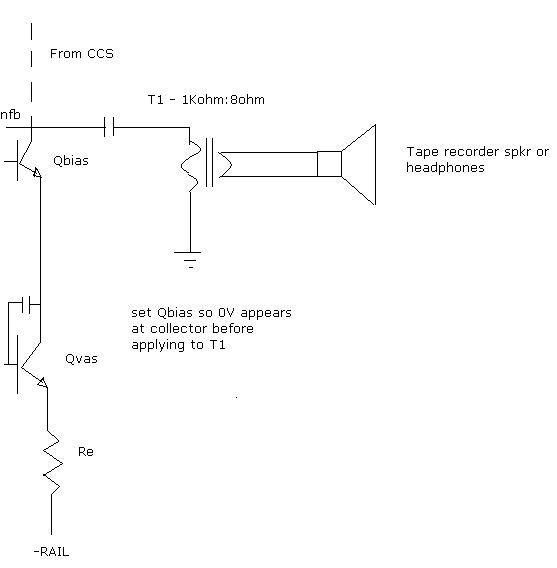

- have you ever wanted to listen to/scope out your input stage + vas before connecting to OPS? sure you have imo.
- have you ever repaired an audio amp with blown channel and wanted to make sure VAS / diver stage ok before installing new outputs??? sure you have imo.
- i don't expect a PhD analysis on the circuit i posted, complete with maths. just a common sense opinion, plain language description.
i know you are are more than capable of understanding and explaining whats going on here, and that is what is frustrating to me why everyone is so quiet.

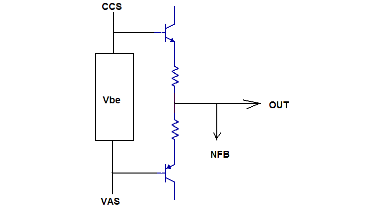

I would add a pair of drivers and listen to it / test it. It doesn't need a full OPS. Pick the NFB off the drivers output.

I do it a little different than above. First I'll hook the drivers
up with 2 47 ohm resistors, then run headphones off of a
220 ohm resistor or directly run a cheap 16 ohm speaker.
Since the drivers just "follow"or buffer the VAS one can check
voltages,hot components, and bias (you will be grossly
underbiased when you do hook up OPS,which is good).
With this I DO NOT burn outputs (I always drool over all the
burnt OPS devices I see in the quasi threads)
and get to test amps out before going high power/ current.

Hi MJL,
thank you for responding to me several times in various threads. i am professionally and personally vary grateful.
if you have time in your busy day, i am still mostly beginner with diy audio so here are a few basic questions:
- by driver you mean the first (inner) darlington transistor (assuming EF topology)? then hook the 1K trafo between emitters of top and bottom drivers? possibly with emitter resistors?
- must the NFB loop come off the divers? may it come off the VAS leg instead, especially if NFB tap point is trimmed to ~0V?

ostripper said:i a little different than above. First I'll hook the drivers
i like. were headphones in series or || with drivers?

me too. i crank down the bias trimmer to 0V between base and emitter of Qbias. Let her run in class C for a little till you make sure everything is working ok. then spread the bias out to class B or AB until crossover distortion is acceptable to your (or optionally, your friends) ears.
Just hooked in series with output through 220 ohm resistor.
Once , since these amps can put out 60V p-p , I nearly
blew my ears out and fried headphones doing this.
Now I just use a cheap junkbox radio speaker to do this.
One can get a idea of Xover distortion/bias using test tone
as you get at /or below 1.2V across VBE.
I'm far from an expert, just learning here myself.
Basically yes, construct your driver stage as it would be in the final amp (see below). I don't think you need the transformer. For impedance matching, put an appropriate value resistor in series with the output.

I always test any driver board I build by applying the VAS output back into the -ve LTP.
I like to know this is correct before even considering connecting output transistors.
The scope quickly shows up any problems without blowing a set of output transistors.
- input stage and VAS testing
