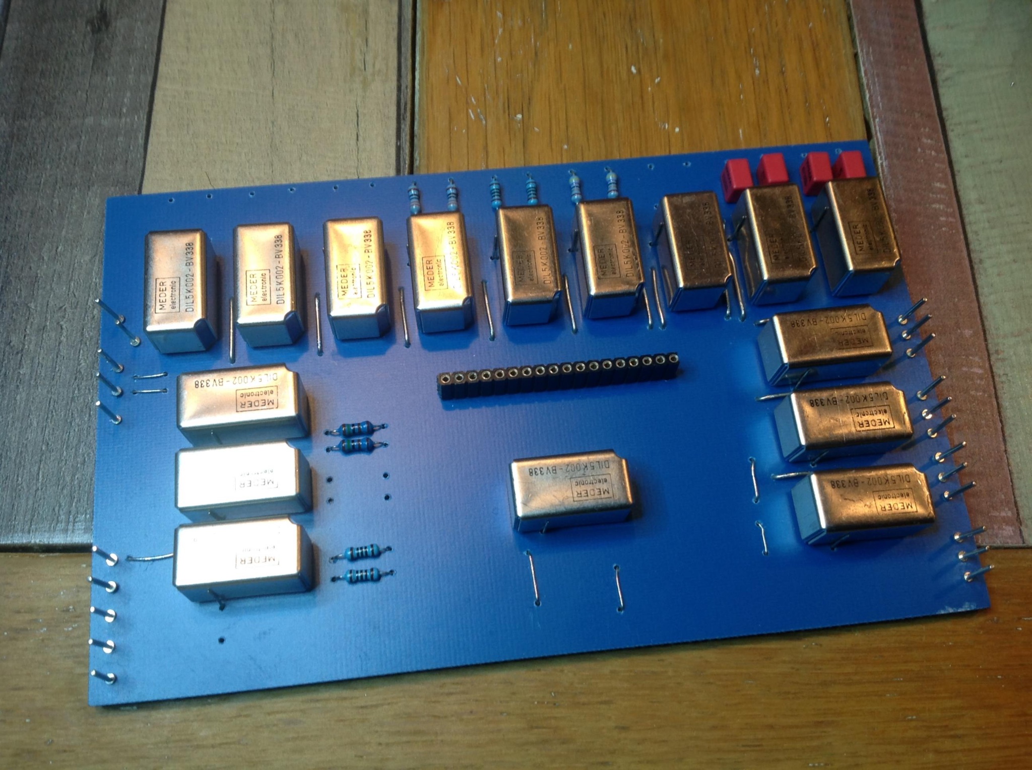

Once upon a time I build a phono selector board. Controlled by arduino.
It has three inputs and impedance adjust.
https://www.diyaudio.com/community/threads/sound-comfort-mc-mm-phono-preamp.297718/

Build a lot of input selectors and stepped volume controls with it. No problems and low current( 1mA).

Yes, they were surplus. Now only two sellers left. For 3 euro a piece.
https://shop.tvsat.com.pl/en_GB/p/2pcs-DIL5K002-BV338-Reed-Relay-5VDC-1A-THT-MEDER/28810
