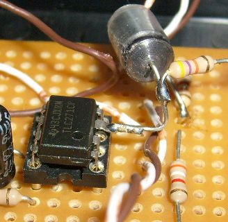

to prevent leakage currents I bend the input-pins and wire them free air.

juergenk said:to prevent leakage currents I bend the input-pins and wire them free air.

called "dead bug" -- popular in low power ham radio applications as well.

Hi Chris,
thats not an audio circuit, the (+)input-pin is bend up to preserve the GOhm input impedance and avoid leakage currents.
The socket doesn't hurt in this special application.
Guess the hints in the BB datasheet weren't meant for audio circuits too.
Regards
