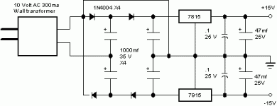

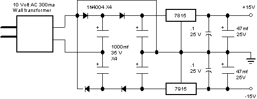

you would require much less than an amp to run 6 mic preamps i imagine, hardly any power at all.. maybe 100mA max per opamp, much less for a transistor, so you can just add it up..
a power supply can be made very cheaply also, a few RC circuits in series after a voltage regulator will easily lower the noise adequatly..
