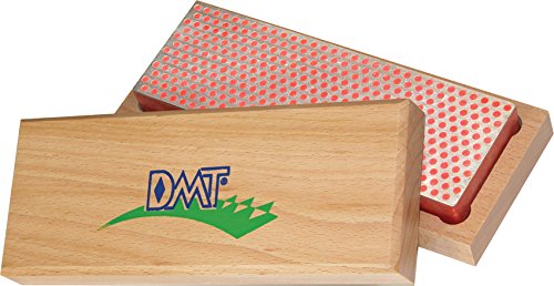

I gently wipe the mounting tab on TO-220 packaged devices, across one of those DMT Diamond Whetstones. Takes off microscopic burrs and, I assume, unwanted Sharpie juices.
