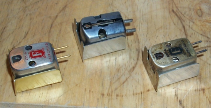

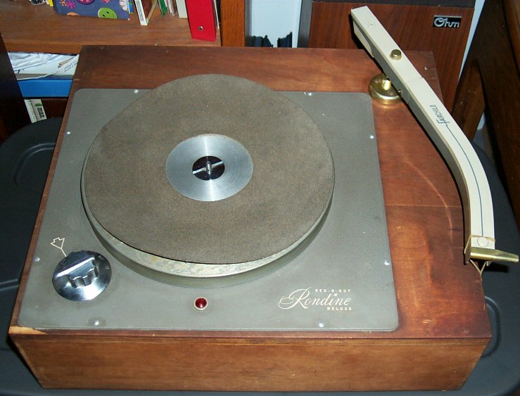

All, A few years ago I acquired some items out of a church attic. Rek-o-kut Rondine turntable, with a large Fairchild tonearm, and three cartridges in replaceable "headshells" ( for lack of a better term). Is anyone in this forum familiar with the Fairchild tonearm or cartridge? Maybe even have experience using the equipment? I've attached pix for identification.
Thanks in advance for any information you can provide.

All mono cartridges.. I think you will have more luck getting information on the Rondine on vinylengine than here..
Here is the link: http://www.vinylengine.com/phpBB2/index.php You will need to register to access the manuals and other resources here. IMHO VE is the very best place for TT information on the entire web.
The arm is collectable being a Fairchild as are the cartridges, however it is not suitable for playing modern microgroove stereo records.
Some of the later Rondines are quiet enough for stereo playback, some have excessive rumble in the vertical plane which can be a big problem in stereo. A very heavy plinth and a newly rebuilt idler wheel from terry's rubber rollers might help.
Around here some regard this as the poor man's Garrard 301, and it might be - I've no recent experience with this table.

I live and learn. I got this equipment 3 years ago. A church was cleaning out its attic. They must've had a monophonic record playing system at one point, which included the Rek-o-kut and Fairchild, a Mac C8 and a Mac MC60.
Last night I was surfing ebay looking for something else, and I spotted the Fairchild cartridge. I hadn't done any research before, so didn't realize the Fairchild carts were moving coil. I was quite surprised.
Unfortunately the only (electrically) good cart is the worst looking of the three shown. The other two come up with a big Zero on my ohmmeter... so I assume they're dead. And the styli condition is unknown at this point.

The Turntable is a Rondine Deluxe. (B12H maybe?) It's a pretty sturdy unit, the motor is huge. I also have a 301 Garrard stashed away in a box somewhere, but I've never done a side by side comparison.

Cool, this sounds like the ticket to good 78rpm playback. Did you get the C8 and MC-60? The C8 with a rebuild would be the hot ticket for playing old 78rpm discs due to its comprehensive EQ capabilities.
You might be able to get one of these Fairchild mono cartridges rebuilt, but you might be better off with an early SME arm which will take modern monophonic cartridges.
