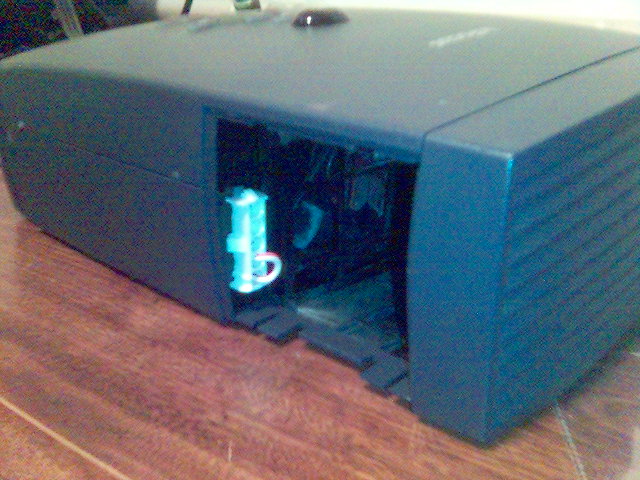

Hi mill
I have tried to bridge the 2 bottom connections on the lamp plug, and run with the lamp removed, but it goes through it`s normal startup and tries to fire the lamp. then goes into standby and stops the colour wheel.
Have a i got this right, plz check the pic
yes that is how i did it but there must be a light sensing device in the light path.
When the pj doesnt detect light then the colourwheel will stop.
Just try a 12V 50W halogen spotlight and you will see that the colourwheel will start again
I had an 100 inch picture just by using the halogen light.
Not very bright but still good.
