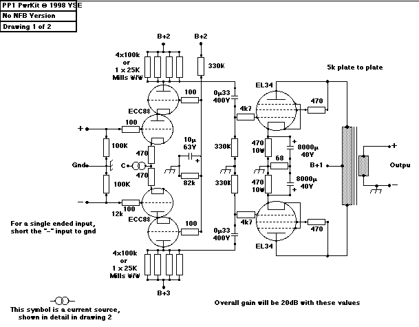

How about another starting point?
I always thot this amp would be a good candidate for 6B4G instead on EL34s strapped in triode.
It is the basis for VSE's 300B PP amp.
dave
dave
dave
Buffer the differential cascode with MOSFET source followers and that will do for driving the small grid to ground resistance of "fixed" bias 6B4G "finals". Hmmm, 6922 cascode anode potential will be in the general neighborhood of 200 V. That, suggests that the little ZVN0545A, with its tiny capacitances, could be an excellent fit.
Problem with that circuit will be low distortion at high swing- an ECC88 cascode can do very well at 40V or so, but a 2A3 or 6B4 needs much more. ECC99 might work, but I'd be inclined to stick with a 6SN7, but change the operating conditions- input couple via a step circuit that puts ~20-50V on the 6SN7 grid, CCS tail, 5mA or so current per side, 47k plate resistors, and a 450V supply. A pair of CFs or source followers would be very advantageous sandwiched between the phase splitter and the output stage.

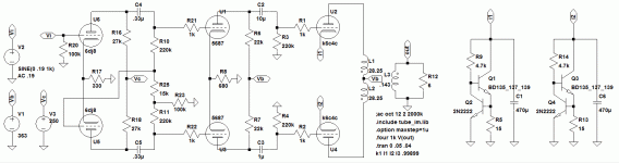

Hi. I have tried to make a circuit with LTSPICE, can it works? (sorry for my bad english)

The circuit posted by Planet 10 drives trioded EL34's perfectly without any need for ** MOSFET followers.
Changing the input tube to the 6H30 running at 15mA with 12k anode loads drives 300Bs PERFECTLY - as evidenced by the great reviews our dpa300B poweramps have received. Check out my website.
I do NOT agree with adding MOSFETs into the signal path of such an amp - unless you can't hear what they do.
And Sy, the 6SN7 is not a great tube for cascode - far too little gM. The 6H30 though is a killer at 15mA/V and lots of current.
I want speed and I want definition.
Regards, Allen

I wasn't suggesting the 6SN7 for cascode- it's indeed not a great choice, top or bottom- I was talking about the original 5-20-derived circuit.
