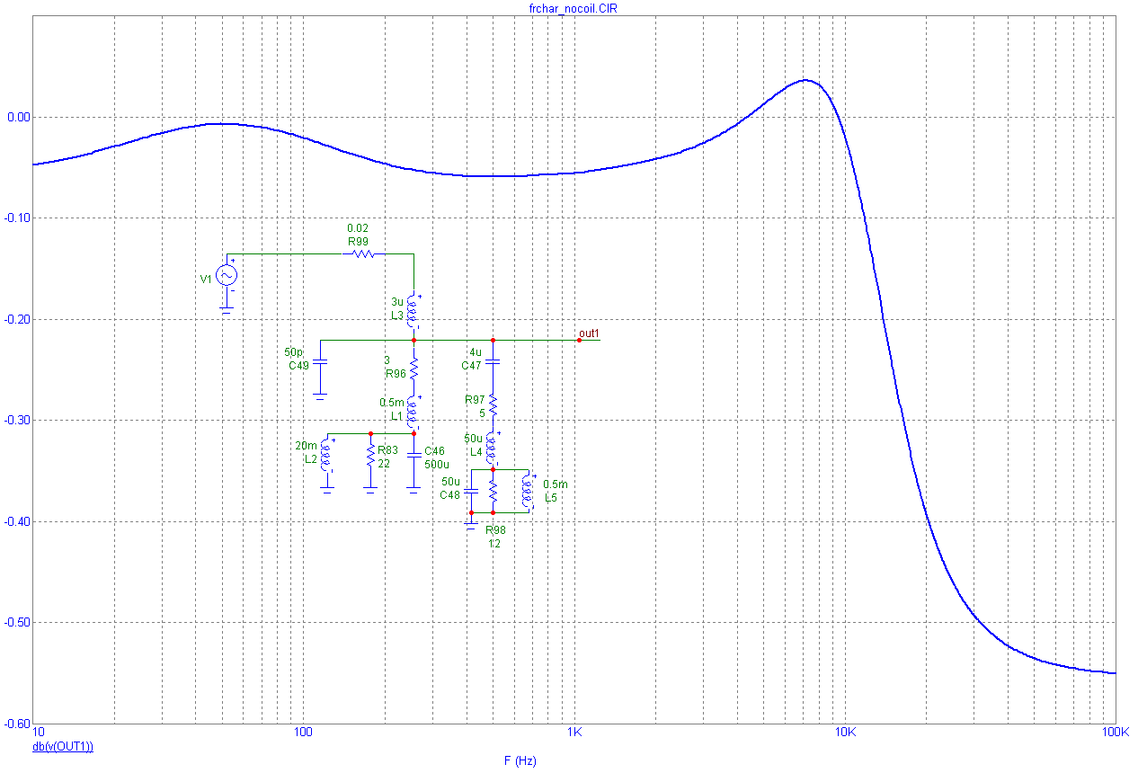

Let's first see a real world situation with speaker cable but no output coil. The amplifier is assumed as an ideal voltage source with zero output impedance for now. We add cable and terminals resistance (R99 = 0.02 ohm), cable inductance (L3 = 3uH) and cable capacitance (C49 = 50pF). Changing L3 to 2uH or so does not affect results much. The rest of the circuit are equivalent circuits of woofer and tweeter and C4 is the simplest high pass cross over possible.
Now let's measure behind the speaker cable, at speaker box terminals. The voltage measured is V(out1). Let's make a frequency response plot and see what is happening.

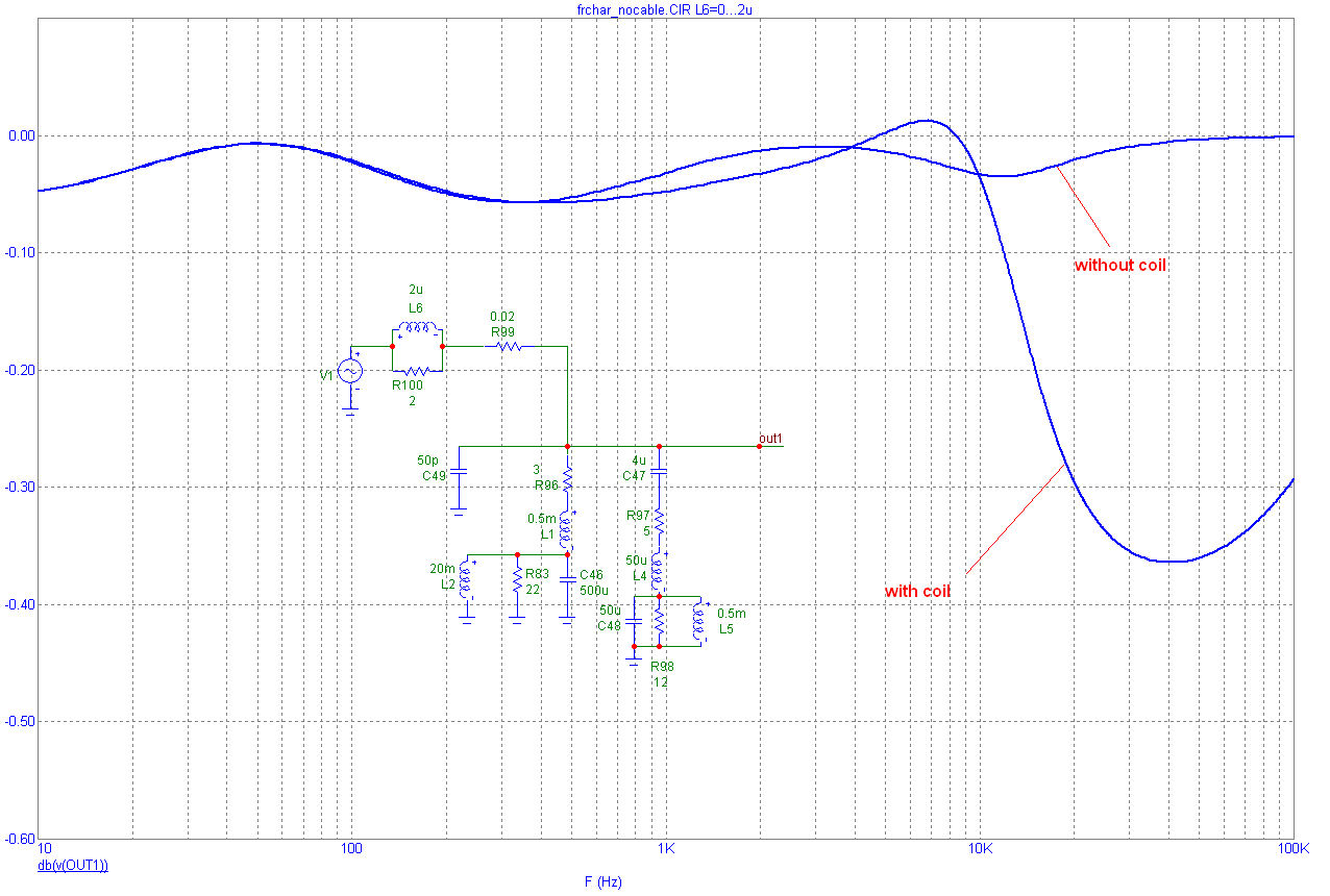

From the previous post we have seen that the influence of speaker cable to frequency response at speaker box terminals is not negligible in the real world speakers. It is quite different from frequency response into resistive load.

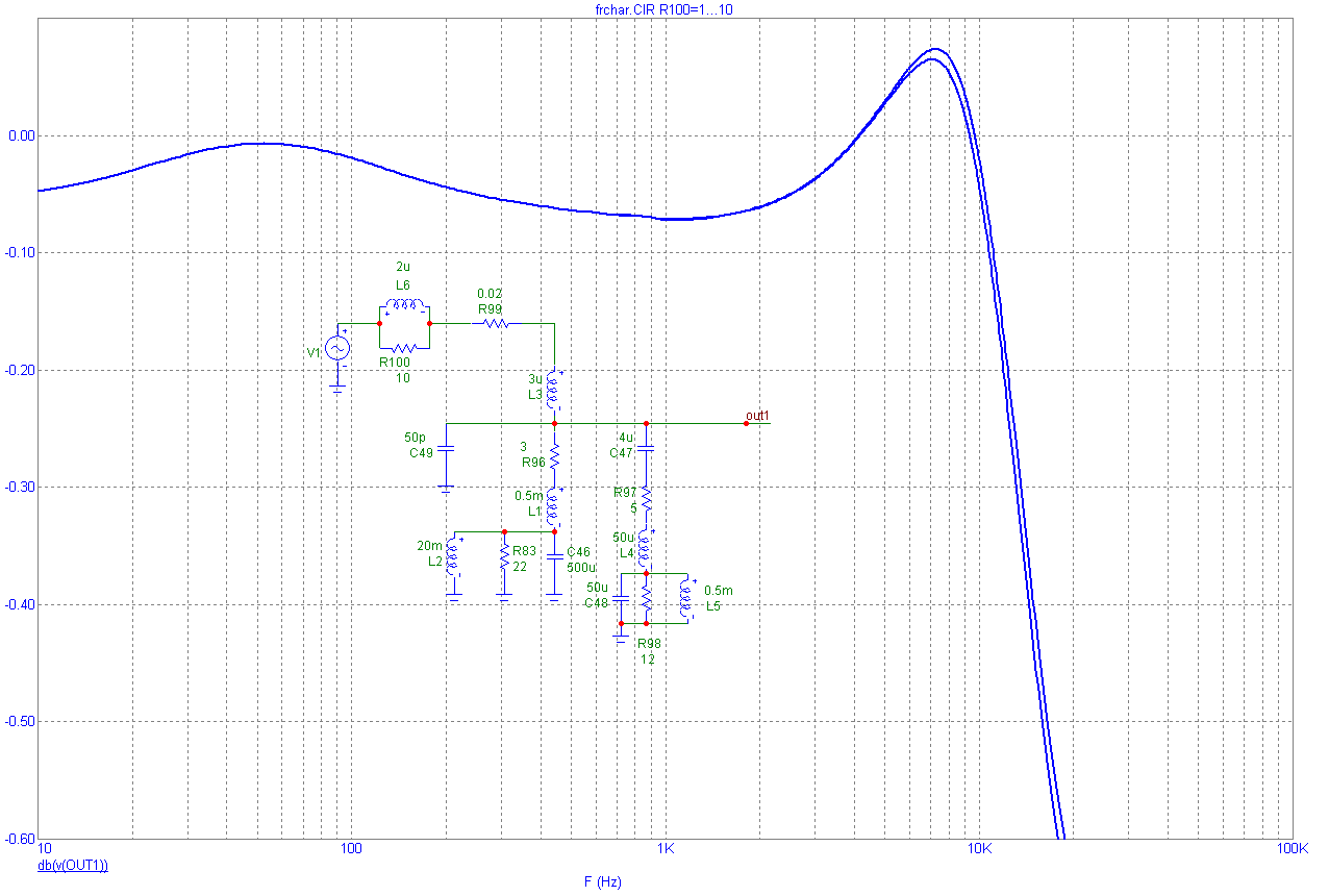

Now let's add a usual part of most power amplifiers, the output coil. The output coil L6 = 2uH (quite usual value) and it has damping resistor R100 in parallel. We shall step this resistor from 1 ohm to 10 ohm, again quite usual values.
In the image attached we can see the result. The output coil of 2uH affects frequency response above 10kHz substantially. The damping resistor R100 does not help much to change this situation.

the cart is difficult to read. Are we talking about 0.02dB difference?The output coil of 2uH affects frequency response above 10kHz substantially.
Regards
Regards
No. This 0.02dB is the difference between 1 ohm and 10 ohm damping resistor in parallel with output coil.
The difference between "output coil" and "no output coil" is about 0.2dB at 20kHz (in this particular case), it is the difference between images in Post no.1 and Post no.2

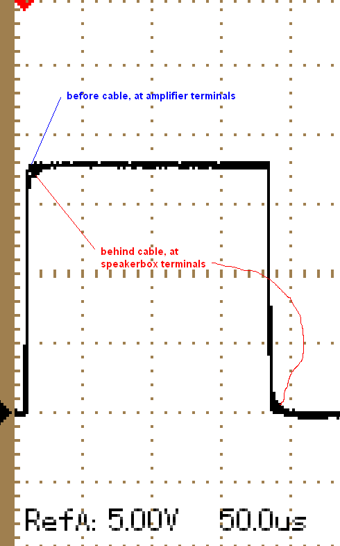

thanks for your comment. I was always aware of the fact that there would be "some difference", but never analyzed and quantified before. Few days ago I made a measurement comparing square impulse response before and behind speaker cable, with real loudspeaker box as a load. From time response it was obvious that there was an influence even in audioband, not only ultrasound band difference. So I started to simulate and simulations did confirm the measurements. I am attaching the time domain measurement, but the amplifier used has no output coil, so it is the influence of speaker cable (2m approx.) + speaker complex impedance.

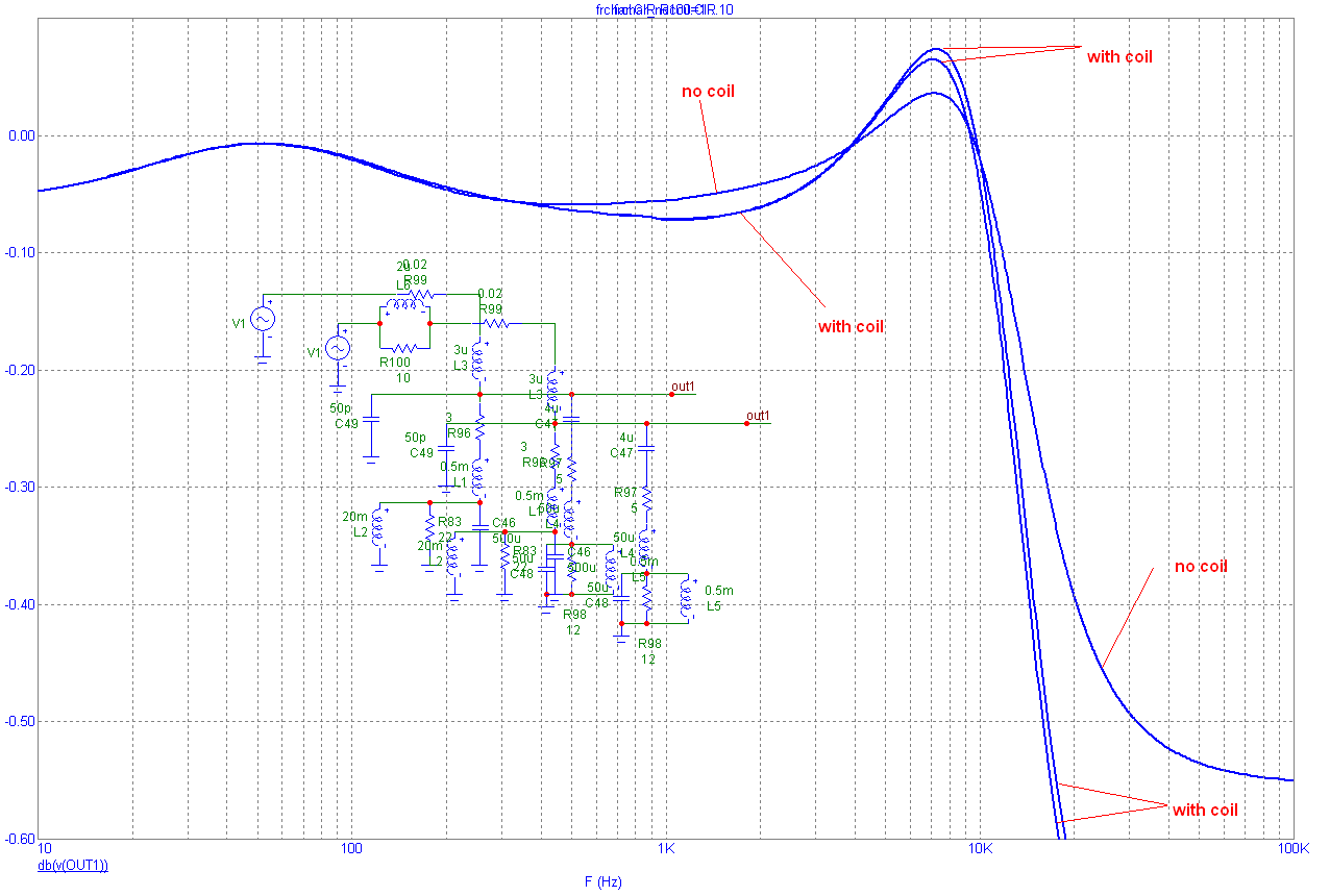

We can see the differences of frequency responses "with output coil" and "without output coil" if we put both plots into one image, as shown now.
Anyway, we can also see the influnce of speaker cable impedance to frequency responses - this would depend on cable used and overall speaker impedance vs. frequency response.

Jan, for better demonstration of the output coil influence, let's assume extremely short speaker cable, that means that cable inductance is omitted. Now we can see just the contribution of output coil, for 0.02 ohm amplifier output impedance.

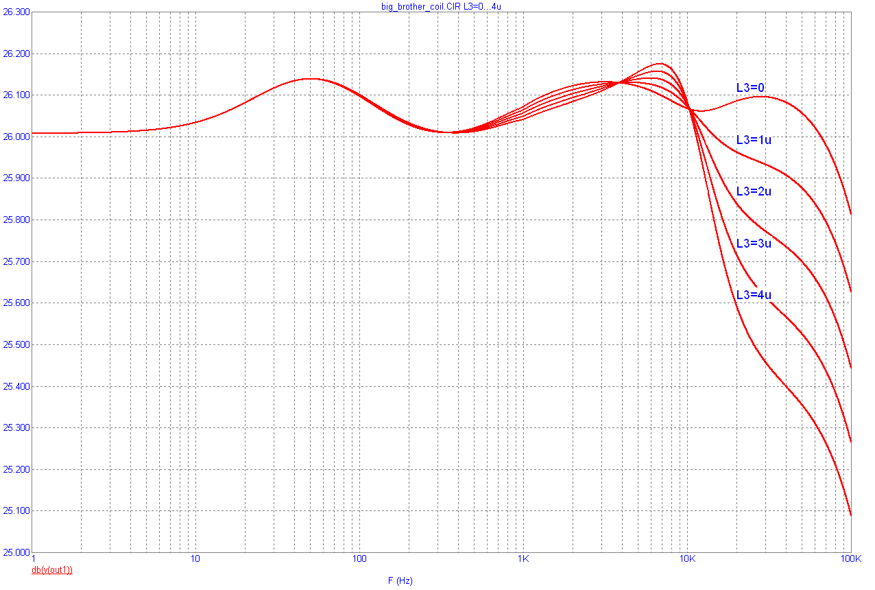

Here is the simulation for the real life amplifier, the one with which I do measure the influences mentioned. The simulation is for no series resistance added, and output coil stepped from 0 to 4uH. The amp itself has no output coil, it is designed not to use it.
OK, that suggests that in simulation your amp has much less than 0.02R resistance and much less inductance. How that translates to the real world I don't know.
Have you plotted the input impedance of your crossover+drives? It seems to be going suddenly very low above 10kHz, and maybe very capacitive too?
