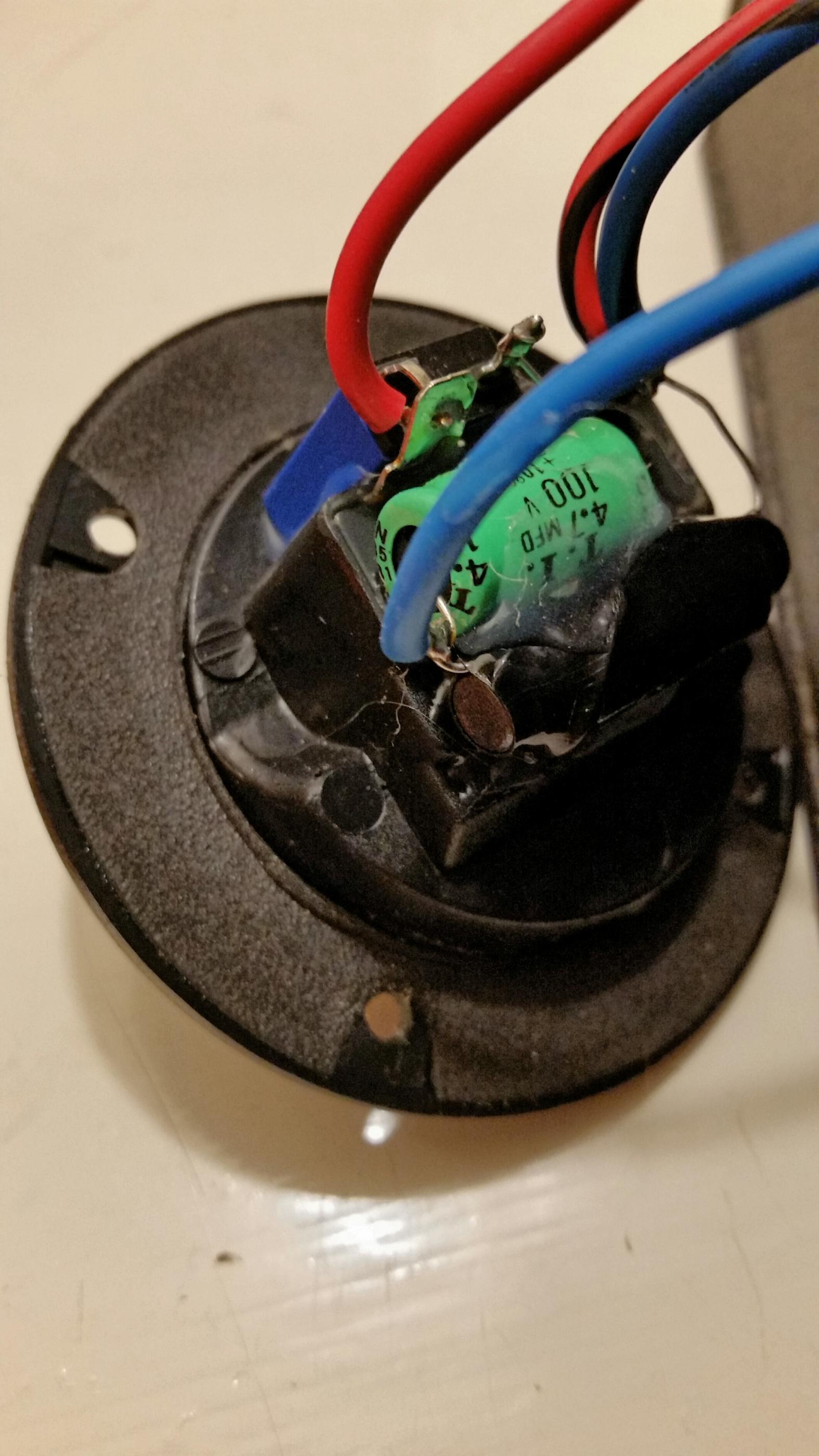

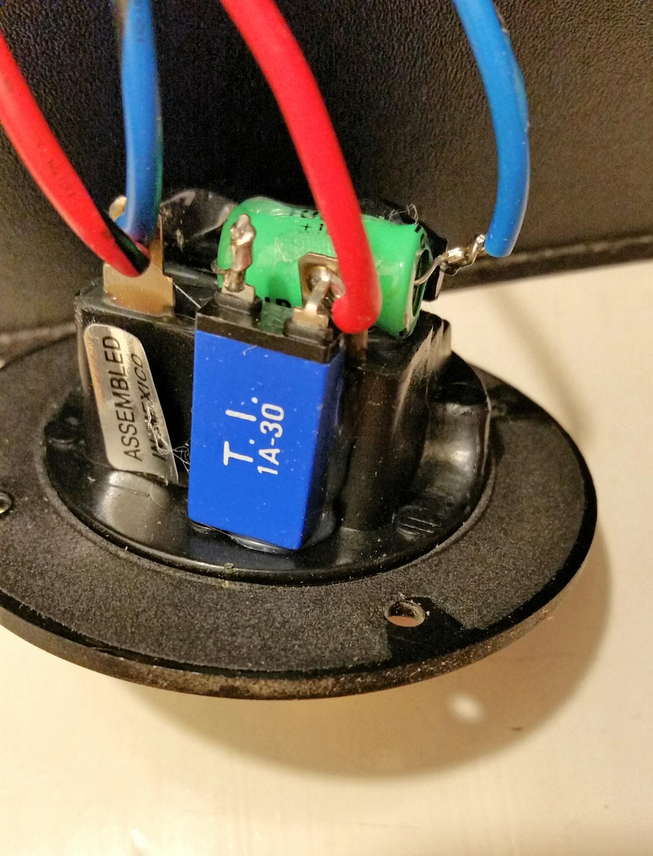

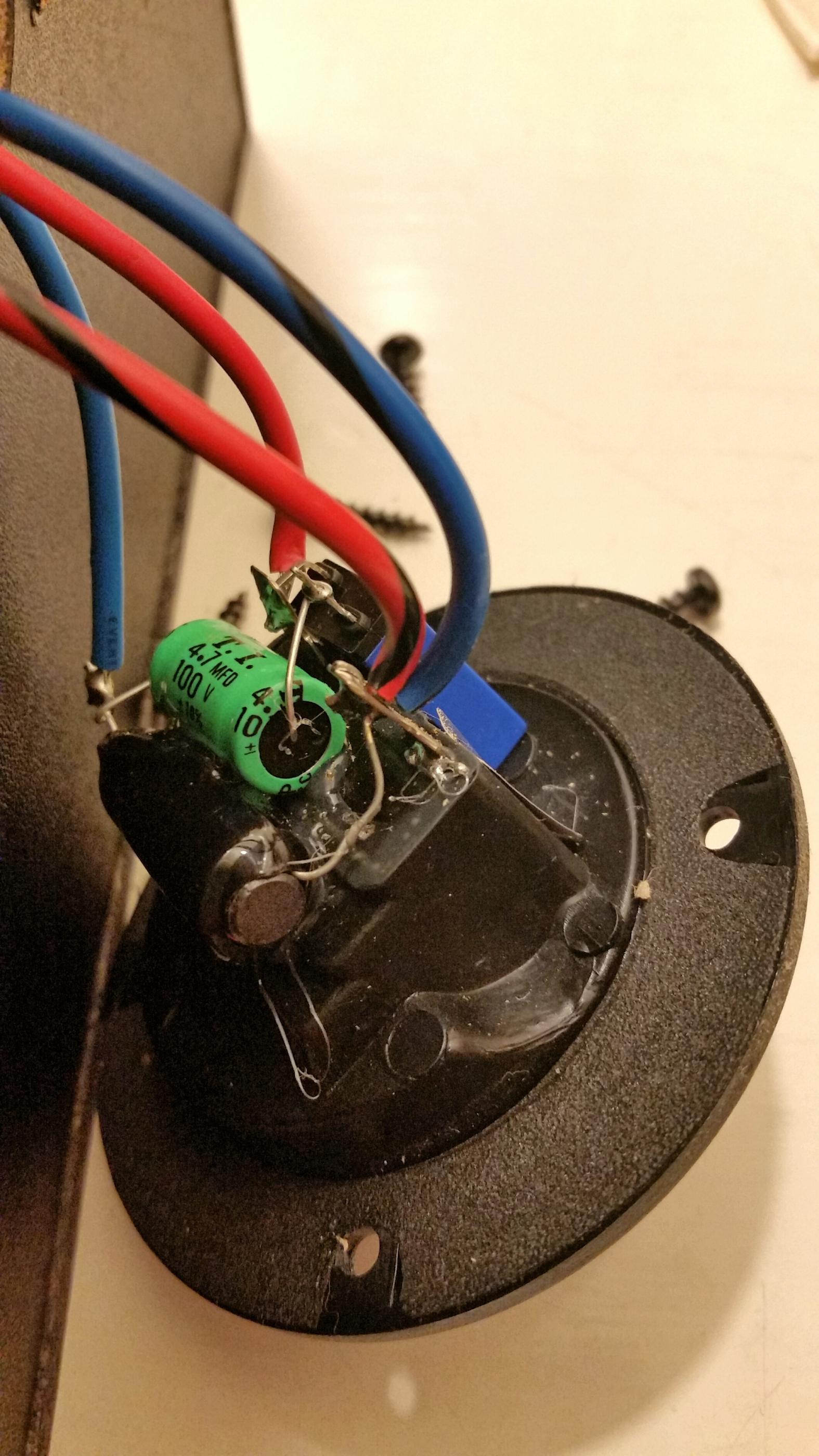

Attached is another pic of the original crossover. Is anyone able to draw out the original crossover? There is a component in parallel with the 4.7 microfarad cap, which is obscured by glue. Thanks, Joseph
It seems it is simple 4.7 microF capacitor as a high-pass filter for the tweeter, and woofer is directly connected. Blue part is a protection fuse in series with capacitor and tweeter.
It seems that there is a coil after the capacitor ?!?

So I can just replace the 4.7 MFD cap, film quality OK? Easy enough for my skill level. There also looks like a third component in parallel with the cap. Best seen in the second pic, to the right of the cap. What is it? And should I leave or remove the fuse? Is it real protection or cheap sonic compromise?
Thanks, Joseph
Thanks, Joseph
Ones you mentioned it, it looks like a coil, as a part of second-order high-pass filter for tweeter. Difficult to see, please take another photo with better angle and light.There also looks like a third component in parallel with the cap. Best seen in the second pic, to the right of the cap. What is it?
Replacing cap with film MKT or MKP will change the sound for better (more detail), or worse (tweeter may become too obvious) - in this case add resistor 1 ohm or so. Replacing cap with quality bipolar electrolytic is a safe bet.So I can just replace the 4.7 MFD cap, film quality OK? Easy enough for my skill level.
That is a self-resetting fuse for protection. If you play loud, better leave it there.
Sonce, I will take a look and pic later, when I get back home. The only safe assumption is that this was a 3 minute crossover design. If I assume 8 ohm impedance for both drivers, Ist order Butterworth with a crossover at 4200Hz, I get a cap of 4.73MFD and inductor 0.3mH. Do these number sound ballpark for a three minute design 30 years ago? Thanks, Joseph
