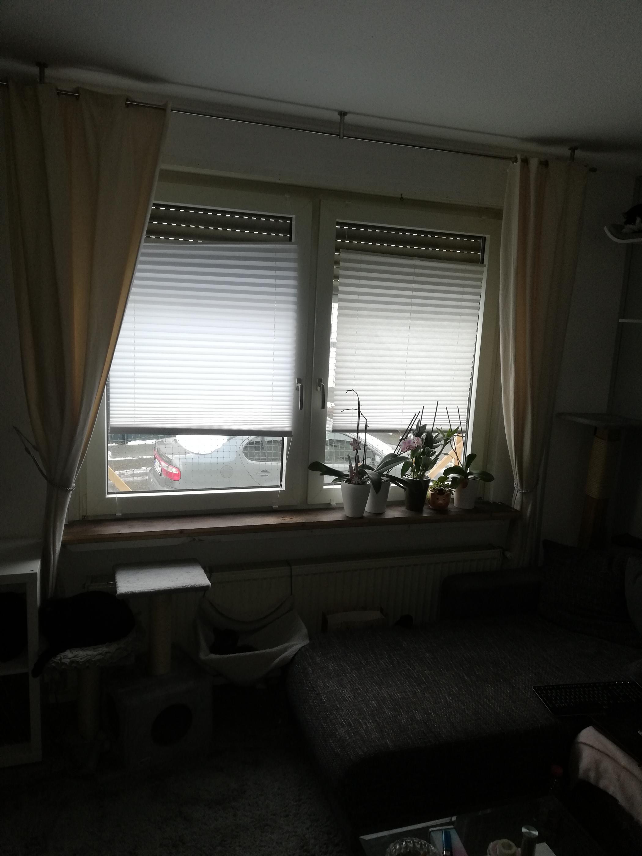

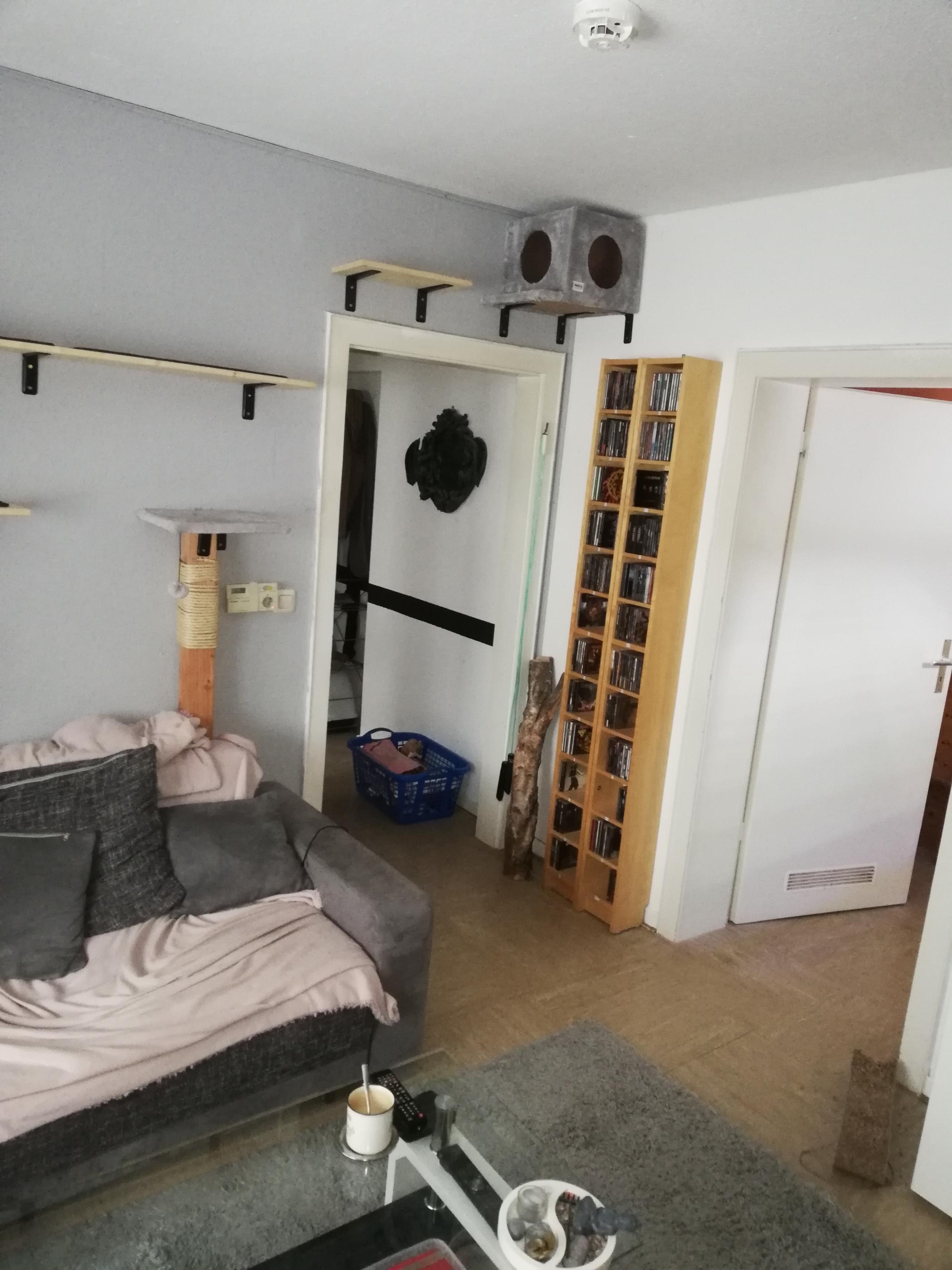

Hey Guys,
thanks alot for ur advise 🙂 I am looking for help and Infos in generally. As u mentioned befor als long as I don't have the exact data about my new room this will be hard to get specific advice.
@graaf ur Tip of the open Wardrobe would be a nice Idea to fight for a bigger room 😀
What I can tell u Guys is the situation in my Living room atm cause I think this setup is a good starting point even the room will be smaller in future. I measured my room yesterday and it's about 20m2 not 25 it is 4x4.8m and 2.43m high. The speakers are placed in front of the upper short wall, from there on the right longer wall is a huge 2m window with heavy moloton curtain in front of them. In the lower left Corner there are 2 Doors one on the short one an the longer wall.
The RS1 Wings are put 1.1m away from the back wall and 0.8m from the side walls. The bass Towers are places in the corners behind the wings so that the bass is good on my listening position. Comming to this point my listening position is dependent to the living room a big sofa next to the back wall but my head has around 0.4m space to se Wall when sitting there.
At the moment I have no big problems with room modes except the one at 110hz. I hear most time to rock and metal music from the mid 80s to now. 80% of them are really flat recorded that the deeper rooms modes are welcome to me personal taste.
I attached some pictures for u to make it owne look of the room itself.
