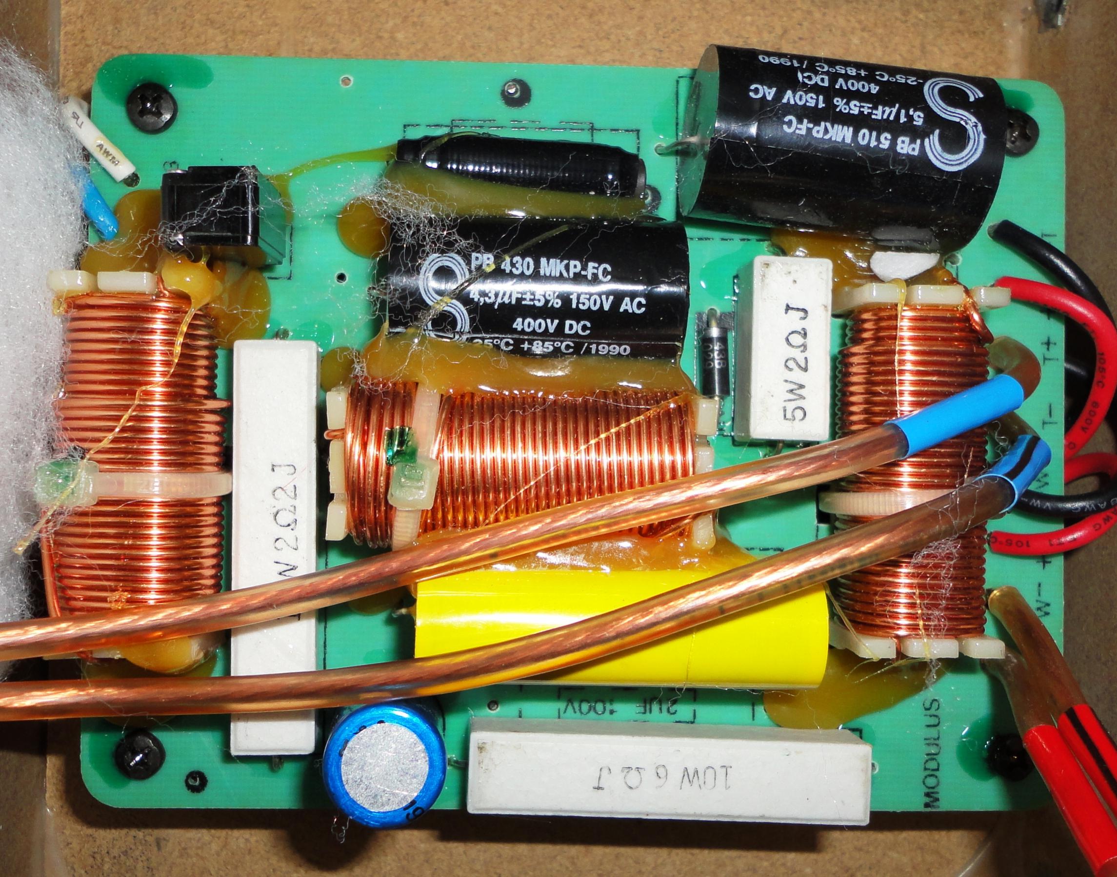

Hello, thanks for your reply. Yes Caps in tweeter are different than in manuel. I am thinking to use both with 4.7uf. Both are in series and have tolal capacitence of 9.4uf. Both Solen used are 4.1+5.3= 9.4uf. Is that ok?
The missing Cap 2uf and some components are soldered back side of the crossover board. Big yellow cap is 12uf 100v.
Would be better to change the yellow aps with solen MKP, electrolytic with MKP and all resistors with Mills wirewound?
I can spend around $300 for all if its really worth. Speakers sound good but I have feelings, with good components they will be great mini monitors.

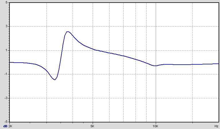

Not that way -those caps are not in parallel, take a look on service manual you've atached.
I've simulated changes in crossover C1=4.3 and C2=5.1 vs C1=4.7 and C2=4.7: you will get drope -1.5dB at 3.2K followed by peak +2.5dB at 3.8K, which slowly will go to 0db at 10K.
Afraid that with better caps you will do downgrade to the sound, as in this case small changes in values have big impact on responce.

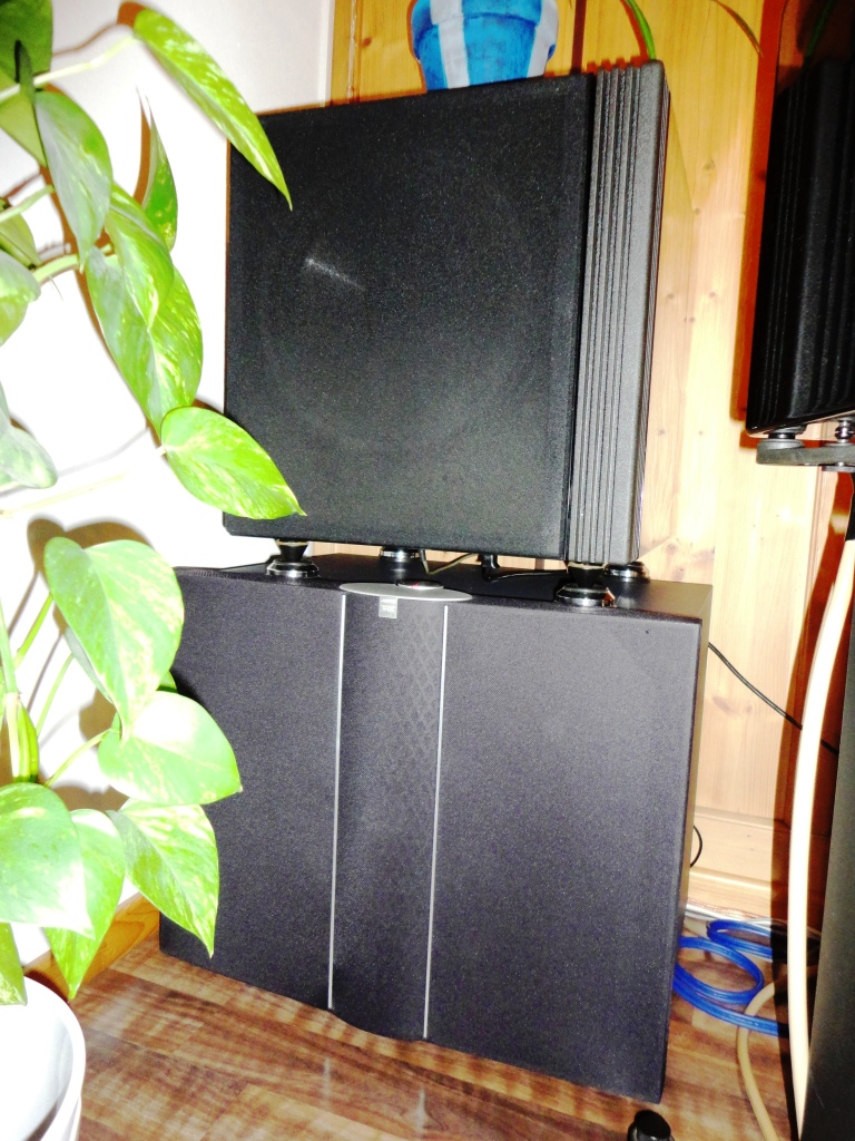

Here are the pictures of my Infinity Modulus with original Sub-woofer.
Nobody have any suggestion what can be optimize for this little babies 🙂 🙂

Hello Xjr100, thanks for your response. You mean the response of the tweeter will be different if I use 2 4.7uf caps?
But if the Emit is crossedover at 4000Hz in Modulus as states in manual, will it still make difference in final sound after using 2 4.7uf as you simulated? Will these caps will modify the sound of mid-woofer response as well?
Yes and no: more exact say is that speaker responce will be different, as at crossover point sound is summarized from tweeter and woofer. It does not mean that woofer stops playing at srossover point and then plays only tweeter.
If you do not have measurement microphone it is better to keep same values of caps. Search forum and there will be some links to measurement software and equipment - it will seriosly help you.
Hello, the exact value of these capacitors 4.3uf and 5.1uf are dificult to find.
In tweeter crossover manual they have two caps each 4.3uf. Why they used one 5.1uf? I must open the other speaker to see if both have same value capacitors or different.
I will definate check the speaker response with mic before and after upgrade. If it will not work I can still use the original caps.

sheraz80, I suppose that Infinity engineeres were tuning crossover, maybe values of coils are also different. Or it could happen that some changes were in speaker drivers - it happens that batches can slightly differ in parameters and speaker manufacturers apply some changes to crossover to get same sound.
For 4.3 you can use 3.3+1uF in parallel, and for 5.1 - 3.3+1.8 in parallel to get exact values.

Can you please tell me which of your caps in tweeter schematics is close to tweeter? If I look on original manual where both are 4.3 - which one is 4.3 and which one is 5.1? It is important.
About non-polar 16uF: I wouldn change it. Just measure it that it is still 16uF (almost sure that it is OK, as I had old Technics from 70th and there electrolytics were OK)
