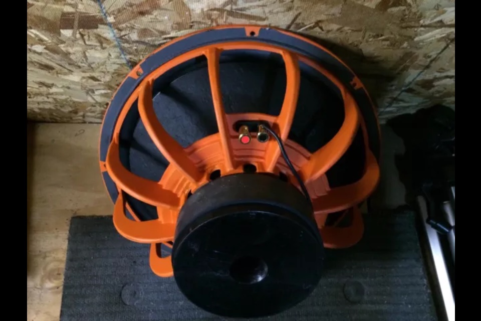

I decided to try this custom driver from James Louddpeaker because ot was used in a similarly sized cabinet, with a passive radiator, with similar frequency responce. I know that does not ensure success, but it seemed like a good guess on a custom driver for a good price.
I was also able to pick up the matching plate amp to that James Loudspeaker driver, which is rated at 1500wrms. I know the amp has some tuning built in around 35hz to minimize a peak at the woofers resonent frequency, but I also believed it has some additional gain down to around 18hz to keep the response flat. Since my HPS1000 amp has developed a hum (grounding cold solder joint issue I think), I'll try putting this amp in with the new woofer and see what I get. Once again, I'm not sure it'll sound better than stock, but it may work based on the design of the two subwoofers, and it'll be a fun experiment either way.
Received the woofer in the mail today and the seller through in an additional basket. Seems to be really well made, and I'd be interested to know who made these drivers for James Loudspeaker. Very stiff carbon fiber cone and dustcap, tall foam surround, cast basket, stiff spider, and very large magnet. Driver has dual, four ohm voice coils, so wiring it as one eight ohm or two fours provides two amp friendly options. Ran the driver through some frequency tests unboxed last night and it seems to react well, so appears both mechanically and electrically sound. I'll start pulling apart my HPS1000 and see what modifications I'll need to fit this woofer in the cabinet.

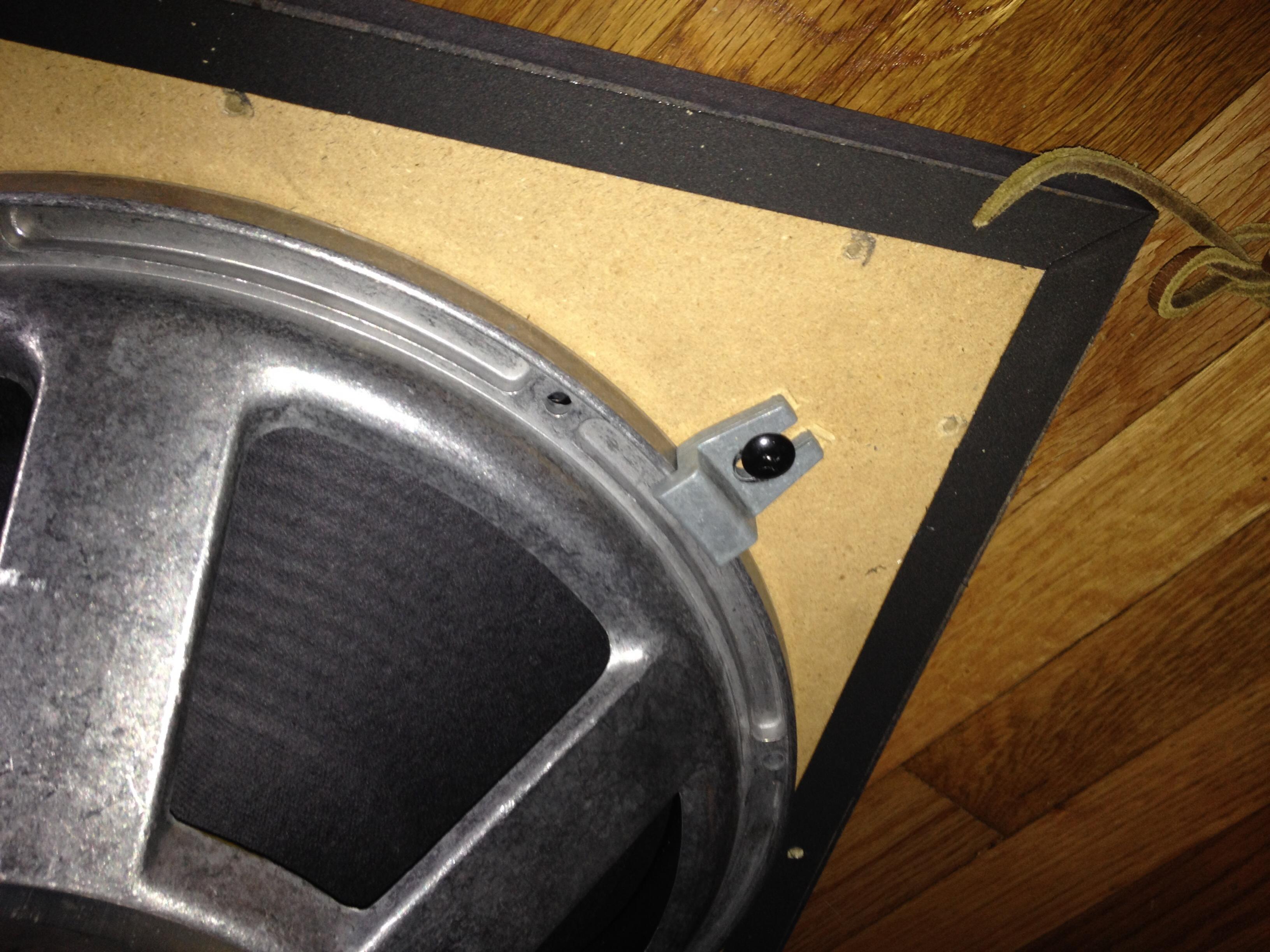

Pulled apart the HPS1000 today to install the new woofer. Once I removed the feet, and pulled all the screws out of the bottom, the 1" MDF baffle was able to be pulled out. The stock JBL woofer was mounted with four screw-down clips, and the stock grill (cracked from age) was sandwiched between the baffle and the woofer basket. The stock woofer is a cast basket, and appears to be a custom build of a pro style driver; it was much heavier than I expected with a substantial magnet.
The new woofer mounted very easily in place due to the screw-down clip; with threaded inserts even! Clearance was now problem, and I only had to extend one wire lead since the stock unit had both connections on the same side.
