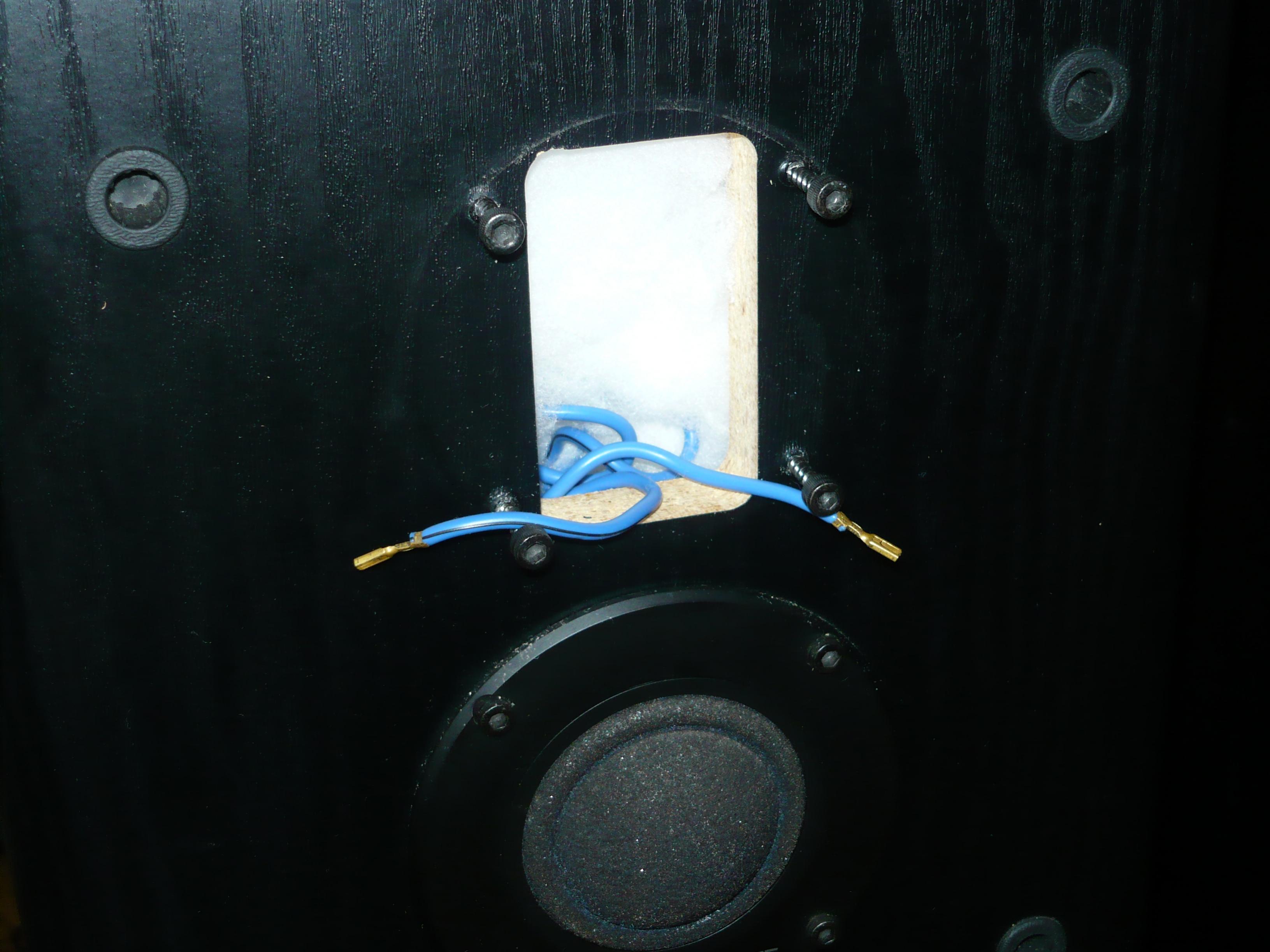

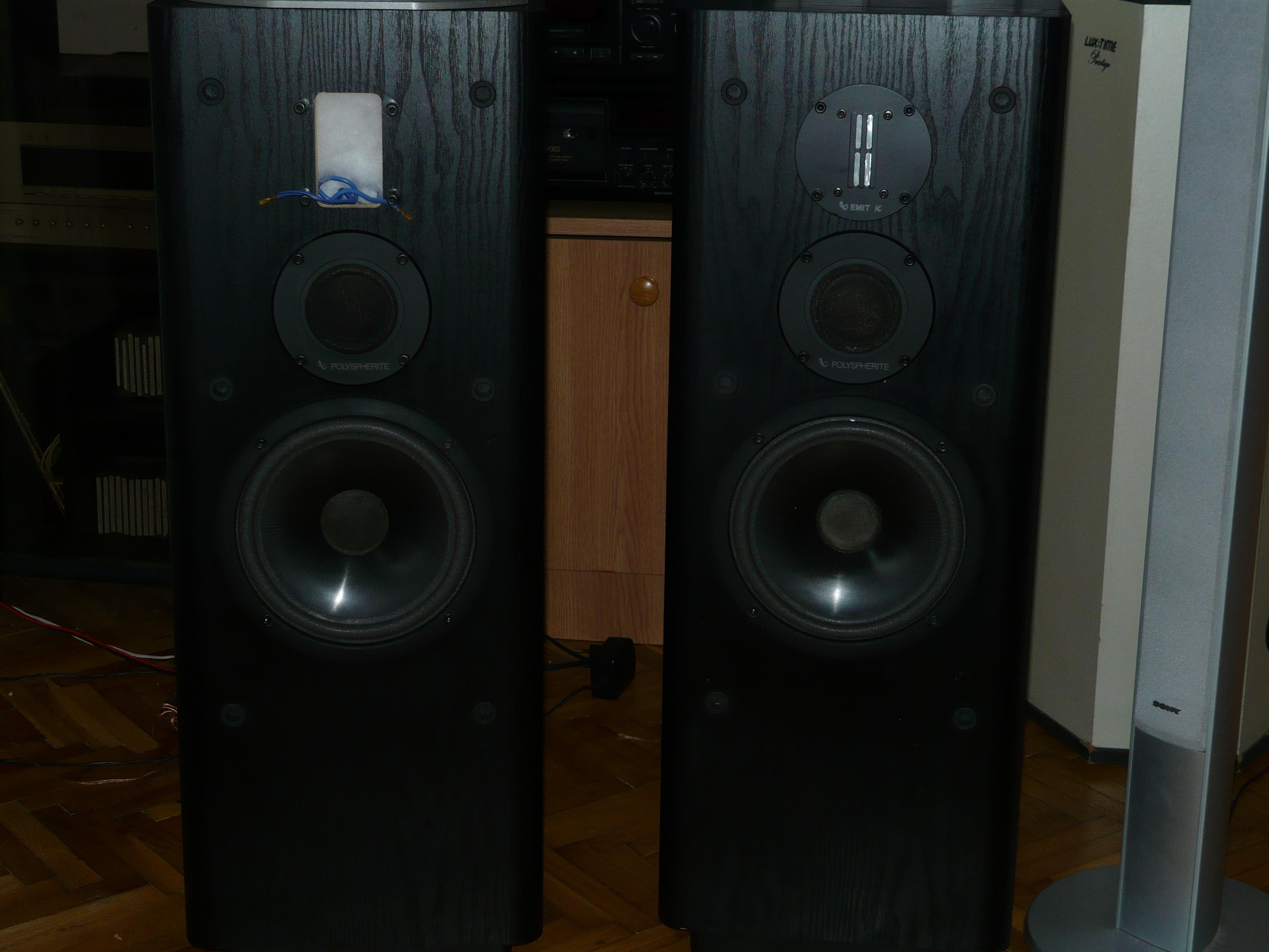

Here are some pics so that makes this entire thing more fair.

Oh, got it now! Scared me alittle so that these are exotics! Ok, the RBT-95 has sufficient space to fit in, so had the Emit K. The crossovers realy do not have tocome out no? If yes why? For the 4500hz necesary minimum crossover acceptance of the RBT-95 than the 4300hz stepping of the Infinity crossover? Say I wont be able to get the measuring kit with 1m microphone, what should the resistors choosing criteria be expanded, what shall I do to get theyr power equaled to the Emits in these units? The magnets of the RBT-95 fit very well in these bodies as they are the same size. Much sealing won't come in question cause I'll put a flange underneath so as under tweeters on normal speakers an that will absorb much of the vibration. I will allso apply some thin sponge like sheet on the bacm of the magnet to absorb much of the coming pressure from the bass of the woofers. Anything else? Am I forgetting anything?
If you have a pot on the back for tweeter level simply fit them and use it.

But how will I deal with the crossovers not to burn the TWs cause they are 5000hz requiering for xos and Infinity are 4300hz step-up xos? How about power are they close one to another?
With more attenuation and more power handling they will be fine.

Your post in another thread indicates tweeter level adjustment is very minimal.
You will need a L-pad on the tweeter to bring it down to nominal level. What
L-pad you need is hard to say as reported sensitivity is 93 to 98 dB.
