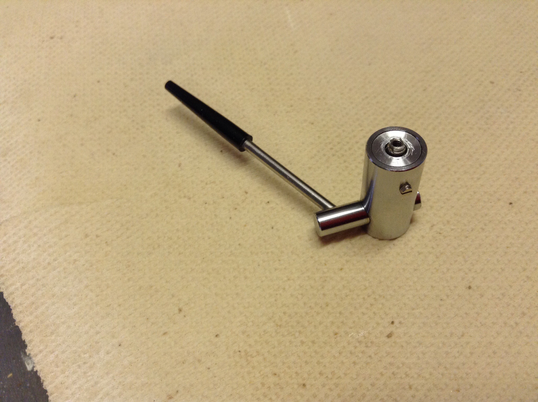

I have to repair the lift mechanism on my Black Widow tonearm. The silicone fluid has leaked from the cylinder. Anyone have insight on dis-assembly of the lifter mechanism?

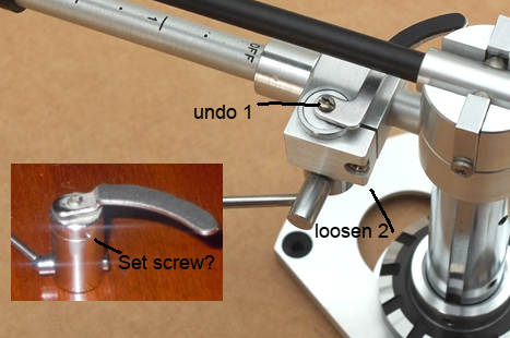

2/3 down this page l-07d repairs they tear down the cue which should be similar to your which looks like a jelco

it might unscrew like this

If only it was that simple! The Black Widow mechanism has no visible top or bottom, just a one piece cylinder. The bottom is a black plug but is recessed so prying out would make a mess of it. I have removed the set screw, the piston will rotate, but not pull out. Any other thoughts?

However, on my Sansui SR525 the cue is built the same with no recognizable way to disassemble. It dropped like a stone. Here is what I did..... your mileage may vary.
-remove the set screw on the side. It very likely just mates with a slot in the side of the piston so that is doesn't rotate. It doesn't actually lock anything.
-re-attach the rest/bar at the top that the tonearm rests on.
-Squirt silicone into the hole where the set-screw was, make sure your aligned with the groove on the piston.
-use the "rest" to spin the piston in order to spread the silicone.
-you will have to work it in the up and down positions.
-you may also have to soak the whole unit in alcohol or lighter fluid to clean out the old silicone. If you do, make sure to let it dry thoroughly.
The first time I tried it there was air bubbles that would pop. It's important you realize that the silicone is not a reservoir in the bottom, it's just coating that binds the friction between the piston and cylinder. Hope that helps.
