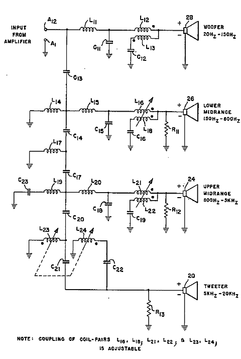

<i>US Patent 4,771,466 Inventors: Modafferi; Richard September 13, 1988
<a href="http://164.195.100.11/netacgi/nph-Parser?Sect1=PTO1&Sect2=HITOFF&d=PALL&p=1&u=/netahtml/srchnum.htm&r=1&f=G&l=50&s1='4771466'.WKU.&OS=PN/4771466&RS=PN/4771466">Multidriver loudspeaker apparatus with improved crossover filter circuits</a>
Abstract
"A loudspeaker system includes at least two loudspeaker drivers, together with an electrical crossover network having filter circuits with at least two separate mutually exclusive frequency passbands. The filter circuits comprising the crossover network each possess brick-wall amplitude responses, i.e., passbands with very high band-edge amplitude vs. frequency response slops, on the order of 100 dB/octave in the better embodiments. The high passband band-edge slopes, which are realized by the inclusion of transmission zeros in the separate crossover filter transfer functions, takes together with further appropriate crossover filter transfer function synthesis causes the separate loudspeaker drivers comprising the loudspeaker system to function independently of one another in their contribution to total system acoustic output. It is shown that the loudspeaker system permits an accurate approximation to the ideal delay function in acoustic space, while minimizing acoustic wave interference among drivers operating in adjacent frequency band, and also reducing overall system nonlinear distortion."</i>

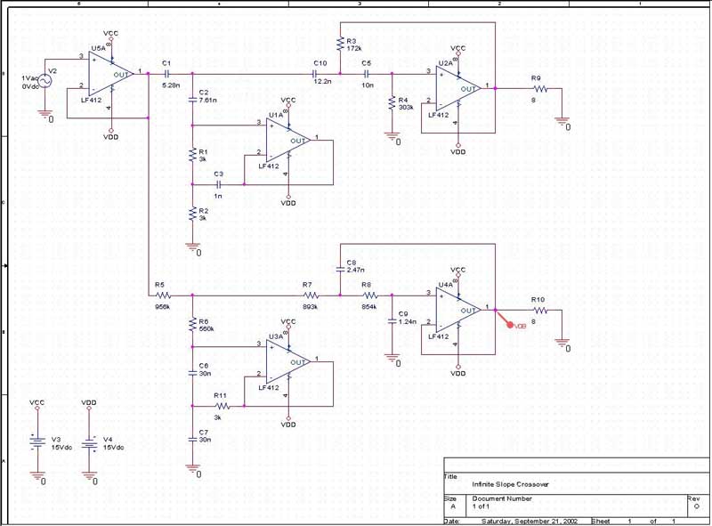

As with all these circuits I'm interested in, I decided to model this circuit in Orcad / PSpice. The LP section works fine, but the HP section claims there is a "node x is floating" problem between C1 and C10...Any ideas?! I have traced it to being a problem with C1 as bypassing it corrects the problem but gives me about a 6dB rolloff! Thing is, at 2am I am having problems seeing let alone troubleshooting!
Thanks...
Gaz
P.S. Sorry about the quality...Had to drop it right down to get under limit!
