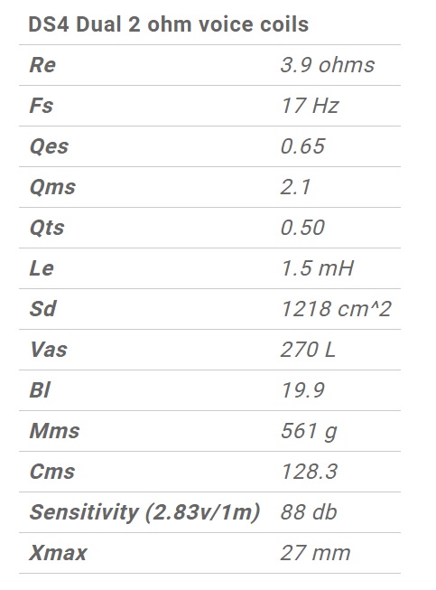

Also, see attachment for the driver specs: Not listed is power handling, which is listed as 1200wrms.

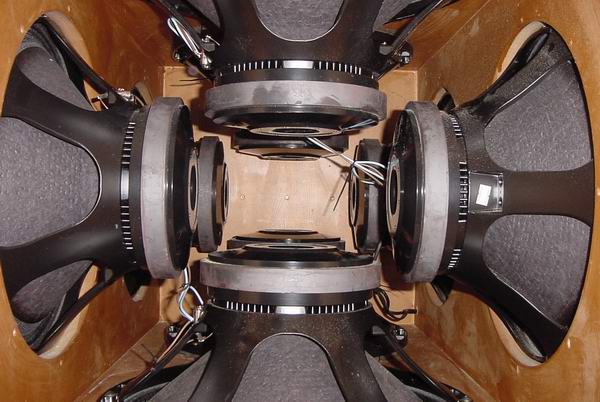

Greetings,
If I am following your thought process correctly, you should be just fine,
The basement is the actual Home Theatre room, and the room directly upstairs of it, acts as the enclosure ? As long as here is an air tight seal, and you provide enough unrestricted air flow (always grand total SD+ ) Deep bass does not care. Congratulations, on doing bass the best way possible. You have an effective enclosure of 1440 cubic feet, assuming an eight foot ceiling in the room above.

Hey thanks Scott, I really appreciate it.
You are correct on all points.
And thanks for the photo. Imagine that the board between the 2 sets of drivers in that pic is 2" wide and 8" deep, that's what I was describing. In my case the drivers will be below the 8" point.

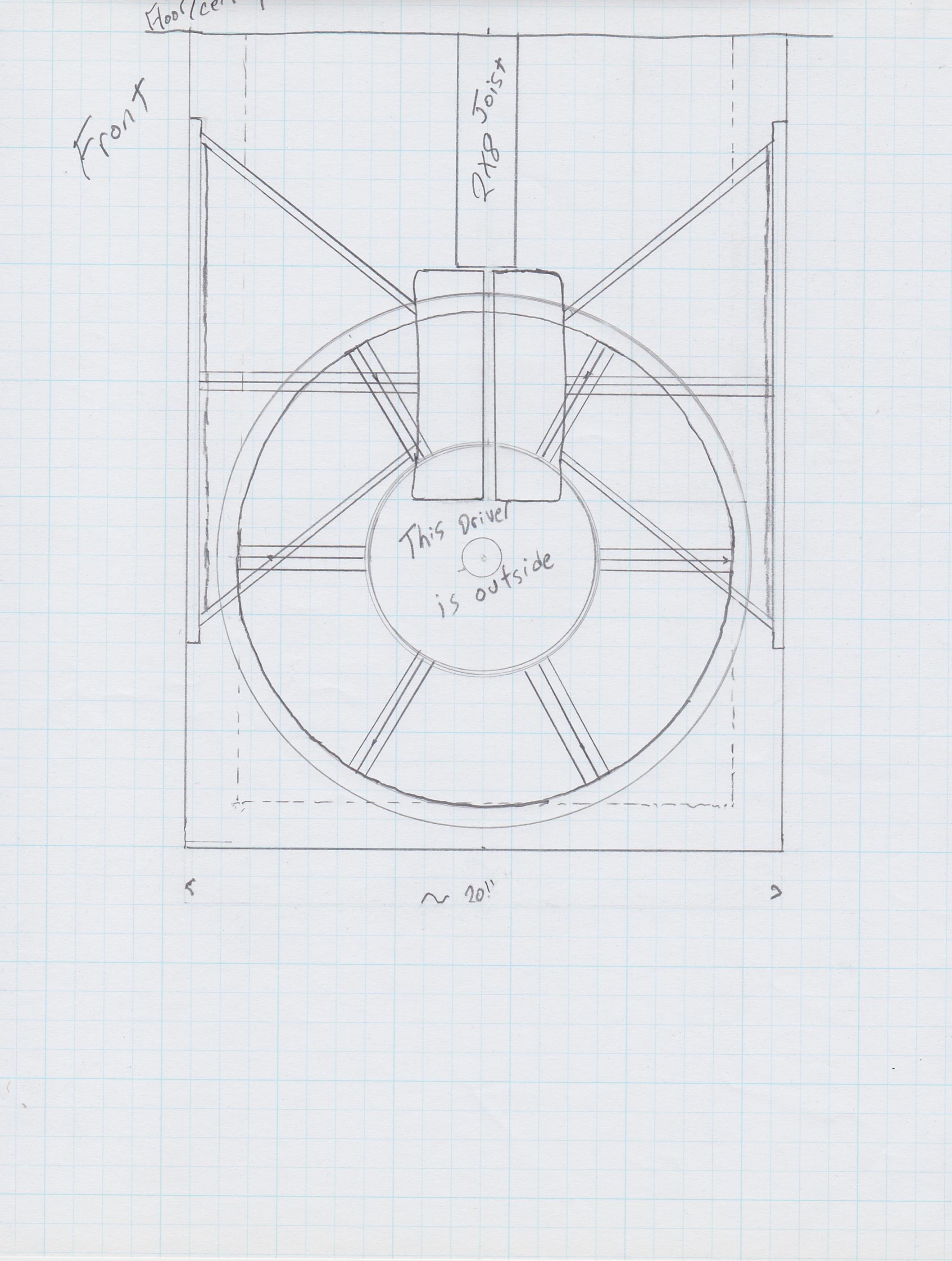

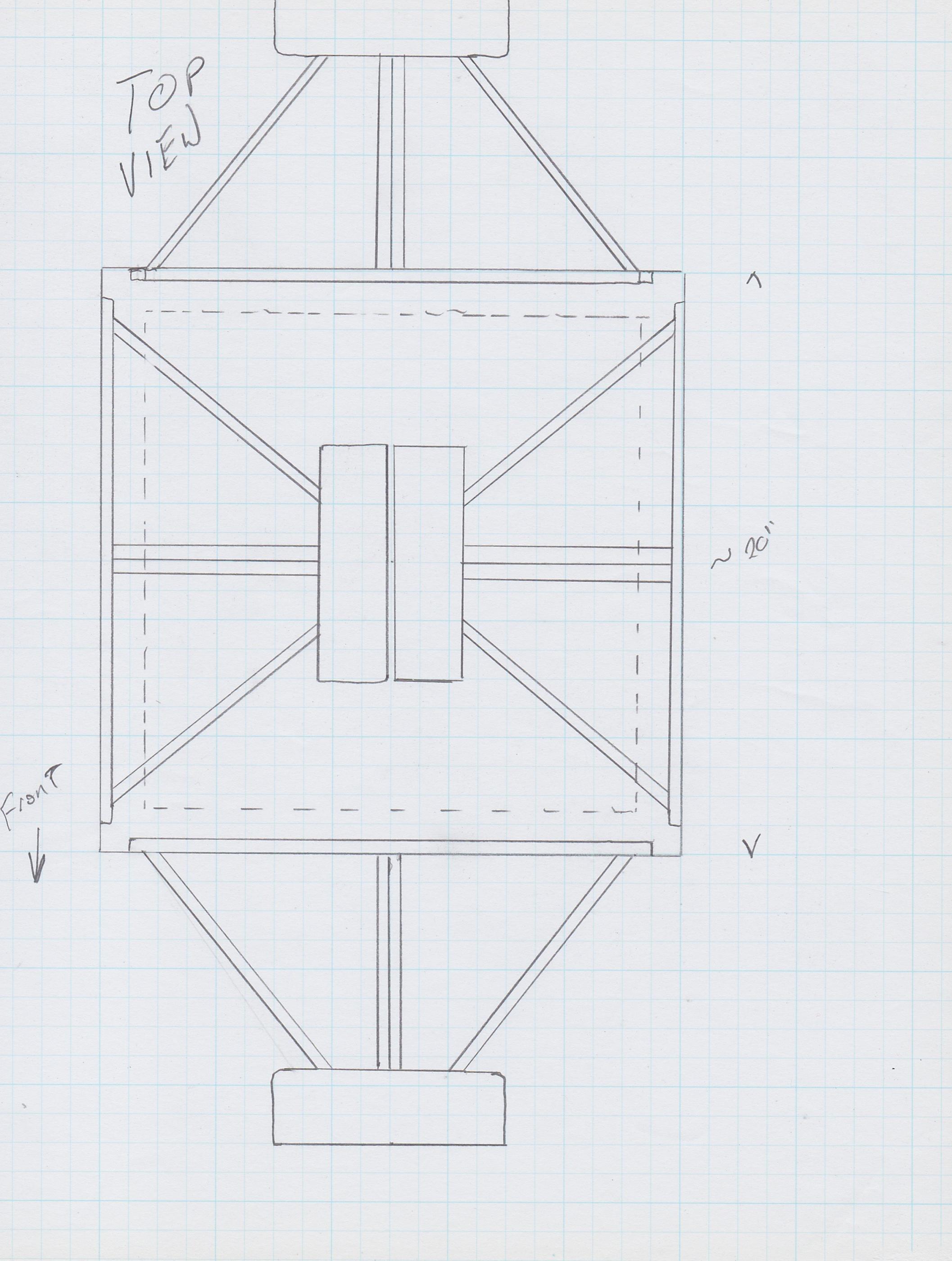

OK, after having a bit of fun at Dr Amar's expense (RIP), back to the project at hand.
I did a couple rough sketches of proposed design, these two are what I came up with first, but I think I might as well place the drivers that are in the box on the same plane as the (optional) ones that will be outside the box in reverse phase.
Anyone have thoughts? Thanks.

I thought you might find this interesting:
Infinite Baffle Subwoofer
Thanks Scott, Interesting indeed!
I was chatting with Thomas over at the IB site, and he stated that the opening I proposed would work out fine, but thought that I should have all drivers outside the box, firing into the manifold for some reason..
Do you happen to know why this would be preferable?
Anyway, I think I'm going to build this thing utilizing 2 drivers at first, just for starters.
My reasoning behind this being the raw specs on these beasts, with 1200wrms power handling and over 2" of throw peak to peak, I think I might be OK.
