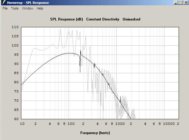

Ok, lets forget the single sub blow up situation.
I want to know if IB will work?

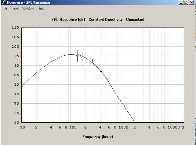

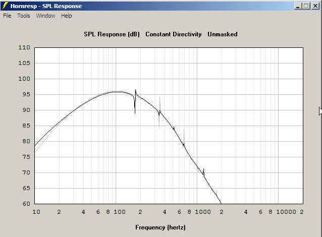

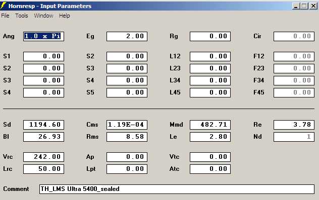

Hi JapanDave,
You can answer that question in Hornresp, basically once you get past 2x Vas the low end gains are quite minimal. I'll attach a Hornresp Input screen and two SPL comparisons Vas 1 v. 5 and 5 v. 10 (you can enter the data for your driver into Hornresp, and get whatever additional simulations you are looking for).

The IB is generally speaking the most fragile alignment when such high power is available as the lack of a restoring force the "box" normally provides is missing. The driver is totally reliant on it's suspension for protection from mechanical dammage. A very large IB array of many drivers could possibly work if wired to limit power.
I think what happened was sort of a rookie mistake. I thought you had four LMS drivers when I "helped" in the bridging... The image of the Sony SACD advert with the rusty sledge hammer and the butterfly comes to mind... I know of another LMS user that crashed 6 at one shot but never really came out on the forum to tell the story. The LMS really needs additional clearance beyond X-max in the motor... 30mm X-max / 48mm X-$$$ as you now know. The thing has 1/2kg mms and a powerful motor 60mm X-mech might not have been sufficient... What's another slice of magnet and a longer pole piece cost on that driver ~$10. But is there 60mm under the bottom spider in the basket??? This would likely lead to another mode of failure the stretched/torn spider. If it's not one thing...
I can say that the end table box I designed long long ago looks like it could help get you into the low teens with some headroom. Looking at the LG web it seems the amp would be capable of 350V p-p bridged 175V per channel, any way you look at it, single driver stereo or bridged into four drivers series parallel the driver is at it's limit. Some feeling out of the system and it's setup/limiters could give you stable results. The amps huge dynamic headroom is uncommon and must be managed with care/respect.
