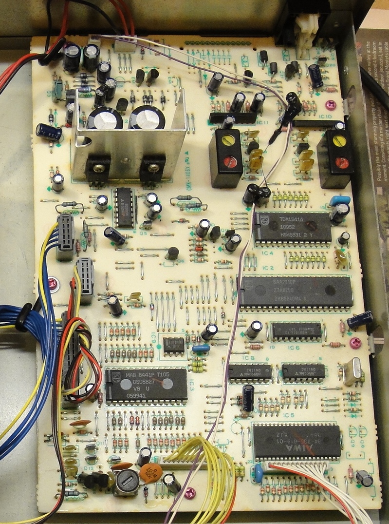

Akai DXM45 http://www.diyaudio.com/forums/atta...e/292274d1342720524-aiwa-dxm45-dxm45board.jpg should be dirt cheap. CDM4/25 mech with Akai servo board, Philips decoder and TDA1541A, no oversampling. Doesn't sound great as it is, but offers the bones of what you need if you fancy that direction. Primitive features and no remote. Manual not free. Steel case. A bit of space inside for power supply additions.
Both nicely, albeit cheaply, made and easy to work on with good quality one-sided boards.
