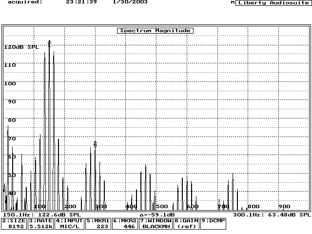

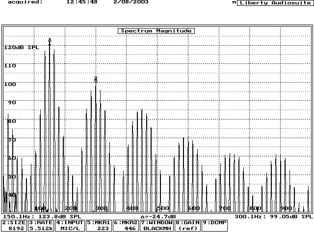

Circlotron said:Now, the question is this - should I expect a very great improvement in performance so that if a very high quality driver was used in place of the one I am talking about, would there be not much difference in results? i.e can I make a moderate quality driver behave like a very good one, at least as far as frequency response is concerned, *over a necessarily limited range*, provided it has reasonable X-max?
Kind of, and not really. Frequency response wise you could get it to do almost anything you wanted it to, given it did not excede it's excursion limits. You've already alluded to that. However, there are some things you can't correct with only frequency equalization. Linear and non-linear distortion will be quite high for even low power levels. I'll post two plots, 135Hz 150Hz and 165Hz IMD distortion measurements for a $12 5.25" woofer and for a $150 world class 5.25" woofer.
First the cheap one...
And now for plot #2
Here's the expensive driver. Remember, only the tones at 135Hz, 150Hz and 165Hz were put into the driver. Any other tone showing up is a distortion....
Now there are expensive drivers that don't do as well as this one and there are inexpensive drivers that do much better than the one I posted above. (There are only a select few I've measured that do better than this guy.)
