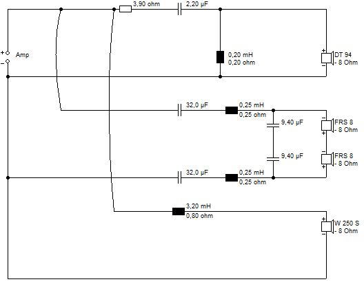

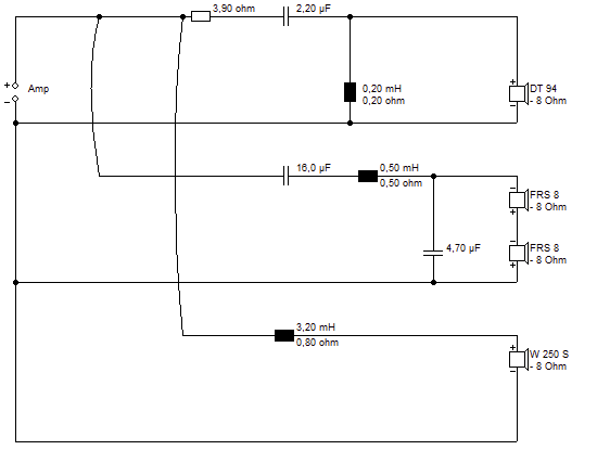

For people who get in a muddle about MT to MTM conversions, it pays to do a thought experiment.
This is a real speaker, the splendid Wharfedale E70 which has twin mids wired in series. In fact the speaker would work with a single mid too on an adjusted crossover with halved and doubled values. But sound different.
Series MTM has the interesting property that although each driver only see half the voltage (-3dB), and hence a quarter of the electrical power (-6dB) each, the sound level on-axis is the same as a single driver due to 3dB gain from twin drivers but a different polar response above and below axis.
The two circuits below are equivalent. You can see what the values would be for a single driver. Ideally you seek a Butterworth BW3 flat power response overall, but LR2 and LR4 are doable, if I haven't gone over your head there.
If both identical drivers are in the same enclosure, of double the size naturally, I think series wiring is better on theoretical grounds. The current each driver sees is the same, so it all works nicely.
