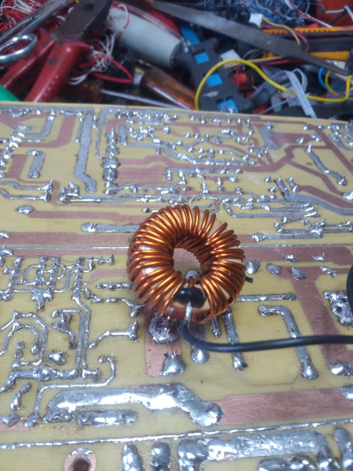

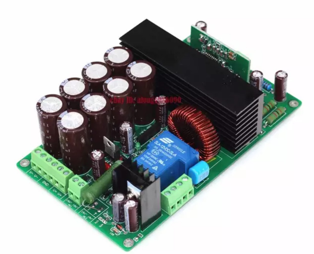

I'm doing a D-Series Digital Amplifier. But in my work there is a pwm going between 62khz-500khz for my frequency comperator. According to this, I tried very different different nüve, but some did not work, some of them worked shortly after the mosquitler burned, and some of the coil began to be like flame.
When I look at the color codes of these cores, the frequency value '' AL '' VALUE writes tut For example, I have to keep the value of 150uh, but I wonder if the escape had caught this value in different values, it could always be a problem?
The last time I used the Toroid Core T157-15 RED - WHITE.
The Buddha started to heat the coil

At least according to the Micrometals colour codes, red-white is material -15.
https://micrometalsarnoldpowdercores.com/pdf/mix/Mix-15-DataSheet.pdf
While it has over double the permeability of the more often used material -2 (red-clear), at least going by the specs in the small table on the top-right, looks like it also has almost double the core losses .

150uH is a HUGE value for an output filter inductor, though......

On my class d amp it is 10uH and 470nf filter.
I used a T106-2 core with about 10 turns on it.
You will need to use quite thick wire to take the power.
The current rating of the inductor is very important. If you wind your own you have to know how to calculate the rating for yourself from the ferrite material data and core-size. Overloaded inductors can overheat the wire itself or the ferrite or both.
Gapped inductors are worth considering, much more stable, although larger.
150µH is about 60 ohms of impedance at 62kHz, its clearly completely the wrong value for any of that PWM range.

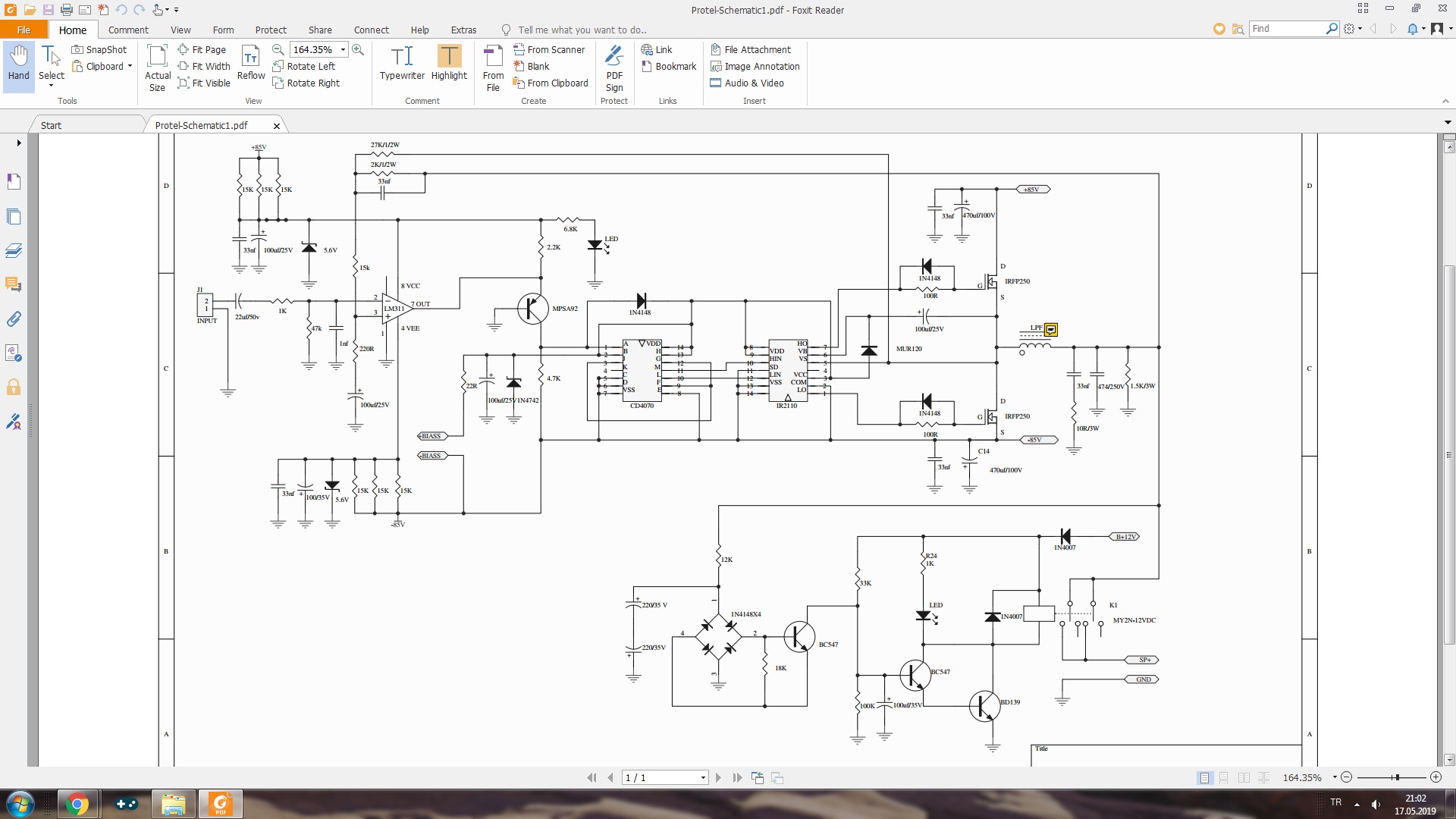

Huge old FETs + (relatively) large gate resistors = SLOW switching times
Dead time is whatever the propagation delays and transition times the CD4070 has (supplied at 12V, that easily adds up to some hundreds of ns).

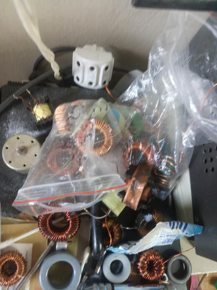

where the coil 150 is working with almost no heat with a gray core. No problem. However, the red white Amidon t157-15 cores and 140 uh worth the flame is like.
22uh coil and red-gray mosquitos are burning right.
How many turns on these? The T157-15 is 360nH/turns^2. What guage of wire?
Unless my math is totally messed up, that works out to a whopping 466uH 😱
360nH * (36 * 36) = 0.36uH * 1296 = 466.56uH
Then again, checking the datasheet, that "360" is actually expressed in uH/100 turns, which changes things a bit - that works out to 36nH/turns^2.
36 * 36 * 36 = "only" 46.6uH
So, interestingly enough, the value is more "terrestrial", but the material may well still be unsuitable for this application (especially at those supply voltages), given its nearly double core losses compared to the -2 material.

That, and the OP, at least according to the schematic attached to post #5, is trying to use this with +/-85V rails.
