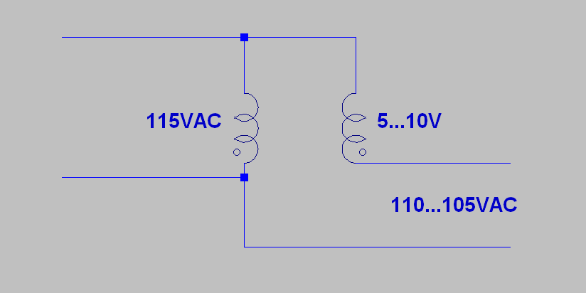

since you only want to reduce the voltage only by 10% the best non-invasive method use a "bucking' transformer. you can use a smallish filament transformer rewired to drop the primary voltage.

If for some reason you do not want to mess with all that stuff: find 115V to 6-12V / 4.5A+ transformer, connect it like on attached pic.

I don't like "bucking" either.
That implies connecting the extra turns out of phase to REDUCE the output voltage. But that brings with it a lot of extra copper that makes regulation worse and increases heat inside the transformer.
It would be a lot more efficient to remove secondary turns because that is what "bucking" does, it electrically removes the effect of some of the existing Turns.
The auto-transformer can be used to efficiently transform upwards, or to transform downwards.
It just depends on whether the primary side uses the extra turns giving a reduced output/secondary voltage.
Or when the extra turns are in the secondary, one gets a higher output voltage. In this case the mains is connected to the original primary.
No need for any "bucking".
