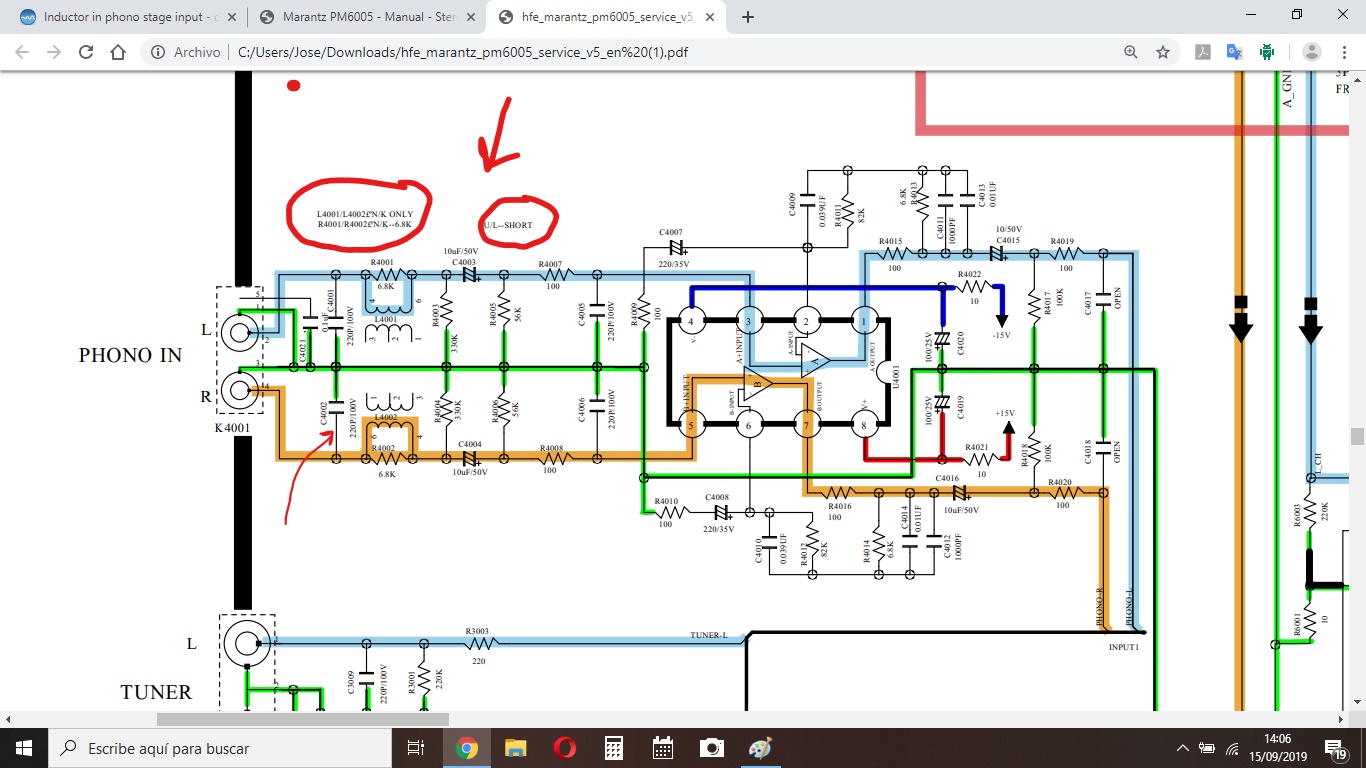

I have not found the circuit of the phono stage of the Marantz PM6006, but I have seen that on the circuit board there are some inductors, one per channel at the phono input.
I found the circuit of the phono stage of the Marantz PM5004 and I see that these inductors are at the entrance of this stage. I also see cartridge loading capacitors. I think that if I remove them, using only the capacitance of the cable, it will improve that accentuation in treble
I would like someone to explain what function the inductors fulfill and what effect they have on the frequency response.

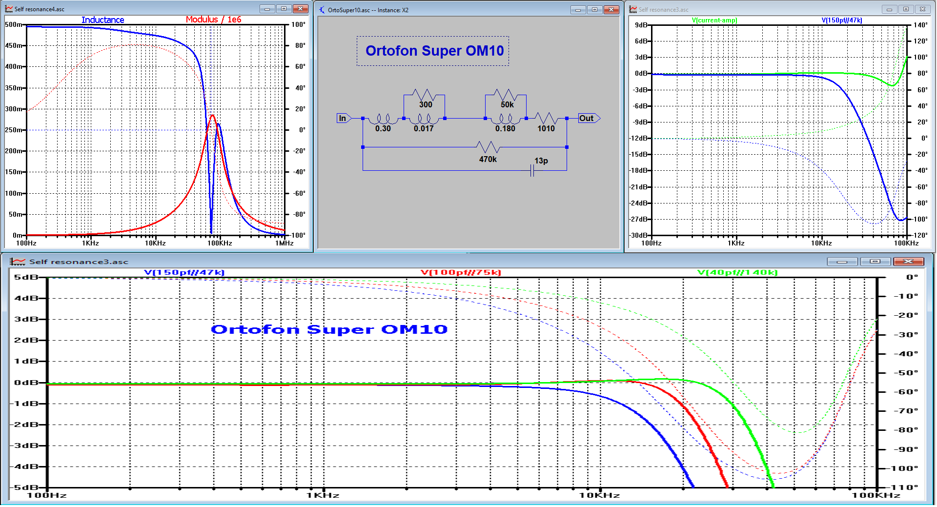

The electrical model of an MM is MUCH more complex than most people use though. Hans and George have measured this.
Glad you said ortofon as Hans measured one of those. Attached is his raw measurement, equivalent model and some loading examples. This is JUST the coil being measured and an end to end measurement still needs to be done. Now for this model (super OM) Ortofon give a bit of a barn door to aim at with 200pF-500pF recommended. Loading at 47k||150pF in the simulation as you can see gives an electrical roll off of 2dB at 15kHz so you can see that a higher capacitive load would be a way to reduce that. In fact a different resistive load does a far better job as can be seen.
This is by no means proof as there are missing measurements, but it's a pointer that this oft repeated statement about MMs having a mechanical roll-off might not actually be the case. Hopefully before too long we can get the missing measurements and make some progress.

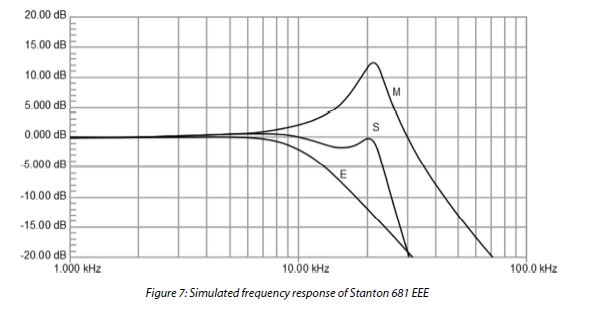

I've not seen measurements that isolate the different aspects, but would love to find some. There are some compelling analyses, for example the attached from a paper Steven Van Raalte did for linear audio (diagram attached with permission from Jan who is a good egg 🙂 )
This shows the electrical roll off from the generator as 'E', the assumed mechanical resonance as 'M' and the combined output as 'S'. This fits some measurements I have seen so it would be easy to say case closed. Luckily there are still a few inquisitive types like Hans and George who will do measurements never published before.

Hi. Tinypic has removed all my schemes and simulations that I have published.
Reading the post published by Billshurv, I understand the mechanical compensation with the electric in the magnetic capsules on the high frequencies.
However, for example in AT 440 Mlb, a load of 47k and 100-200pF is specified.
These 100-200 pF are already in the interconnection cable.
Because Marantz adds 220pF + 220pF in the circuit.
I would add more than 600pF which for the AT440Mlb would be more than triple the capacitance.
I also saw in the diagram that the inductor and resistor at the input, for certain models they have to be short-circuited, which indicates that these elements are to meet certain standards of some countries with respect to EMI. But they surely affect the sound result.
