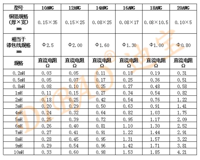

The copper foil inductor has DCR with 0.54R vs the stock one that has 0.6R

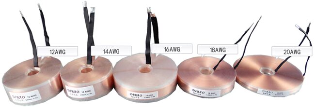

To use iron core coils above the bass is much more expensive and air core coils have lower distortion. It is reasonable to use them there. In the bass range the iron core makes often sense because a big air coil will have higher Rdc or needs a much thicker wire, which makes it more expensive.
