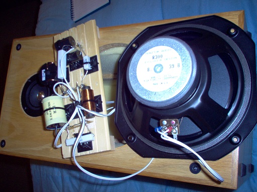

I've been told to separate and right-angle-mount crossover inductors because if one doesn't do so, they act as transformers and couple each others' signal.
Has anyone ever encountered or heard of any such coupling happening between inductors and other components such as wirewound resistors or film-foil capacitors? If they can make an inductor with film and foil it makes sense that a film-foil capacitor could act as an unintended transformer winding as well.
My crossover frequency is low, so the parts are pretty big.
Thank you kindly.

And oh by the way, the major issue at hand is placing a big wound capacitor right up next to a big wound inductor, perfectly as if you were deliberately trying to make a transformer...
It would make the board lay out nicely but if it's a performance problem then that's not what I should do.
One of the many tests I ran had a large capacitor oriented right through the middle of an air-core inductor with the inductor "energized". Results? The capacitor didn't care one iota.

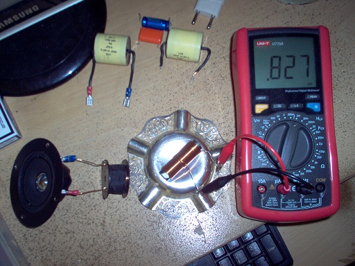

It wouldn't be good to mount a capacitor within a coil IMO, for the reason that wolf-teeth mentions.
But the worst components for interacting are inductors.
They interact with each other and a circuit board. Below is an equivalent of a 1mH coil mounted on a ground-plane circuit board. It not only interacts with the circuit board aka ground-plane (silver ashtray) to reduce the effective value by about 20%, but sends an audible high pitched whine to the tweeter filter unless you mount coils at right angles and good distance. I am using a sophisticated Multimeter with an inductance (mH) scale. You should possess one IMO.
I should mention that an inductance meter works by sending a 1-2kHz test tone to the component and calculating the back emf, which is what you hear through the cone tweeter in this case.
For this reason, I use point to point wiring and right angles and distance. 🙂

Well, yeah, but my concern is that everything on the circuit board is pretty much an inductor. The wire wound resistors are built exactly like inductors, just more spaced out. The capacitors are built exactly like those highfalutin' foil inductors. If you didn't know what the parts were called and you looked at them with your x-ray vision, you'd think that they all did the same thing.

But the wound coils are inside a metal can. They should be oblivious to an external field.
The inductor coil will not be oblivious to a metal can inside it's coil. Just about every body, with audio design credentials, advise strongly against leaving metal inside an air cored inductor coil. Iron and nickel would be the worst offenders, but all metals will have at least some effect.

I don't particularly recommend mounting a capacitor within a coil, but some people, like Wolf, end up with crammed crossover assemblies that must be mounted inside a pretty small box. According to the tests I ran, most capacitors will not be bothered in the least if mounted in the middle of an air core inductor, and Wolf's comments indicated essential agreement with this (in fact, I ran those specific tests at Wolf's request).
I'm not sure of the importance of your ground plane test as described below. I don't think many DIYers use copper-plane circuit boards for their crossover assemblies but do use point-to-point wiring and as much distance as available between components, as well as appropriate component orientation.
I will repeat my position: if you have the room, spread out inductors as far as you want, even orient them at right angles if desired, but the practical reality is that a 2-inch spacing between the coil perimeters of air-core inductors all laid down flat is completely acceptable, and there are likely going to be far larger problems to worry about from an audibility standpoint in a speaker design.
