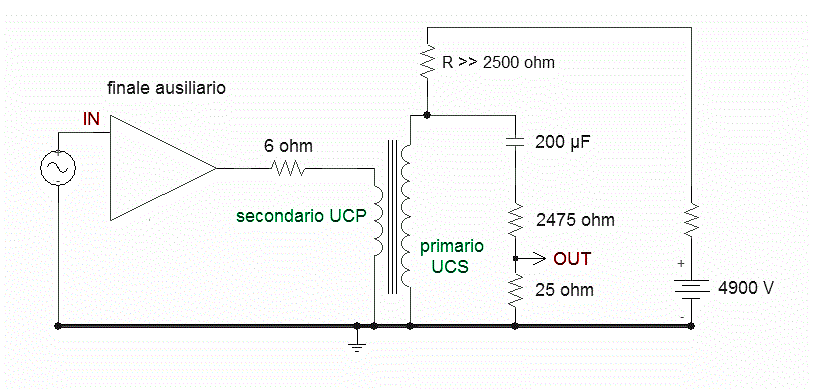

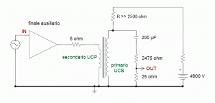

You can measure exactly the L and frequency answer with thd vs freq ( if you have a right test set) In the picture there is specified the load of 6 ohm driven by a ss amp On secondary ( primary in the real circuit) there is 2500 ohm This because the dut has a 1:20 ratio You have to arrange for your needs In this way you have a big swing on the primary Th OT trafo is a reverse stuff and this is the perfect test You can omit the current source for I bias without any interference on measurement I will resend the diagram done with and without bias current

If you want to measure the specs at 1 watt on 8 ohm and the OT trafo has 1:20 as ratio you need on primary 56 vrms and it is not easy. From 20 to 20 khz (minimum) Then the primary must see a reasonable load similar to an Rp of the tube Only in this way you can check the real performance

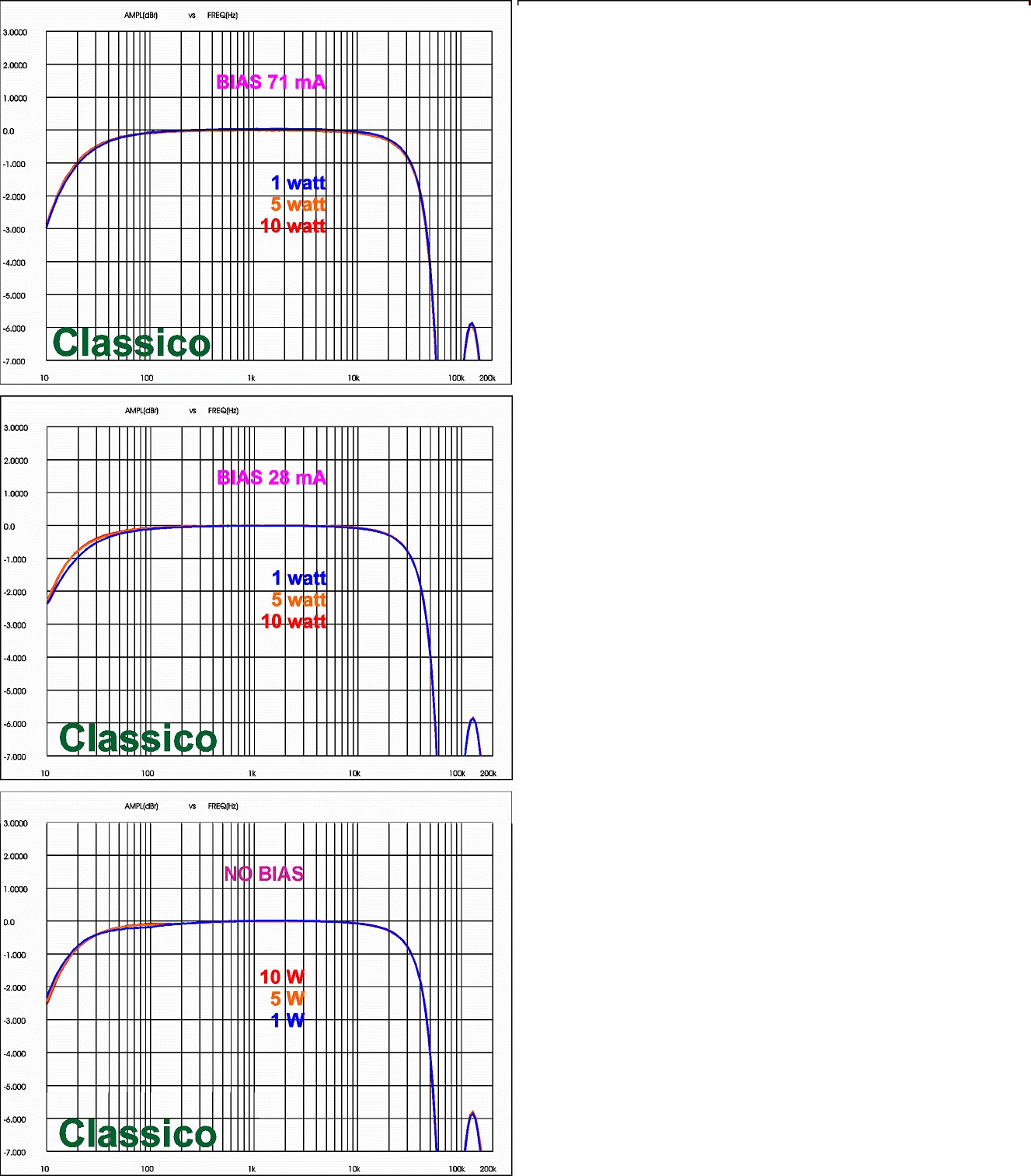

Hi
in attached some diagram that I sent here time ago.
As you see there are different freq. answer from test set I described before also with 0 mA of bias.
They are a test related only to the trafo without the tube.
With the tube they may be different considering the internal charatherstics of each one tube used.
In this way you can have, with proper instuments, exactly the L of the OT trafo

to Celsius In my opinion the first step is to understand which kind of trafo you have. Then you can test the entire amp. The problems are two, as you know The L at low frequency that became low mainly for the core and winding and same happen for high freq. due to parasitic In both case the frequency answer decrease and ( more important ) the Thd vs freq. also increase This because the tube can't delivery the right current due to the non appropriate coupling at the ends fo the spectrum. If you have exactly in which way the trafo is running you can understand what happen with a specific tube.
