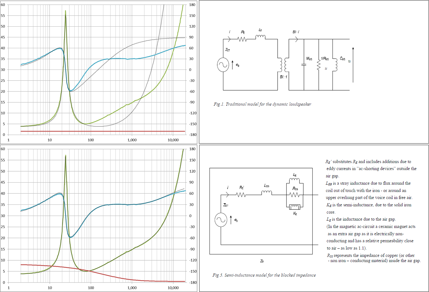

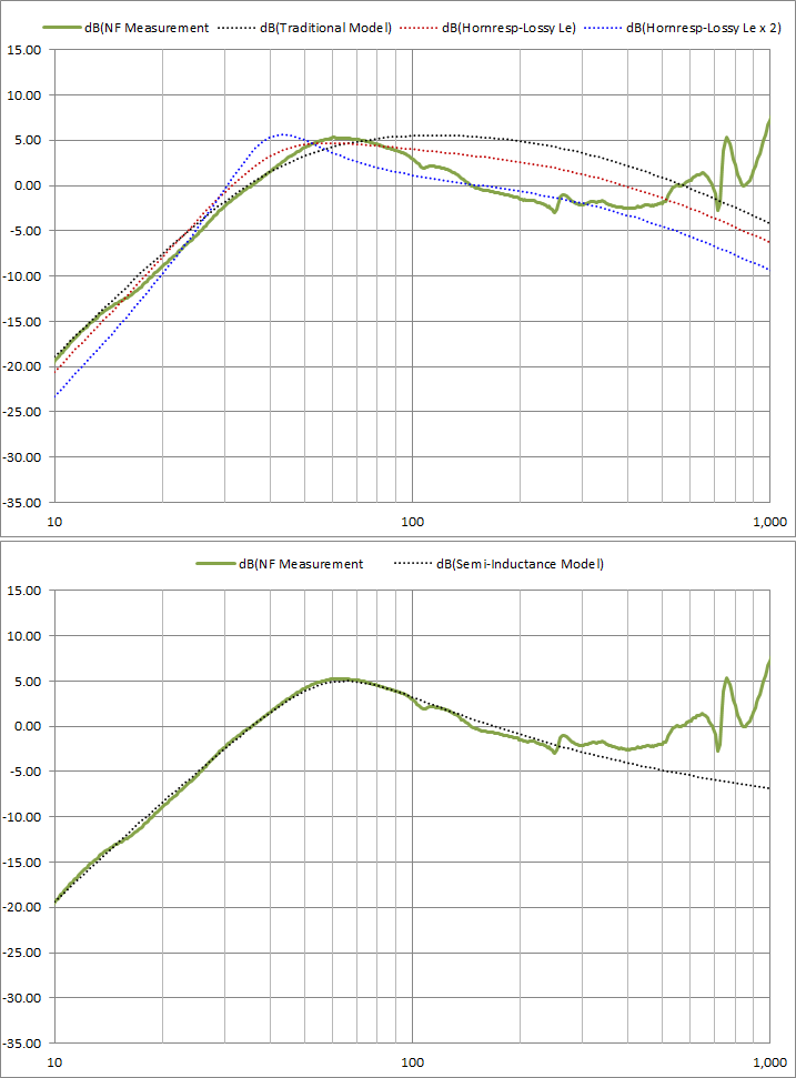

As an example comparison of the semi-inductance model with the traditional and Lossy-Le models, here is a Dayton Classic 12” woofer in a 64Ltr sealed box I measured/modeled late last year. The traditional model shows the expected response for Qtc~0.7. Of course this looks nothing like the measurement which exhibits the undesirable “inductance hump”. You can see that the Lossy-Le adjustment used by Hornresp does move things in the right direction, but the curve shape is not converging on the measured response. Just for grins, I added a blue curve with double the recommended Lossy-Le adjustment to see the trend of how the shape was changing with BL reduction.
I think the response from the semi-inductance model speaks for itself. Not perfect, but quite an impressive improvement in match with the measurement. The fact that the model has matched measurement for a wide variety of woofer types is a good indication that the dominant electro-magnetic effects of semi-inductance, shorting rings, air-gap width, and under/over-hung voice coils are being captured properly. In my opinion, well worth the cost of having to keep track of 3 additional parameters.
The second pic shows a comparison of the measured free-air impedance vs. the two models. The red curve at the bottom of the plots is the inductance of the blocked impedance model. Notice that for the semi-inductance model the inductance is 1.6mH at 1kHz(same as for the traditional model). But, it is 5mH and rising as frequency gets below 100Hz. This is due to the skin effect in the iron core. A simple way to think about it is that as you go down in frequency the magnetic field from the VC penetrates further into the iron core. So, the inductance increases as more and more iron is effectively added inside the VC.

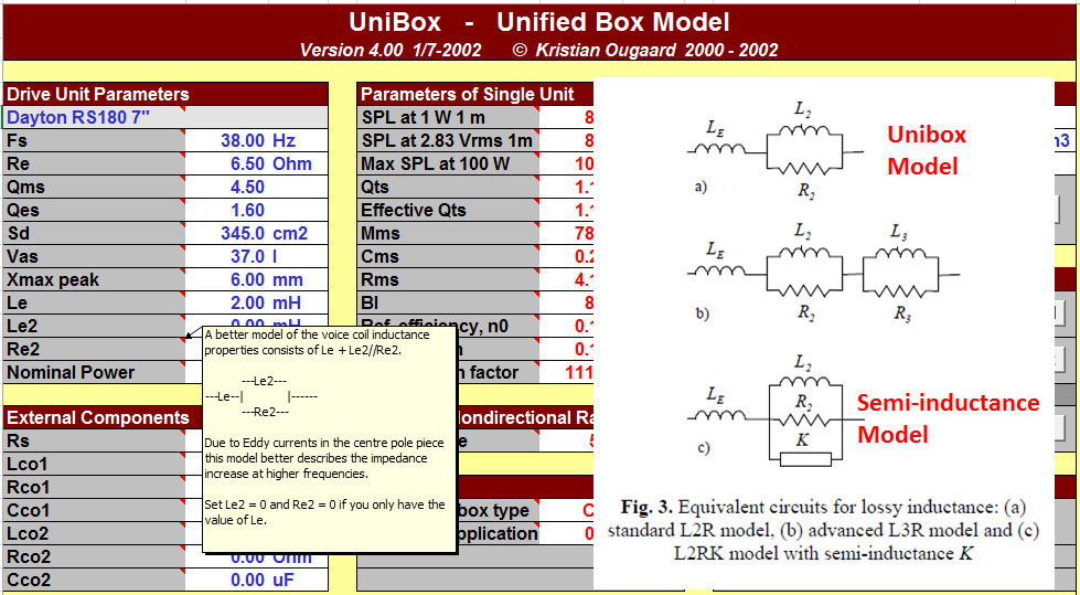

…Perhaps I should recommend that people use this model if they have Unibox and can obtain the necessary parameters and only need to sim sealed or ported boxes.
Unibox does contain an additional [R||L] term, but unfortunately does not include the semi-inductance parameter needed to properly model the LF behavior. BTW, Unibox also models 4th order bandpass enclosures, although now that I think about it the port “transmission line” model is in error similar to WinISD.

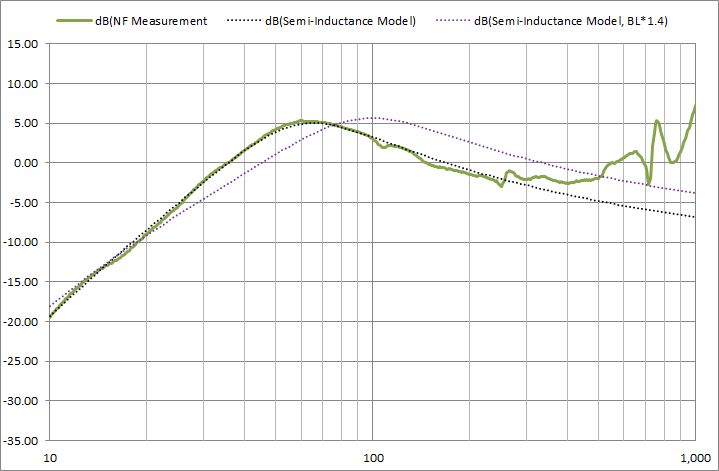

…make the motor 10, 20, 30, maybe even 40 percent larger to overcome the lossy inductance losses.
In case you weren't aware, simply increasing BL will not overcome the effect of the semi-inductance on the response. The shape of the response is mainly coming from the electrical filter effect of the inductance on current thru the voice coil, not from the motor being severely underdamped. Bumping up magnet strength by 40% in an attempt to compensate for what looks like an underdamped woofer will not have the desired effect. If the blocked impedance remains the same the response shape will stay roughly the same, but appearing to shift to the right. Basically you will gain output above resonance by the expected amount(~3dB), but lose output below resonance because of overdamping. (see attached example)
