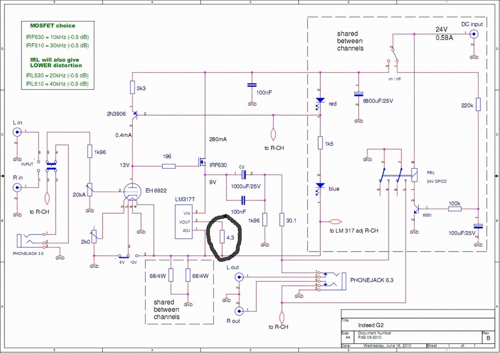

Would appreciate help to diagnose / repair a "bonehead" move I when modding an Indeed G2 single 12AU7 head amp. These have been around for years and sold under brands Indeed, Little Bear, and Bravo.
I was attempting to change the Vout resistance from the LM317 from 4.3R to 5.6R.
The original circuit uses two resistors in parallel to achieve 4.3R.

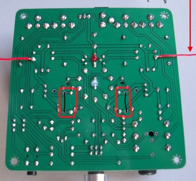

Instead of just removing one of the two parallel resistors and replacing with one 5.6R, I replaced one of the resistors with a wire link which resulted in a dead short. (bonehead move!)
See the attached of the circuit board bottom showing what I did,and circuit schematic.
The resistor positions are highlighted in the red boxes, and the black lines shows where I put the wire links.
Despite replacing the LM317s and IRF630s and putting the original resistors back, the sound output is almost nothing and very distorted.
Anode voltage adjustment still works fine and do not see any fried circuits up or downstream. Also know the tube is working fine.
Need help figuring out what else is wrong.
Thank you in advance for any assistance!

Measure the voltage across the 4.3 ohm. It should around 1.5 volts. Also confirm that the 9 volts shown is somewhere around that value.
Are you sure the valve is OK ? Shorting the 4.3 ohm out would (as far as I can tell) effectively put a higher than expected voltage across the filaments.
Are the two 68 ohms OK ?
Hi Mooly,
Thank you for your suggestions; all of the above checked out okay which stumped me.
Problem solved. Turns out there was a problem with the delay circuit resistors and/or cap.
Changed them all and the amp works fine now.
