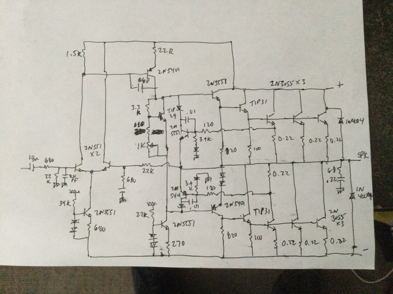

Not even need to simulate 😉 , circuit looks good and has gobs of output current capability.I knew I had it around here somewhere. Drives 2 ohms all day long. Use 18-0-18, 6A transformer. Add a 4th pair of transistors for 1.5 ohms.
25V rail will push 15A maximum/peak into a 1.5 ohm load, so 5 A per power transistor ... well within its capabilties.
Follows the
suggestion which is the classic, solid approach 🙂DIY macho man way: take one classic design, such as one of excellent APEX ones, say it drives 100W into 4 ohm, or the popular Rodd Elliott one, and double (or triple) power transistors , adding individual emitter resistors for even current sharing.
