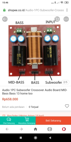

Hi Cal Weldon! This subwoofers are intended as passive add ons with passive 120 Hz crossovers to existing 2 way front L/R speakers. But I'm worried adding another two 4 ohm subwoofers might cause my 6-8 ohm rated amp to overheat.

I have these two 4 ohm 10" subs that I intend to add to the set up. But I'm worried abt the amp not being able to handle the additional load. What is your advise?

Hi! Thanks for your reply. I'm a noob and am just getting into this. I don't know much abt plotting impedance and the technical aspects involved. I just bought these 2 low pass crossovers in an attempt at connecting the passive 4 ohm subs to my front L/R. The amp is a7 channel Denon avr 4308 rated at 140 wpc.
But I've been warned by some people not to do it. A bit confused. What's your suggestion?

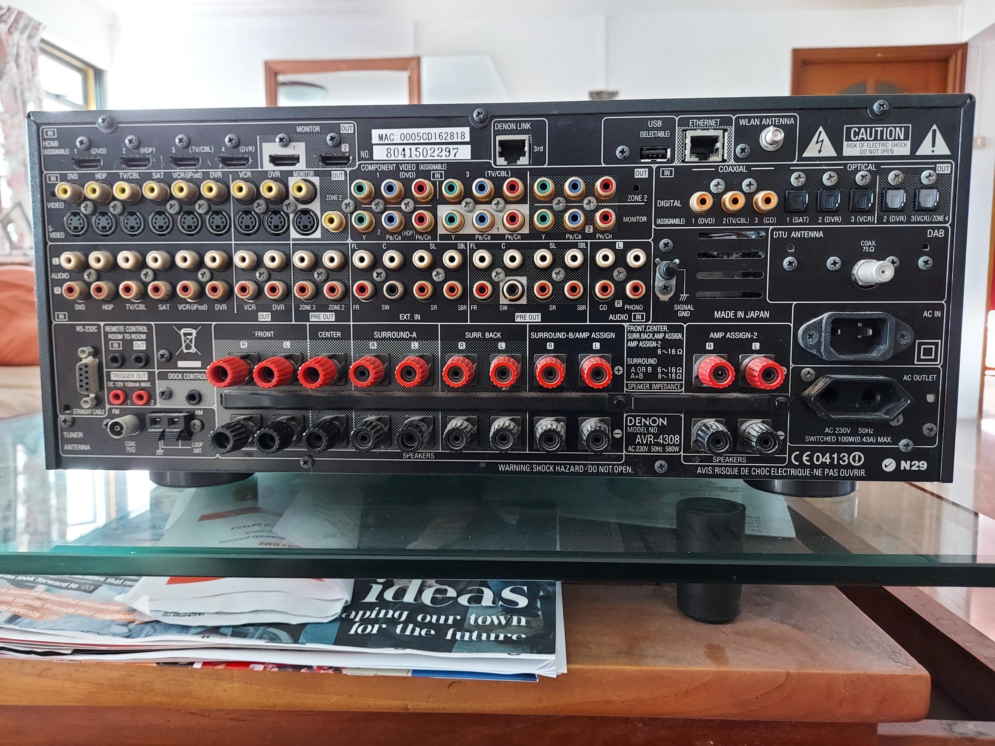

These are the low pass passive crossovers and the back of mu amp

Pls see the low pass filters and the back of my amp in the above pics.

Pls see the above pictures of the subwoofer low pass and the amp for your reference. Tks!
Check your receivers operating manual to see if you can route the sub signals to a pair of unused outputs. I see that the pair on the left of the main group are labelled surround bi amp and there is another channel further to the left labelled Amp Assign 2
The fact that these channels are assignable leads me to believe that you can do that from the remote and have the low level signals sent to the assigned channel. You need to take a deep dive into the manual to see what can be done in terms of the routing. It is probably the size of a phone book, but it’s got to be done.
It would be highly preferred to go this route rather than using the passive crossover because the internal crossover likely has steeper slopes and adjustable turnover frequencies, level adjustment etc.

If you have an 8 ohm speaker and you are putting a 4 ohm woofer in parallel with it, you can expect to have trouble when your receiver is only rated at 6 ohms minimum. You would normally calculate the nominal parallel speaker impedance to be (1/ (1/8+1/4))=2.7 ohms. Have you looked a using the Bi amp speaker terminals to give the passive subs their own amplifier channel? This has a much better chance of working without overloading the amplifier.
Download the manual if you don’t have a printed copy and figure out what is possible for those biamp terminals.
