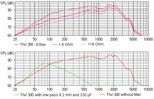

I don't get it how people can see a series resistor as a solution for anything in this application. 🙄 Look at my simulation for a Visaton TIW 300 / 8Ohm with Qts= 0,28 on an open baffle. I added a 8 Ohm resistor and a 16 Ohm resistor to raise Qts. What you get is loss all the way (upper diagram).
A second order filter (in this case designed for a upper limit of 150 Hz) would be much more effective and already include a working low pass (lower diagram).

here is an example of the effect of adding a series resistor.
From top down, driver, 4, 8 and 16 ohms series resistance. At the bottom is the driver impedance.
Hello John,
some questions WRT your example diagram above:
- Do you show the driver on infinite baffle or in an OB application?
- Are the SPL levels normalised to some 0 dB level or do they show the effective SPL difference between the different resistances?
- What Qts value did you apply for the red curve?
Rudolf
Rudolf

Hi Rudolf,
It was an IB simulation. SPL is that showing effect of resistor on actually SPL. Notice at high frequency where Z is very high due to Le, and around fs (=34 Hz) where the driver Z = 50 Ohms, there is little change in SPL. Here is the same driver centered on a 80 cm x 80 cm baffle in dipole mode. As seen the series resistor is not very effective for eq.
Driver Fs = 34 Hz, Qts = 0.51 The other point I would make is that whether a series resistor or passive low pass filter is used to "eq" the dipole response there is a lot of amplifier headroom wasted in the eq. Using active eq eliminates this waste of headroom. By head room I mean the required voltage swing to produce the desired SPL output.
With passive eq the amp put out constant voltage vs frequency and then the passive eq reduces the voltage applied to the driver as the frequency rises. With active eq, only the voltage required to produce the necessary SPL output to the driver be the amp.
