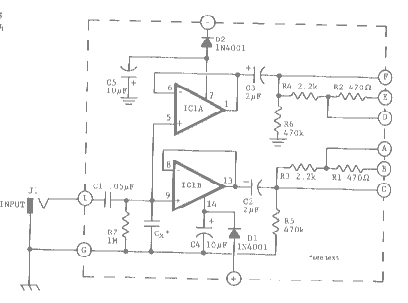

I have a DIY for guitarists book where they have designed a "spluffer" (splitter / buffer) the idea being to split and buffer a guitar signal into two so that you can drive two amps, or effects pedals etc. I have designed a board for it but doubled it so that I get four outputs for my son's PA system, but have not got around to building it.
I can send the schematic and board if you want.
The board was designed on "Eagle Lite" but if you want I can convert to a GIF or something.
Dieterd
Dieterd

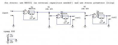

Hi, I've finished my exams with success, so I'm back on the road...
I was thinking of something I've publiced here. I'm quite sure it will work, but I've still a doubt: will there be a bigger influence of distortion at the input because of the high impedance of the opamp (is an extra parallel resistor needed here?)

Congratulations on finishing your exams with success!
A couple of suggestions: You should have an input resistor to ground to keep the first op-amp's input at zero if there's nothing connected. You should probably have an input capacitor unless you can guarantee that your source will always have no DC offset. And don't forget to bypass the opamp's power supply pins.

Thanks PaulB!!!
Indeed, you're right, I will place a 10k (or 4k7) input resistor to avoid/reduce distortion. There's no extra capacitor needed because the source (a quality mixer) is DC-protected.
After building this design, I will build a own designed amp that I will publish soon here; I've had bad experiences with other designs on the net so I just decided to do it myself. At school everything runs fine by now, especially on designing amp's (thanks to this forum).
