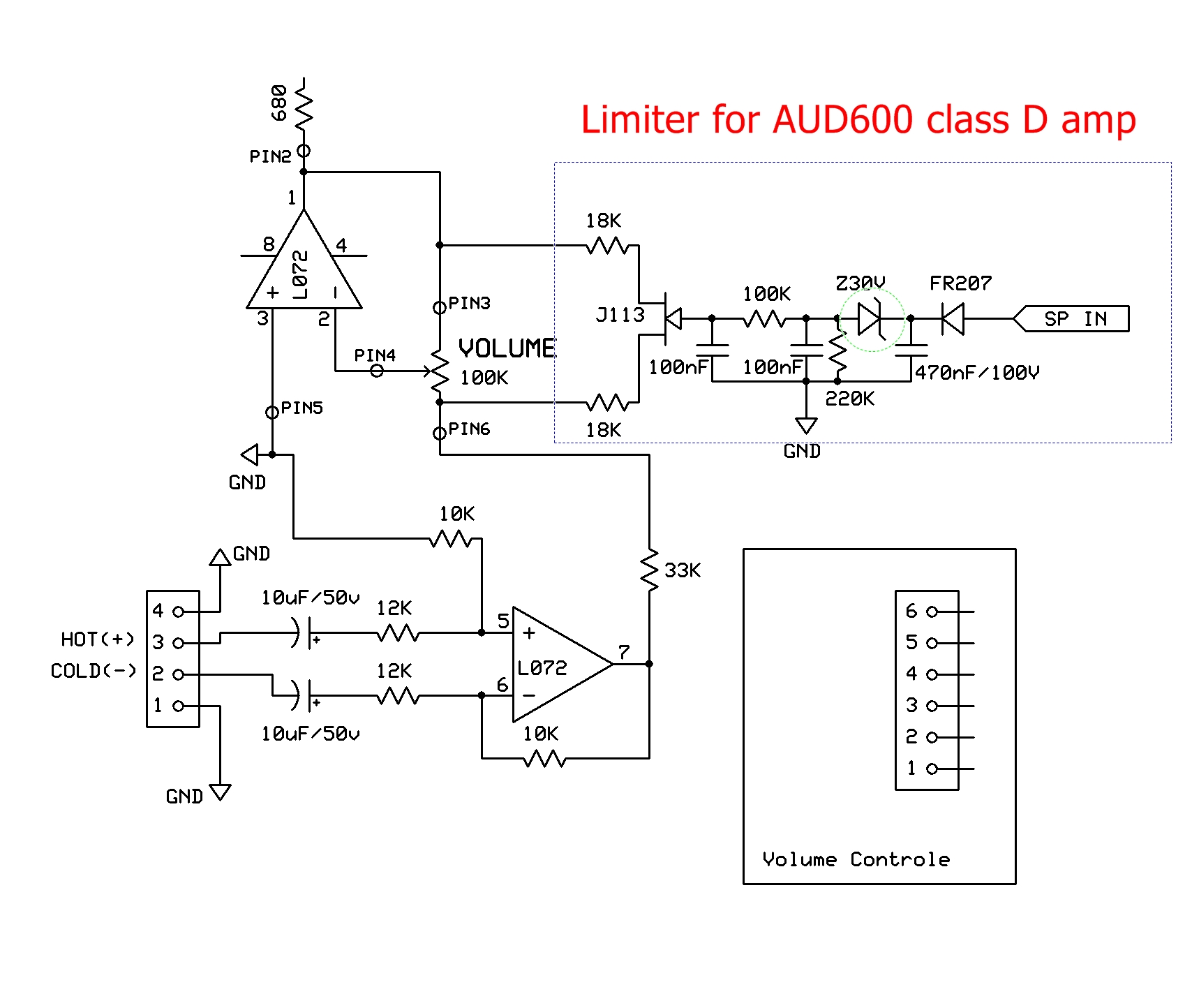

Im using manoj limiter for UCD Class D amp
look atachment
my problem is, signal come from DSP ang go into manoj limiter, but DSP have only small signal, not enough to get full output power from UCD amp
I want increase gain and have change Op amp PIN6 / PIN7 from 10K to 15 K and PIN 5 / PIN 6 from 12K to 1K but thats not enough.
I need about 30% more gain , what can I do ?
IF I change resistor PIN6 / PIN7 to 33K, can this help to get excessive gain ?
