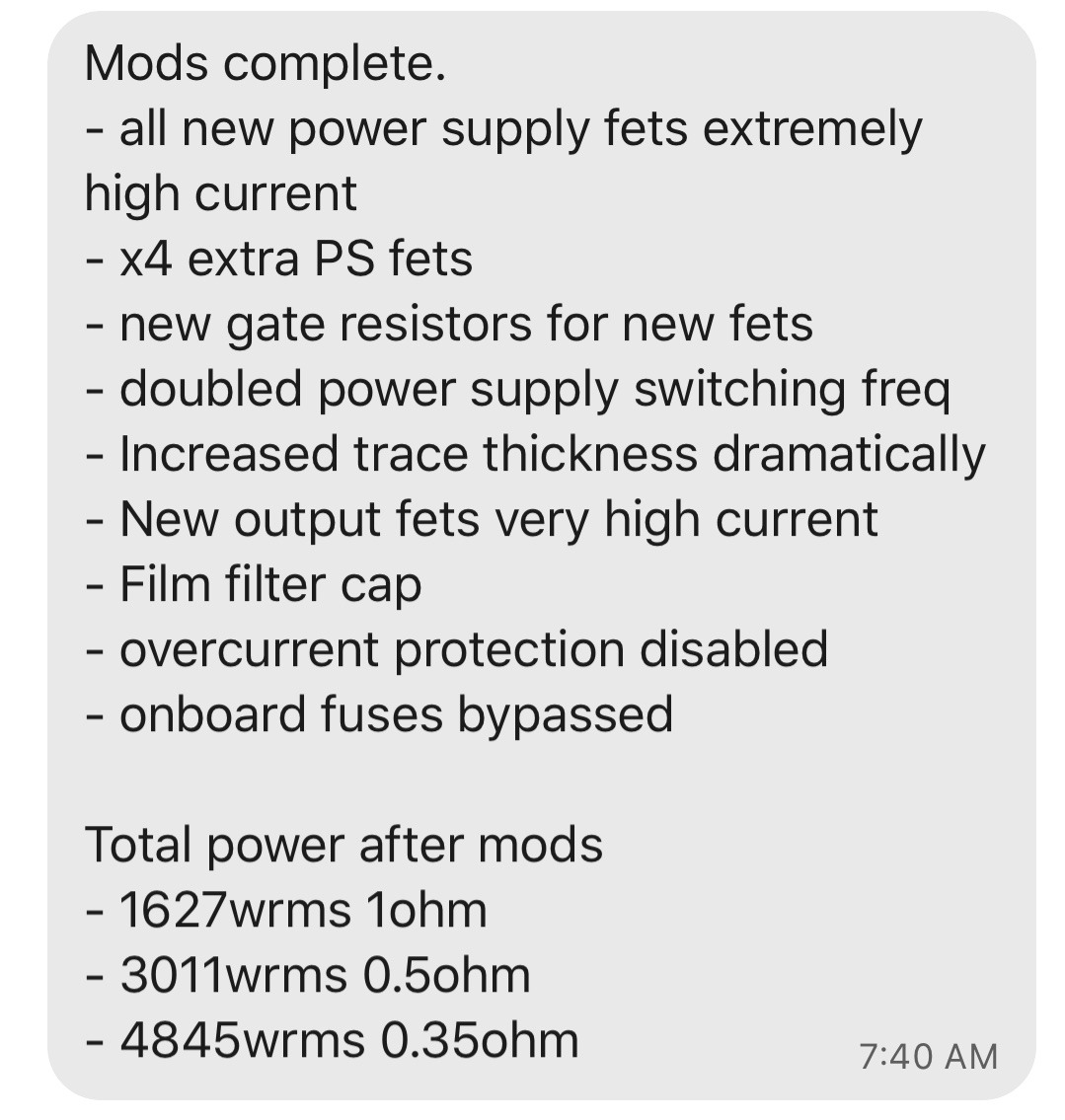

I sent Sam a cheap Chinese amp I got off eBay, just to see what it would do with some mods. Stock specs on it were 1250w@1 ohm, when I got it back it dyno’d as follows in the below screenshot. YMMV, but obviously there are things that can be done to increase the current handling.
Wow bro, that’s amazing. From the looks of it to a layman it’s basically redesigning the amp but just the fact it can be done and you gained that much more output ...just wow. Thx for the post, really appreciate your reply with the pic, etc. still learning all this and obviously I have some far fetched and random questions, as all newbs do lol. If it weren’t meant to be done there wouldn’t be ppl who do it and get the job done right 😉Only one way to find out...

There is so much wrong with this thread I don´t even know where to start.
I´ll try anyway.
They must always do that.
Do they stand more than bare minimum? ... GOOD!!!
2) "stable" is a nonsense catchword/"spec" way misused by car amp "designers" or at least marketers.
Stable means it does not oscillate with load applied, either continuously or in bursts at some point of the waveform, period.
Marketers state, say: "amp puts out 500W into 2 ohm, and is 1 ohm stable" , letting unsophisticated end users "think" : "oh! it can drive 1 ohm loads!!!"
No, it does not mean that (if they stated so clearly they could be proven wrong) , simply "it does not oscillate if loaded with 1 ohm", a completely different thing. And much easier to achieve.
As relevant as stating "cat safe into 1 ohm loads" meaning your cat won´t die if doing so ... so what?
IF it did, Youtuber would show amp oscillating into a 1 ohm load, then curing that problem by using different Mosfets.
He does none of that.
If so, please show it.
Specially scope screen captures,details on the load you use and amp schematic.
Could go on and on, but the above is more than enough to show the flaws in following an obscure YT video as the Revealed Truth ... it´s not.
I suggest IF you are repairing an amp, return it to Factory specs; you don´t have enough data available to "improve" it.

To begin with, all we have is the Modder´s word for it.
Did he increase MosFet specs?
Change some resistors and caps?
Probably.
Did he turn a 1250W amp (which is already suspect, being as described a "cheap chinese amp off EBay" , not my words but as described) into a 5kW fire breathing monster?
May I very very very much doubt it?
If anything: what was he feeding it with?
A super bank of 24 truck sized batteries in parallel?
Through arm thick wires?

overcurrent protection disabled
fuses bypassed
I THINK, higher voltage fets would have higher gate capacitance, so the gate resistor and who knows hoe many places ne needs to reccover the stability and it matters which methods are being used. Dominant pole? Miller? 2-pole Miller? Output Miller?
.5 Ohm load? WHAT?
.5 Ohm load? WHAT?
I have not been shown any instability, so ..... why try to solve a non existing problem?
Image claims 0.35 ohm load 😵
.5 Ohm load? WHAT?

Words you can doubt, SMD’s amp dyno results not so much. I trust those numbers, to see one in action you only need to watch a few of Williston (Derek’s) videos on YouTube, which again I assumed was common knowledge- maybe it isn’t.
what was he feeding it with, a super bank of 24 truck sized batteries in parallel through arm thick wires?
I believe he has a pair of mega ampere computer power supplies, probably something out of a mainframe. Doesn’t matter where you get the power from, the amp doesn’t care what’s feeding it so long as it’s well fed. It literally doesn’t know the difference between a battery bank or an engine driven alternator(s), as long as the input voltage doesn’t drop appreciably under heavy load all will be well.
As an extra note, I doubt the sanity of anybody who states:
fuses bypassed
Crazy was sort of the point with this project, and no I wouldn’t recommend people doing this in general. The point was to see what the average cheap Chinese half bridge can do when given a true chance on some good parts along with some common sense circuit changes.
It turns out you can get quite a lot, if you know what you’re doing.
Side note- I’m actually inclined to trust the numbers in the manual, given the parts originally used and the general layout of the board. Even though it did say ‘4000w’ on the box, there’s no reason I can think of that it wouldn’t do 1200w to a 1 ohm load in stock form.
Disabling OC protection is a requirement here, since it’s being asked to drive loads less than half the original impedance. Recalibrating it to work at the ‘new’ minimum impedance could have been done, but in the context of what I was going for it wasn’t necessary.
Same thing with bypassing the built in fuses- when you ask an amplifier to deal with more than twice it’s original current carrying capability, the original protection devices will no longer be adequate. Therefore you jump them out and use an outboard fuse instead.
