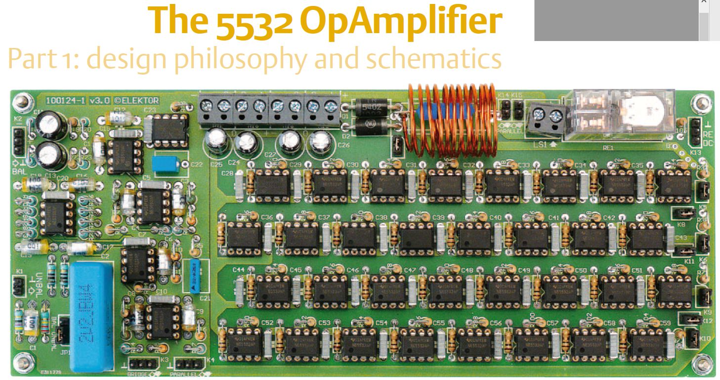

Hola!
If the PCBs are according to D. Self's design, you can find all the information about this board here:
https://www.elektormagazine.com/magazine/elektor-201010/19460
The original had 1 PCB per channel for the bank of NE5532 acting as current buffer AND the input balanced/unbalanced voltage gain amplifier. It appears that the PCB on eBay is ONLY the current buffer part, without the voltage gain part, see screen shot below of original amplifier "5532 OpAmplifier". Good luck! Here is a link to the article by Douglas Self:
https://www.physicsforums.com/attachments/douglas_self_elektor_amp5532_compressed-pdf.254881/
In short, the PCB on eBay has gain +1 (and -1 for the balanced half) and appears to be only the bridge-tied balanced current buffer.
--Christian
