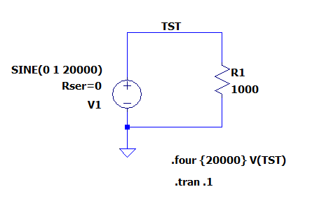

I am testing the THD at the output of a pure sine wave voltage source and am getting the following result, but I expected 0% THD.
Can anybody tell me why I get this result?
Thank you in advance for your insights!

I am answering my own question, I found that setting the "Maximum Timestep" in the transient analysis directive solved the problem, here is the entire directive that gives good results now:
.tran 0 .01 0 1E-7

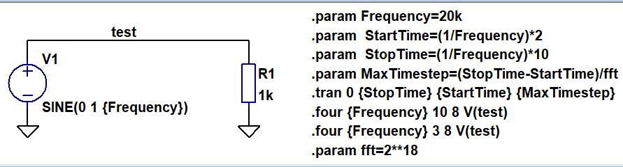

In your second post, the distortion goes down to 0.108709%(0.118400%)
Here is a way to get it down to 0.000306%(0.000000%):
View attachment Test.asc
You can trade off accuracy with speed of simulation. For example, if .param fff=2**20, THD=0.000001%(0.008777%), but the simulation takes longer to run. With more complicated circuits this does become an issue.
Have fun.

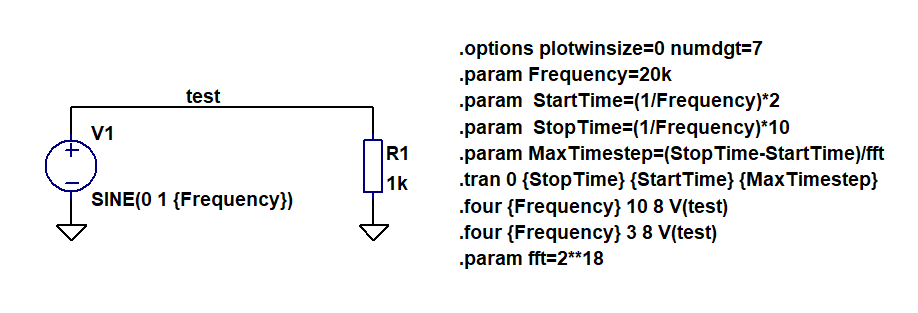

I forgot to disable compression and force LTspice to use double precision with .options plotwinsize=0 numdgt=7.
Here's a version showing distortion THD=0.000000%(0.000000%)
View attachment Test2.asc
