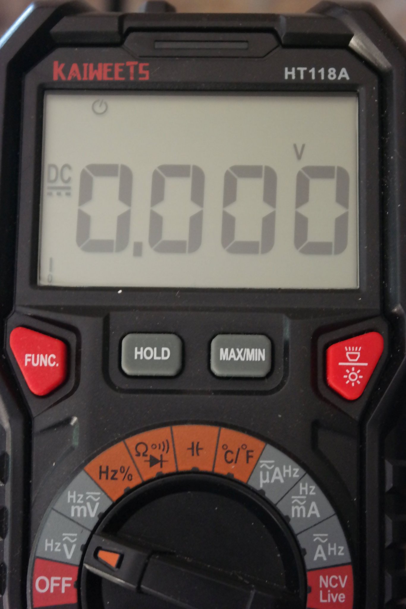

vcc+ and vee- meter setting as shown also across the capsYou measured exactly what, from what point to what other point, with what setting on your meter?
So? No 69VDC there. But if you really do have it, there are two possible reasons: you have a shorted turn in the primary, or you have the voltage selector set wrong. The latter is very much more likely.
the pic was to show the setting of the meter and the voltage selector was removed some years backSo? No 69VDC there. But if you really do have it, there are two possible reasons: you have a shorted turn in the primary, or you have the voltage selector set wrong. The latter is very much more likely.

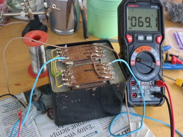

The tx is out of the amp at the moment but this is it roughly connected up, I did connect a cap 22000uh 63v briefly and the meter showed 95v before the cap blewStill not too sure about your measurements,which vary from post to post.

You answered the second question, but not the first.
OUCH!!!!!!
There is some GROSS mismatch there, VERY DANGEROUS!!!
Such a big capacitor,can and will explode like a grenade, straight in your face.
You were lucky you didn´t get hurt.
At least I HOPE you didn´t. 😱
Clearly you connected it wrong: 70VAC into a bridge (which means rectified 100V peak) into a single 63V cap.
1) do not plug anything into Mains until this mystery is solved.
2) build a current limiting bulb setup,with a 40 to 60W tungsten filament bulb as limiter.
Real glowing wire inside a bulb type, no LED, CFL, etc.
You can still buy them as "high efficiency ones", an olive sized quartz halogen bulb inside a larger old style glass one.
Please draw what you built, plus a picture.
