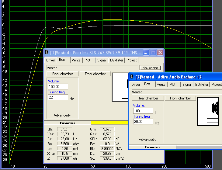

I have a nasty 30 Hz room mode since my room is more or less perfect square
But how did you come up with that SLS ?!? Looks way too good to be true !!! It costs only 70 euros and compares very nicely even with adire audio brahma 😎
I haven't any experience with subwoofer designing so I've probably misunderstood the simulation results...
Wouldn't infinite baffle require much more space than 150 liters?
I'd go for the XXLS 830847 in 150 l box tuned to ~20 Hz. But you've probably thought of this allready.
SLS does not allow the killer excursions of a brahma.
SLS can go around 15mm, while Brahma is dealing with up to 27mm.
I guess Brahma can deliver about 5db more pressure at low frequencies.
But of course, the costs....

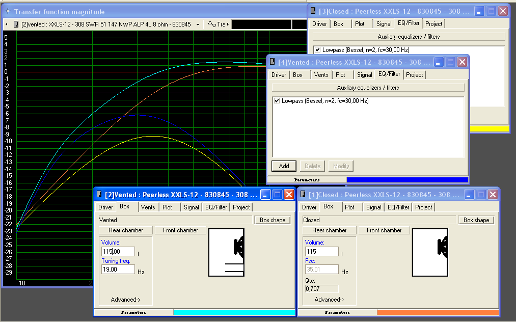

I've allready given up with SLS since it seems to be quite lousy driver. I've been playing with XXLS drivers for this evening. They seem to work well both vented and closed box. XXLS 830845 costs 199 euros and seems to be rather nice driver.

My view of vented vs closed box.
Vented is fine as long as you do not apply signal below the tuning frequency. Far below that the acoustic output will drop by 24db/oct,
and excursion is rapidly increasing without making sound but damaging the driver. So even with EQ you cannot go below 15-20Hz in most designs, without endangering the driver. Your programm looks like Win ISD Pro, you could have look to the cone excursion vs. frequency, before you decide about the design.
Closed box typically needs EQ already starting from higher frequencies.
Below their resonance frequency they end up at -12db/oct and luckily the cone excursion always shows a reasonable match to the acoustic output. With EQ (or better a proper Linkwitz Transform) you can go for any frequency, even in small designs.
But size is not your concern, as I understood.
How do you guys feel about Peerless XXLS drivers. Are they worth the money in this kind of application?
The Win ISD Pro simulations look good. According to them I could build a vented enclosure and plug the hole if needed.
Which one would you build: 3 cubic foot box with XXLS or 1 cubic foot with XLS+passive?
I'll post excursion plots later 🙂
