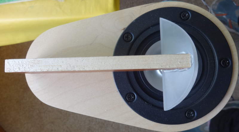

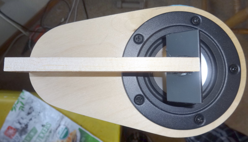

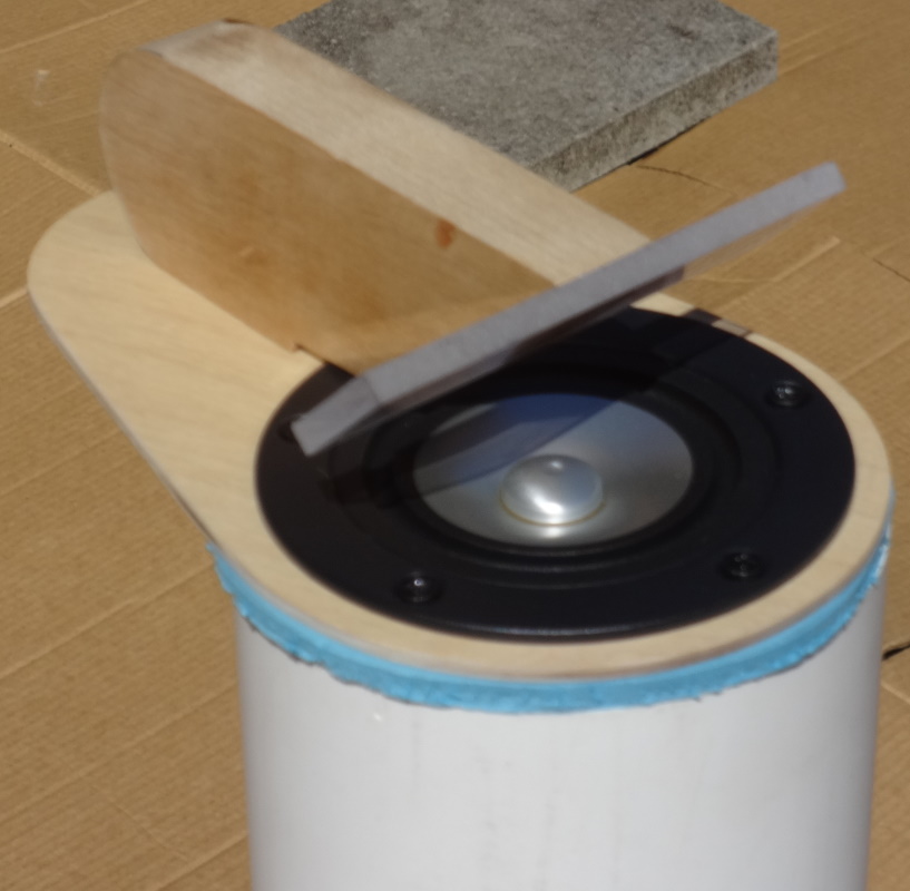

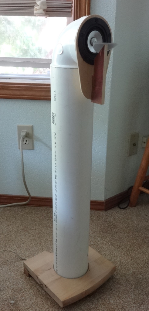

V1 Reflector
Generated a design to start off, basically a 1" wide piece of plexi at a 45 deg angle. I made the holder attach so you could slide it to various positions over the speaker cone.

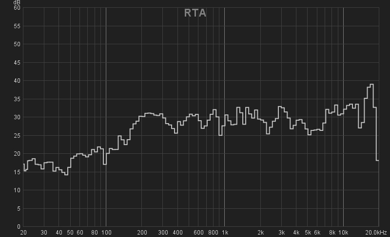

Measuring outdoors, 90 degrees off axis; 1st spectrum is with no reflector, second with the reflector covering just the rear half of the cone, third with the reflector structure covering most of the cone.
It was a very nice day and the single engine aircraft were out flying circles over my house, to help with my measurements.
I get the feeling that to completely eliminate the dip at 5kHz, the reflector will have to intercept all of the speaker cone area. Which takes the upfiring effects of this speaker design with it.
Looks like I'll need an acoustically semi-transparent reflector, to allow some of the sound to radiate on axis, some at 90 degrees. I have some perforated steel from the tweeter covers to a pair of radio shack linaeum speakers I salvaged...

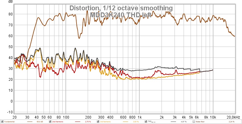

That's very nice. It looks like it's upside down; my mind wants the Karlson curve part to be sticking up! Ah well, such is acoustics...what works acoustically is never the prettiest visually.
How many tries did it take you to get the triple K profiles to make that FR?

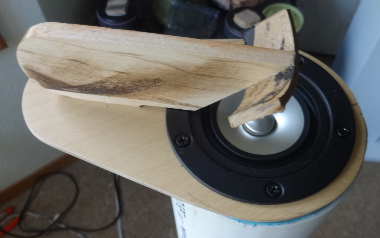

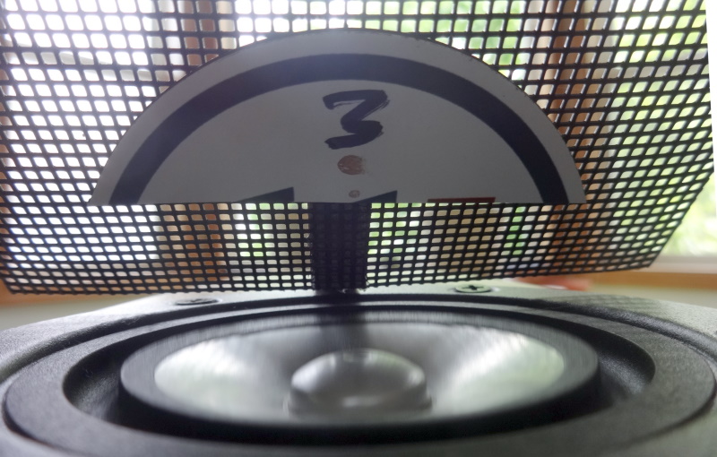

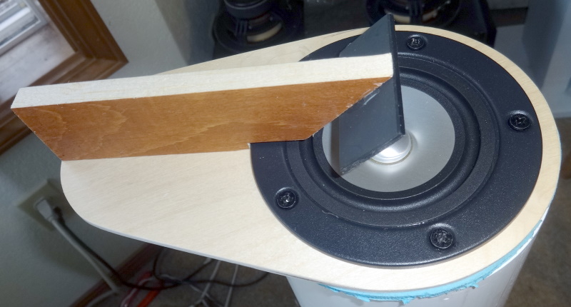

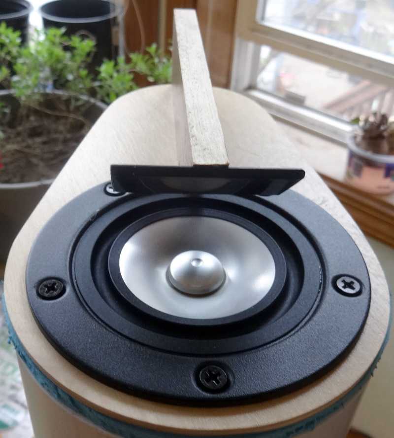

V2

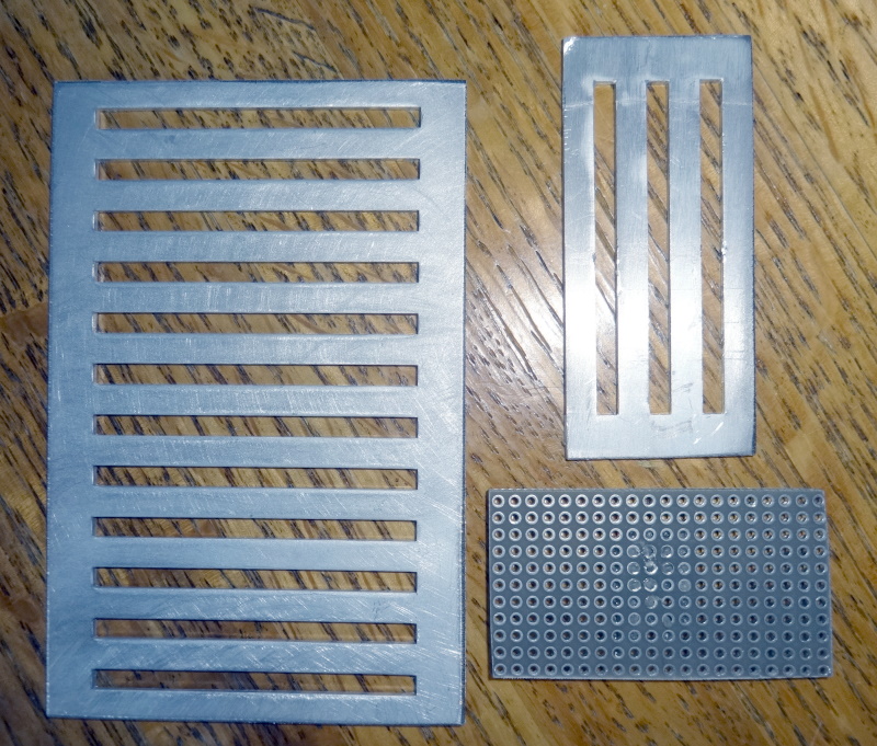

So I tried a few shots at a semi-transparent vane and none worked; even a piece of FR4 with PTHs drilled on a 1/10" matrix. It wants the reflector to be solid...
So to allow some of the sound to escape deflection and radiate upwards, my next tack is to make the reflector smaller. Here's what I've come up with - in the rough - and its corresponding 1 meter on_reflector_axis FR.
Since a metal mesh screen doesnt do a damn as a reflector, it can serve as a substrate for experimenting with different reflector shapes - provided those shapes cane be cut from a sticky back material - even a paper label.
I realize a bank-shot off a solid surface may not work out as well as a diffraction based device, such as a Karlson rocket or the profile claudiogan is suggesting. I'm open.
One of my design goals, if it's possible to achieve, is less of a "plumbing" appearance for the vertical tube speaker. So no caps, sleeves, 90 deg joints or rubber couplers with shiny hose clamps. Monolithic. Claudiogan's triple K tube has more potential for that than what I'm doing. I certainly wish the castle ends could stick up. And I have no idea where to even begin, except to grab a piece of tube and start cutting 'n measuring.

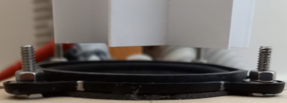

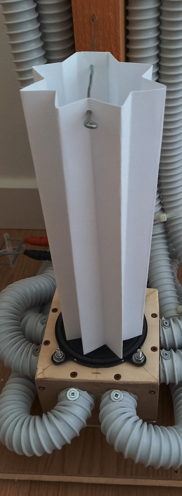

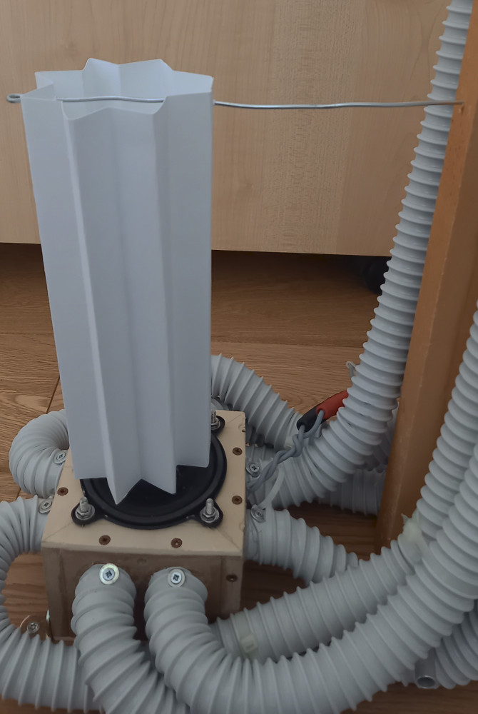

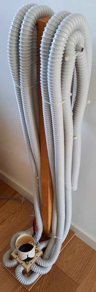

The first attempt I made with four K profiles and the closed side of the tube fixed to the driver. The closed bottom edge reinforces the frequency f = c / (Lmax * 4).
In the second attempt I moved the closed side up and the resonance disappeared.
In the third attempt I reduced the apertures from four to three, with the manual cut I always had a shorter tip than the others that did not touch the driver.
I think the two diffraction zones don't affect the frequency response.
The 20 mm thick upper closed loop has the purpose of reinforcing the frequency f = 341 / (2 * 20) * 10 ^ 3 = 8.5 KHz. It must be positioned at a height that allows to intercept the wave fronts of the frequencies to be reinforced. If reduced to less than 10 mm it should become neutral with respect to the frequencies emitted by the driver.
With such a low number of tests it is unlikely that my measurements are optimal for the 3FE25 driver. I don't know when I will do more tests.

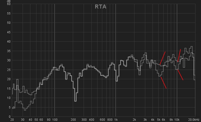

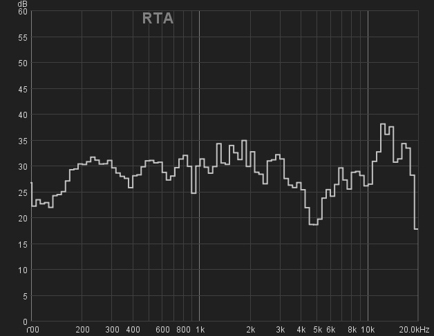

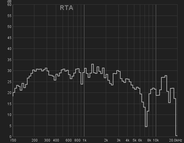

You did not explain how to get the last freq. resp curve rather flat very different from the 1st two. Are the curves' responses change with respect to the angles of the reflector?
Explain please. Thks.

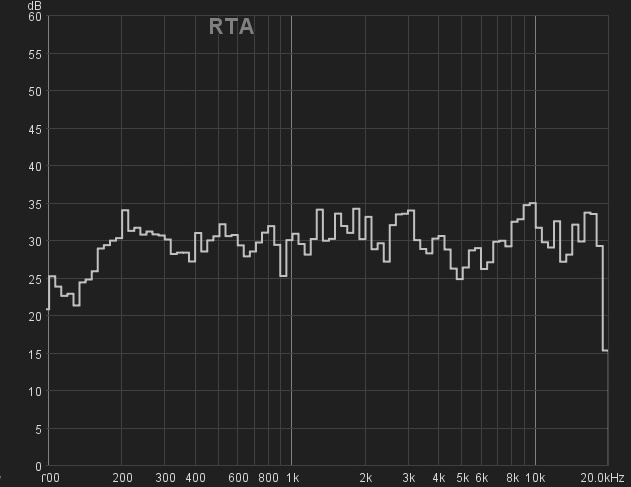

Sure! First, I placed the speaker outdoors in a generous space and drove it with pink noise (recorded on a mp3 file on a micro SD card which a small, mono class d amp plays automatically)
Second, I placed my Apex 220 measurement mic about a meter distant and 90 deg to the axis of the speaker driver, which is facing "up", at the end of a 1 meter, 4.5 inch PVC tube.
The first spectrum is what I get from this arrangement.
Next, I add a reflector, which attempts to ricochet some of the sound towards the microphone, off of a 45 degree angle. I placed it in a position that covered about 1/2 of the cone - and sounded good to me when listening.
The second spectrum is what I got from this arrangement.
Finally, I moved the reflector forward (toward the mic) so it's fully centered over the driver cone. The third spectrum is what I got from this arrangement.

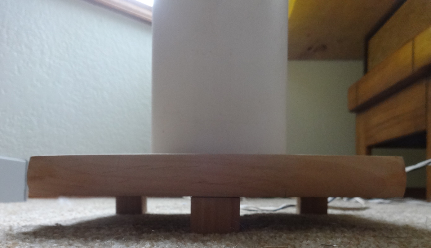

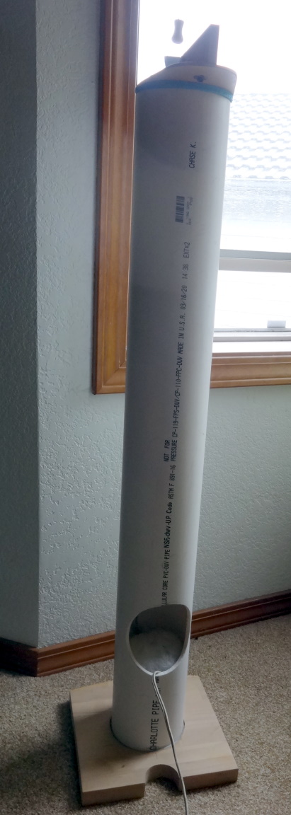

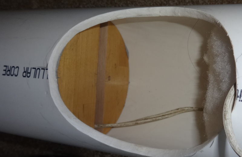

I turned them into MLTLs, by placing a 100 X 10mm slot port at a 25" length and cutting an exit for the port radiation to easily escape. (Thanks to a design by Scott Moose for the CHN-50 inspiring me!)

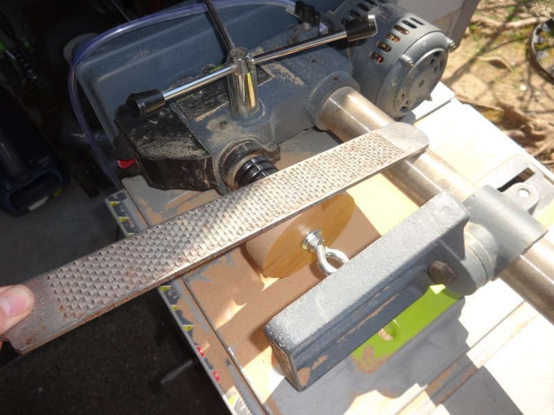

Dont have a wood lathe, but I do have a drill press and a big file. I was able to turn out a couple of 24mm wood pucks which I cut in half, then trimmed to make the port height. Glued in place.
Sweeping with my function generator, seems to have worked out pretty well. They have bass now. I'm seriously considering reducing them to appx 25" tall and having the port exit underneath the base, which will have to be spaced up off the carpet floor with feet.
I have them very lightly stuffed (~2.5 oz) with a "basket" keeping the stuffing up off and away from the port, about 2/3 length for the stuffing.
Up top there's a range of experiments to still do. A curved reflector. A different angle, say 60 deg (after reducing the height). A diffraction based lens. Even a 90 deg coupler (giving up on the upward facing driver) is still possible here.
The fun continues!

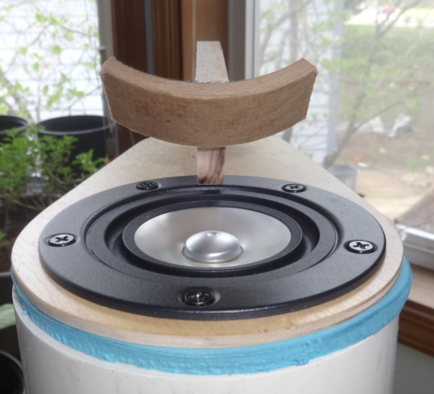

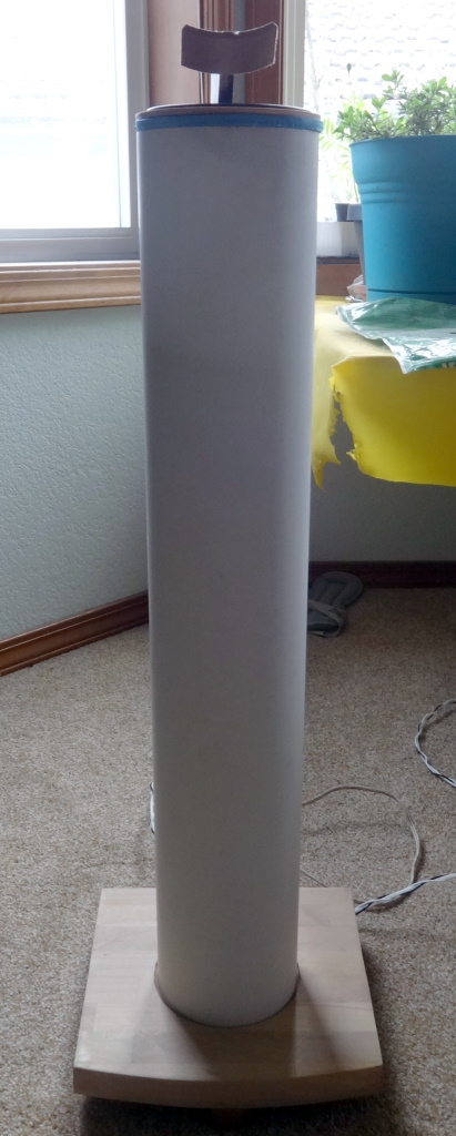

Update
I shortened them to about 27" and arranged for the slot port to fire against the carpet exiting under the stands, which are raised on a triangle of 1" wood blocks. Trying to get the music to 'float above' the pipe ends with respect to two bedroom listening positions.
I also experimented with a curved reflector, which is just a hunk of old BR cardboard tube I had saved. FR (measured in the room) is different than the rectangular reflector and the upper mid dip persists. That's going to take some more design iterations to solve...

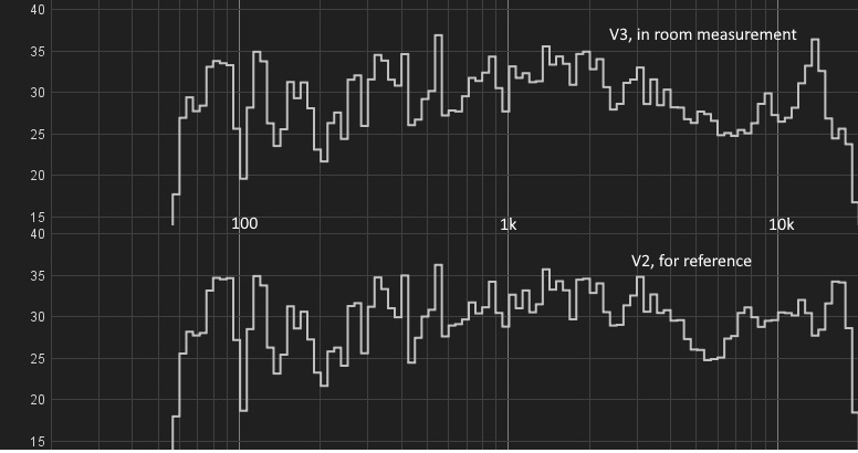

I've continued some empirical experiments using steel mesh (apparently nicely transparent acoustically) to which I can quickly and easily attach shapes cut from magnetic sheet. One particular parabolic shape gave a fairly decent frequency response within the 5 - 10K range, so I went with that to make a pair of more solid reflectors.
Photos show the reflector and corresponding FR for each speaker so equipped.
I'm pretty enamored with the way these throw sound into the gabled window space from a seated position about 15' away. Nice and deep, but not super precise imaging as they do when standing within the near field.

Configuration change
As this is basically a test bed, I had an inspiration from reading about the JBL lenses and how it was perceived they smeared the soundstage. My reflector design - also a lens of sorts - seems to me to have this shortcoming, which is just bothersome enough.
So it came to me that why not have the unmolested part of the speaker radiation facing forward and the reflected - and smeared - part facing up; versus the other way around? So here is that try -
Now it's easy enough to just remove the reflectors - and have an ordinary set of PVC pipe speakers...

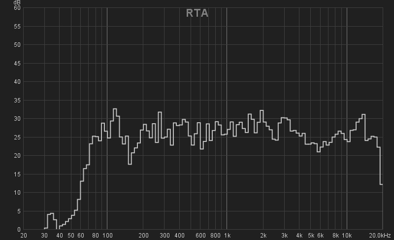

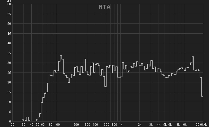

It's a nice summer day this afternoon, so I got around to taking one of these outside to do some measurements; the "up" reflector in place and rotated out of the way. It's not looking good for the reflector, in the only position that makes sense.
It's putting a couple of 5 db drops at 5 and 10 kHz in the forward projected sound, which means I'll probably throw in the towel on this idea - that of putting objects directly in front of a speaker's cone. I still like the up and front firing speaker idea, just probably with two acoustically unhindered speakers is a better way to go.
