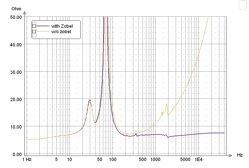

Dear Infinia,
Those calculations are valid, and drastically reduce improve the impedance curve of the load. I have real life measurements of amplifier vs. load to confirm. If you calculate the Zobel with above formula u will see in real life that the impedance plot improve drastically. And u can even go further further with a extra second zobel network which improve things even more.
I design amplifiers for active speakers for many years, as well discrete as with chips in close relationship with the company who design their own drivers, so I have full access to the exact T/S parameters of the units. My above quotation is a simplistic way to calculate a reliable Zobel value for optimum interaction between amplifier and load. Like u can see in the below measurements for an active loudspeaker system in where I designed the amplifiers for, those calculations using above formula are very accurate and does make the loudspeaker unit attached a better load for the amplifier.
The chip manufacture never know the load the amplifier chip will see. And those loads are very variable. That is why I don't believe in a fixed value.
The LM1875 like to oscillate. I played around with those chips many years ago for a commercial product, and I am convinced in real life experience, that the manufacture specified Zobel doesn't always cut the cake.
Ps, attachment below is not a simulation but a measurement of a real existing product.
With kind regards,
Bas
Hi Bas
Your getting confused and mixing things up.
There are Zobels for amps stabilty ie phase margin at HF above audio band, and then there's zobels for speakers at LF, they are not the same thing or application!! A zobel is a generic term really. Its just a frequency selective way of introducing a real resistance and canceling a reactive part.
In these chip amplifier threads we can talk about amp zobels. Please read Kevins reply to you in the thread post #12 and my link again in the other thread a couple of days ago. Thanks

Hi Bas
Dear Infinia,
I am not mixing things up. My point was and still is, you want the amp to be stabile with inductive and/or capacitive components in the load. Many amplifiers start to oscillate when the phase margin change due inductive or capacitive components in the load. If you take the manufactures Zobel network of 1 ohm/220n one can not guarantee that the amplifier is isolated from a highly inductive unknown load.
I have seen a LM1875's literally exploding adding the wrong zobel network (despite the promised protection circuits). When I talk about Zobel network in amplifiers, I mean the Thevin Thiele principe of how to tame a inductive/capacitive load. If your amplifier consist a high bandwidth with minimum compensation this is something u need to consider.
With kind regards,
Bas
Ps. Before I forgot. I took your advice and changed ceramic SMD's for film 1206 SMD caps in a DC servo. I tried the tapping test witht the scope. In both cases there was a case of a micro-phony effect with tapping. However when I change the capacitor for a film through-hole part this effect was reduced big time. So I guess I should not use SMD caps anymore in those critical applications. But strange enough even in very expensive "high end" equipment I have seen those ceramic capacitors in PLL loops 🙁.
